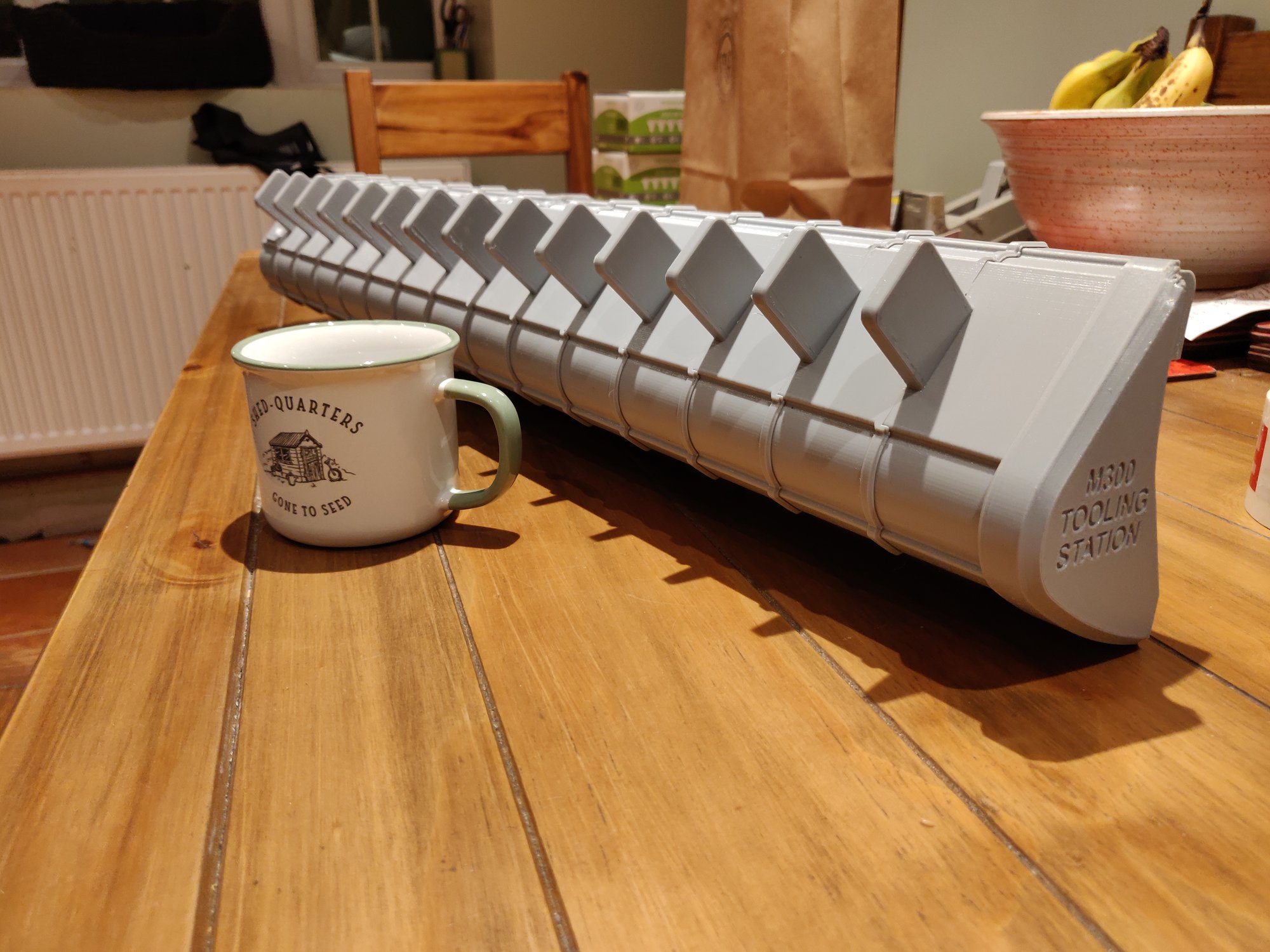

What size are the pegs?Finally got round to completing the Harrison M300 Dickson toolholder rack. It's modular so can be expanded as new tool holders acquired but 14 is enough for now...

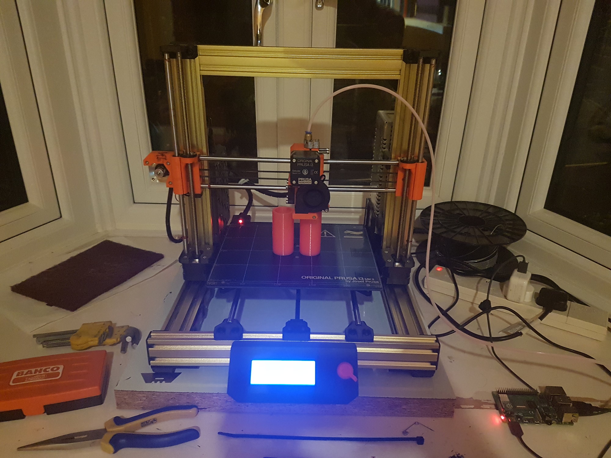

Depends. I'm using a 1mm nozzle and printing 0.3mm layers with 1.2mm extrusion width and 20% infill. Octoprint says my current print will use 36m+ in 3 hours. The actual print time is more like 3h25m. So 330m on a 1kg spool puts me somewhere in the region of 30h. I chewed through a whole kilo of prusa (plasty mladec) PLA just setting up and calibrating the bloody thing lol.
Edit: Print has just completed. 3h21m to do 36.83m. The maths puts me bang on 30h for 330m (1kg).

Approx 6mm thick by 31.5mm sqWhat size are the pegs?
Must measure mine.Approx 6mm thick by 31.5mm sq
