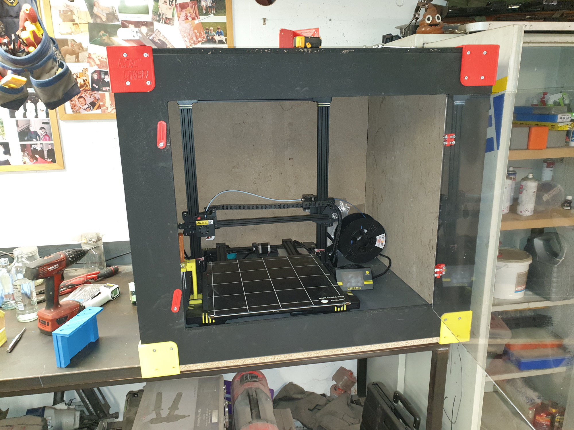

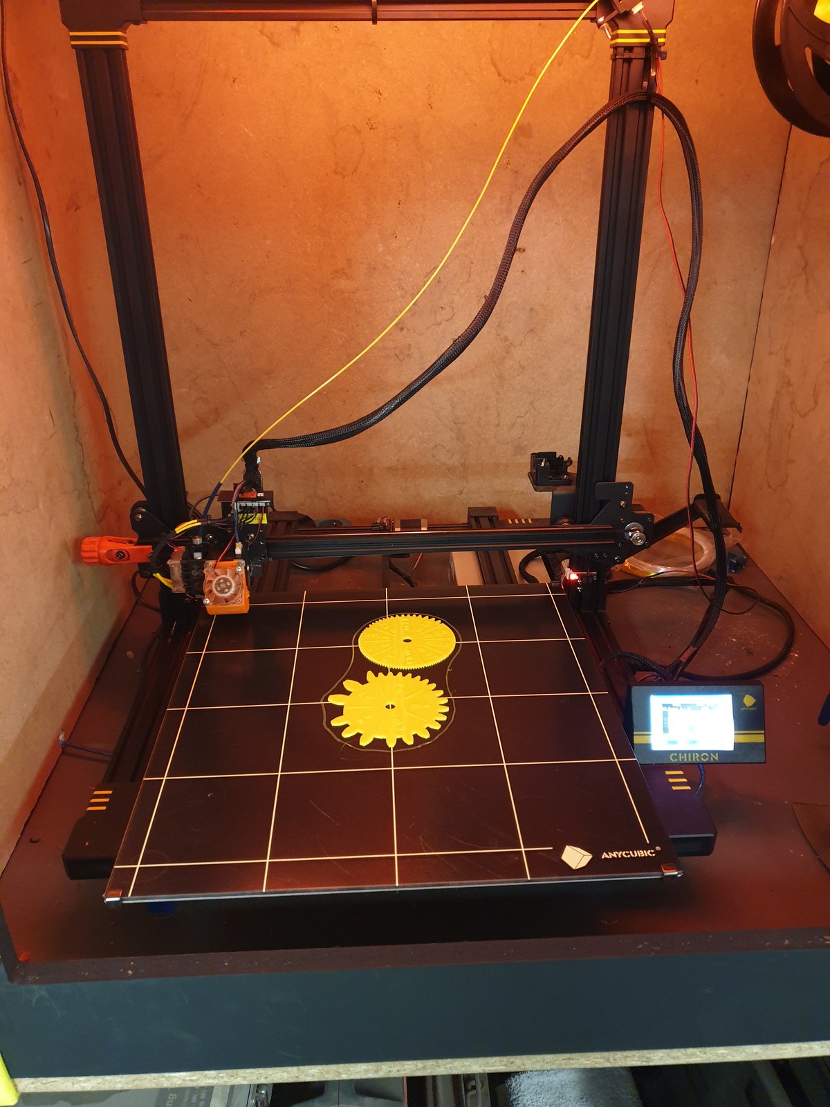

It's easy enough buy a cheap Formica topped table with wooden legs , screw a balanced 1/2 " plywood back on it and put a piped computer fan as the exhaust to the outside of the building at least 30 inches from any opening window or door , enclose the other three sides with 5 mm Perspex that can be slid in & out of pre formed alu grooves screwed to the top 7 bottom of the legs , so you have a three sided viewable enclosure. If you want a belt and braces job screw on a 44 mm thick ply floor to th bottom of the legs .Give everybody a mask?
Fit it up with a fire safety device that also triggers a mains cut out & fills the cabinet with a fire safe extinguishing foam if there is too much heat in the cabinet .
I have made a similar cabinet for my prusa It has two bright LED lights in it , I'll be printing the flanges & nozzles etc.needed to connect up the pond water 2" extraction pipe to a computer fan , in a separate box there will be an old computer PSU for the fan power also screwed on box to remove the fumes from the room .
