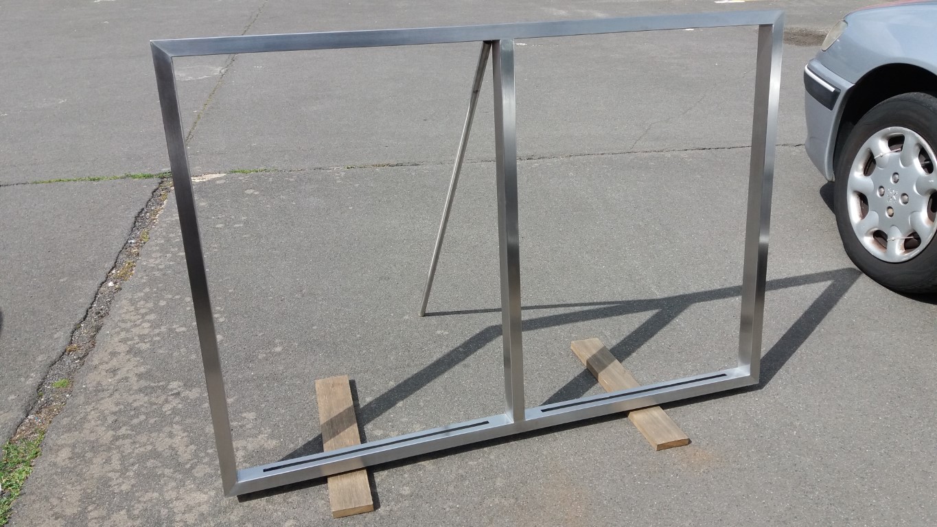

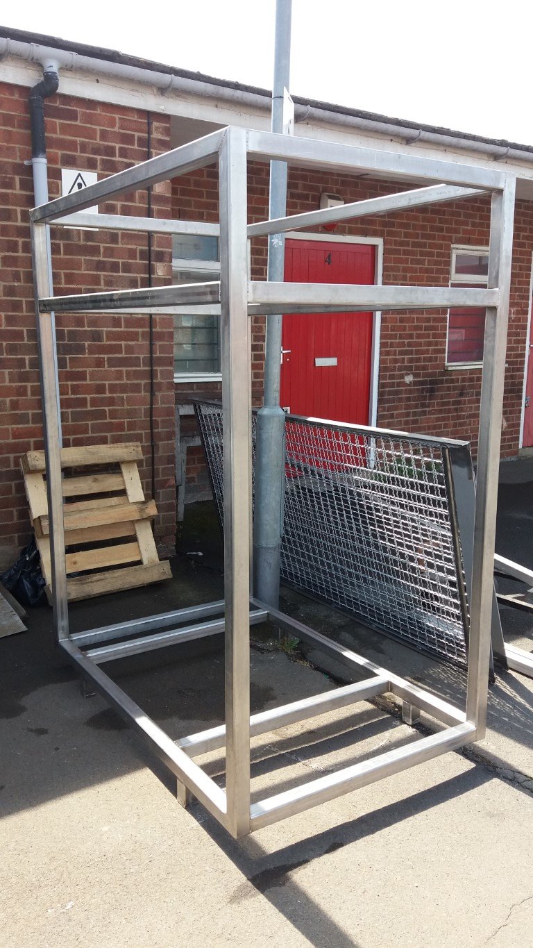

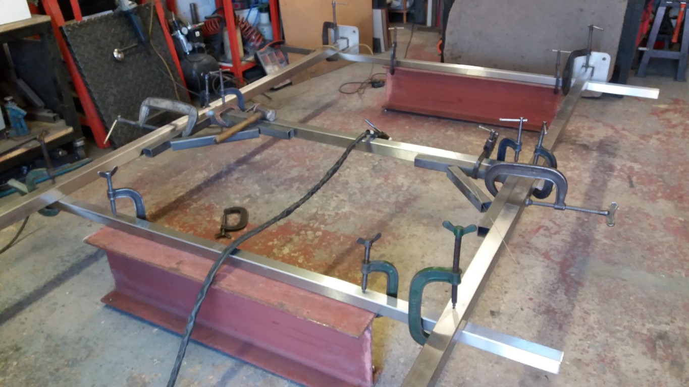

Just shy of £1000, five lengths bought and about 3m left over, wasn't the only shock on the job either, I was sitting astride it to weld one of the corners and hadn't noticed that the return clamp had dropped off, you can guess where the hf tracked, I can now confirm that its possible for a human to perform a vertical take off !!.5mm wall. Few quids worth of material there Paul. Tidy job as always

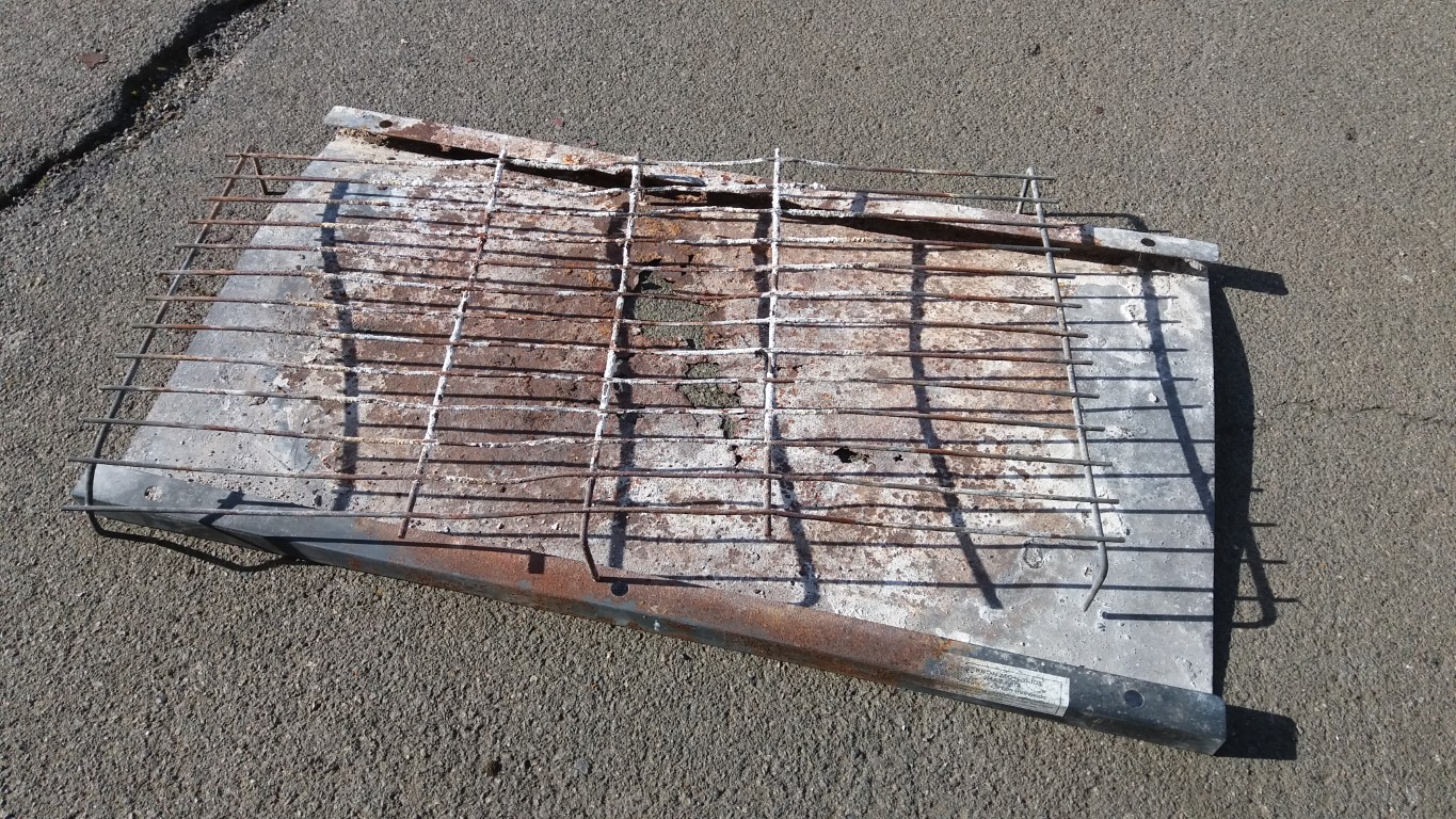

Quick job this morning, bloke comes in and says can you do anything with this?.

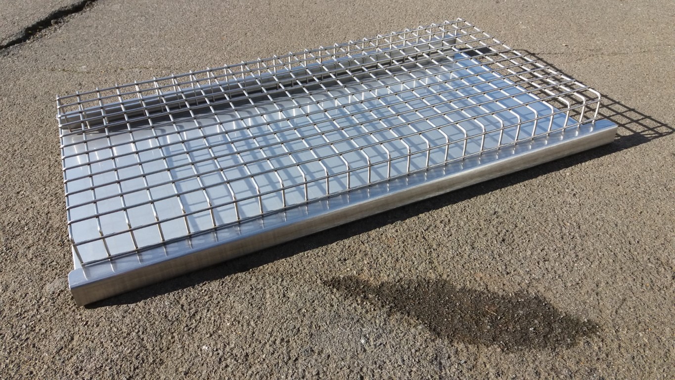

Yes mate I can, hoy it in the skip and I'll make a new un. All stainless of course.
Hi Paul, could you tell me the spec of that wire mesh? About to build a guinea pig hutch of all things and as I'm a bit OCD, I wont be using chicken wire, or cheap mesh. The hutch is getting built in hardwood and will be insulated!

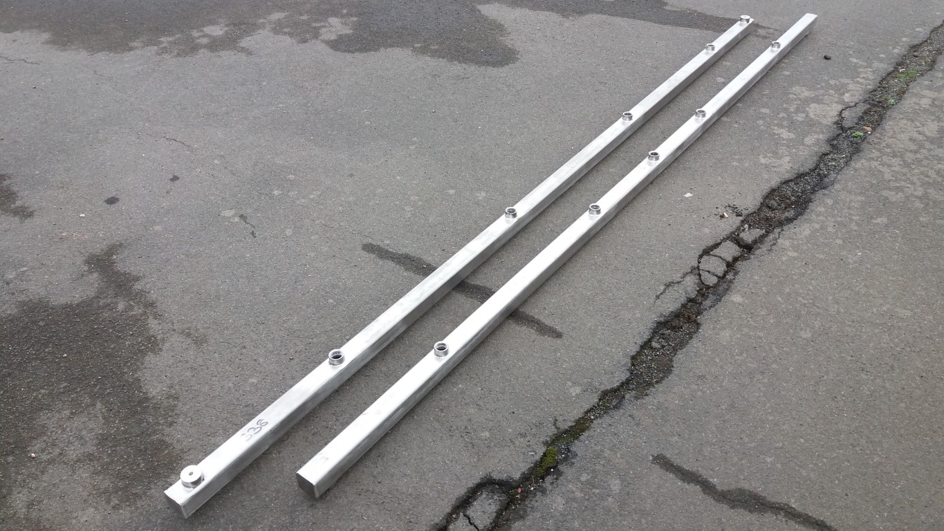

Drilled a hole each end then run a thin cutting disk along it, then file the ends square, the material is 50 x 30 so not much room to stroke a file, one of those jobs that need a bit of patience.Very nice job. How did you cuts the slots?
