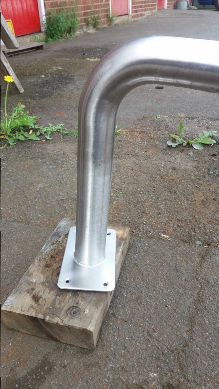

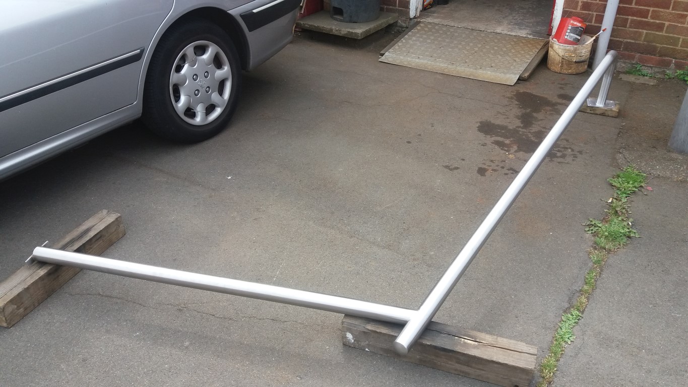

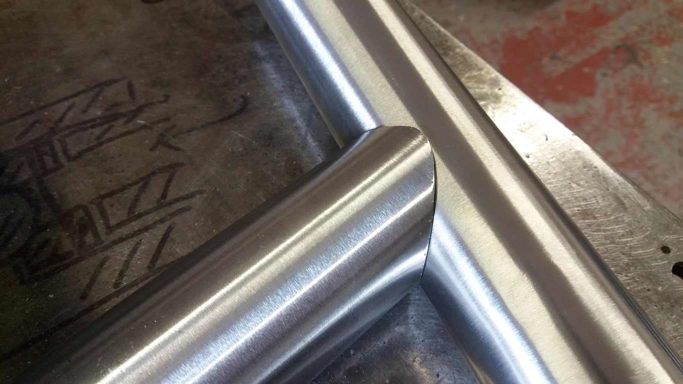

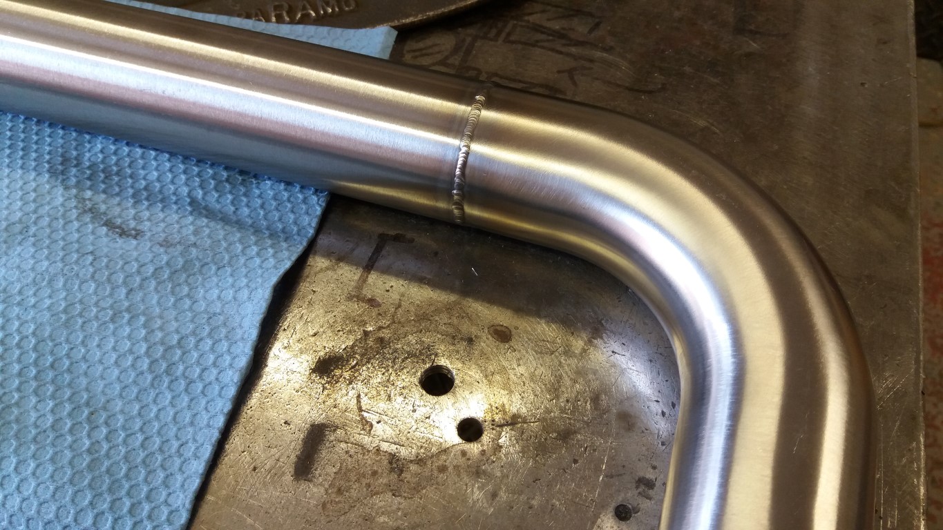

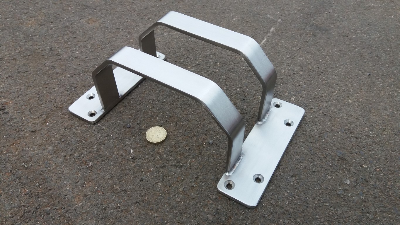

Quick job this morning, a simple guard to fit round a fire alarm point that keeps getting swiped of the wall by people moving stacks of cartons with pallet trucks,

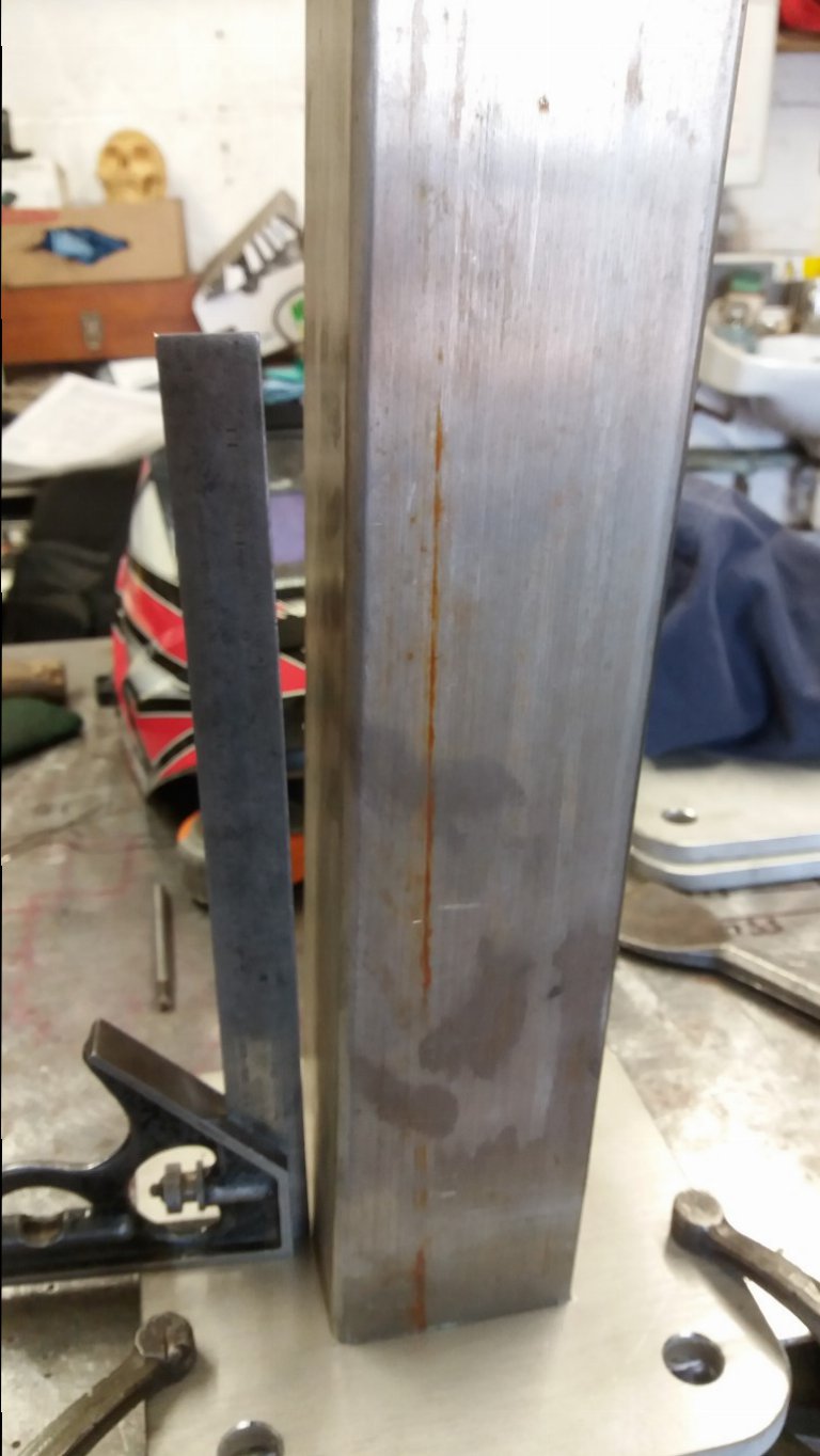

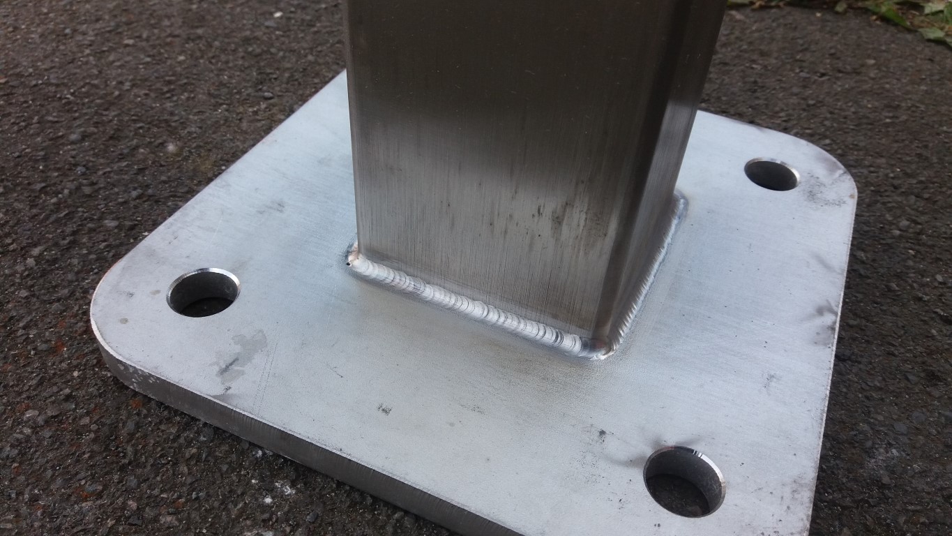

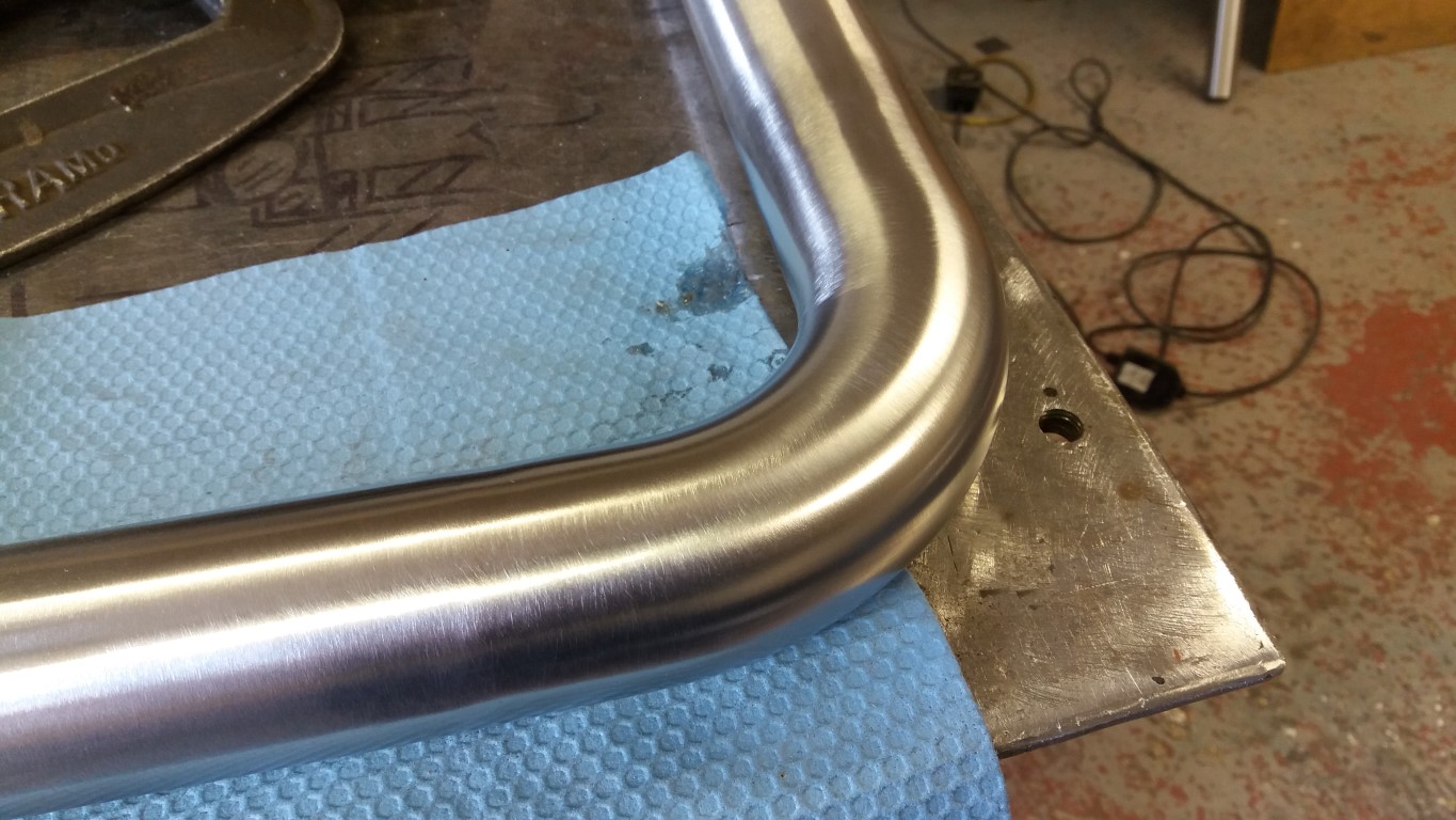

Then assemble a barrier also to protect a machine from pallet truck vandals, for a different customer the material was supplied all cut to size, I'll have to get one of those poundshop squares they must be using, also its a good example of why stainless should be stored separate to mild steel
Worked a bit of magic on it and it came out ok in the end, its over two metres long, and one and a half metres high
