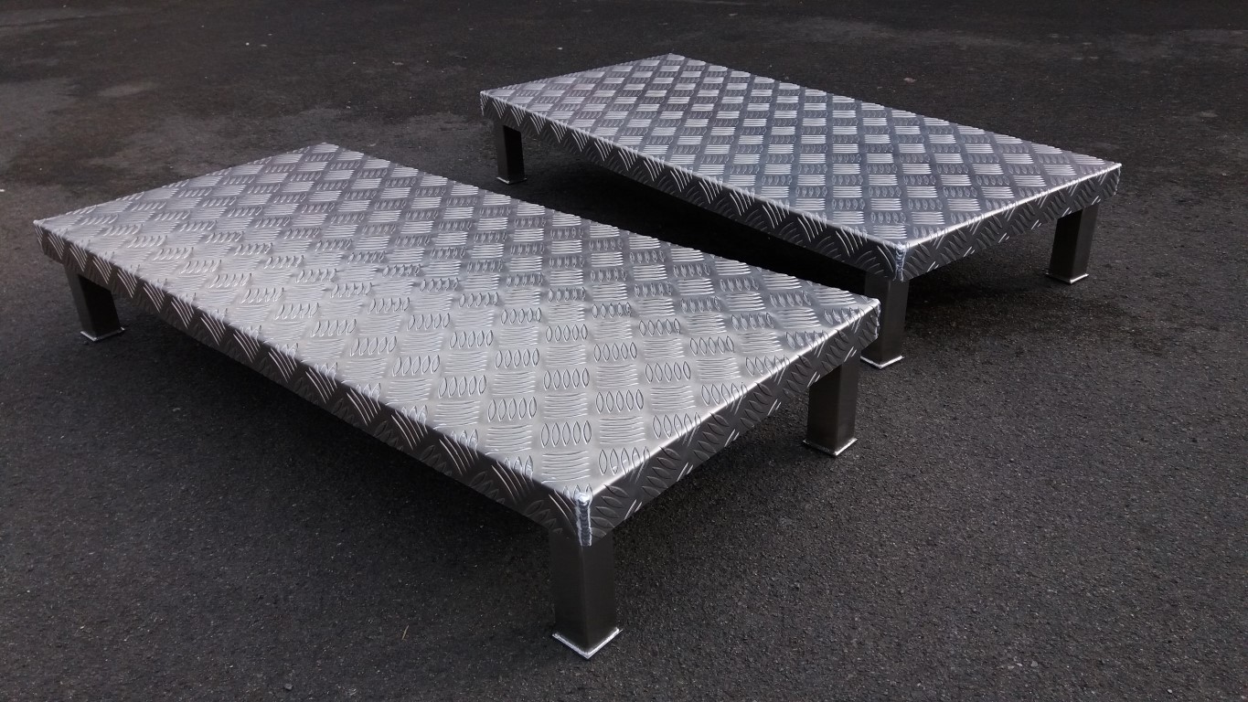

Just a phone call along the lines of "need a stand for a short person asap, leave it with you", that's the spec, never had a drawing from this customer for anything I've ever made for them,Do they give you a "fag packet" drawing with rough dimensions and leave the design to you?

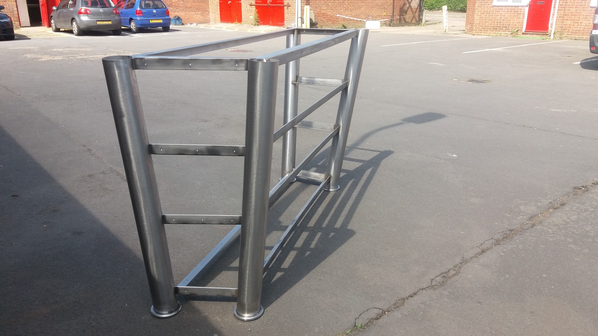

Quick job this morning, a simple guard to fit round a fire alarm point that keeps getting swiped of the wall by people moving stacks of cartons with pallet trucks,

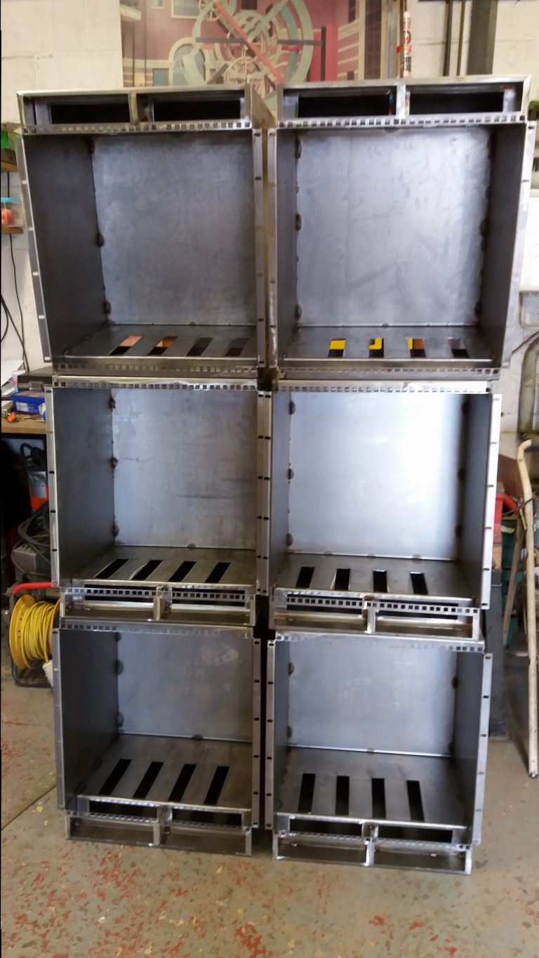

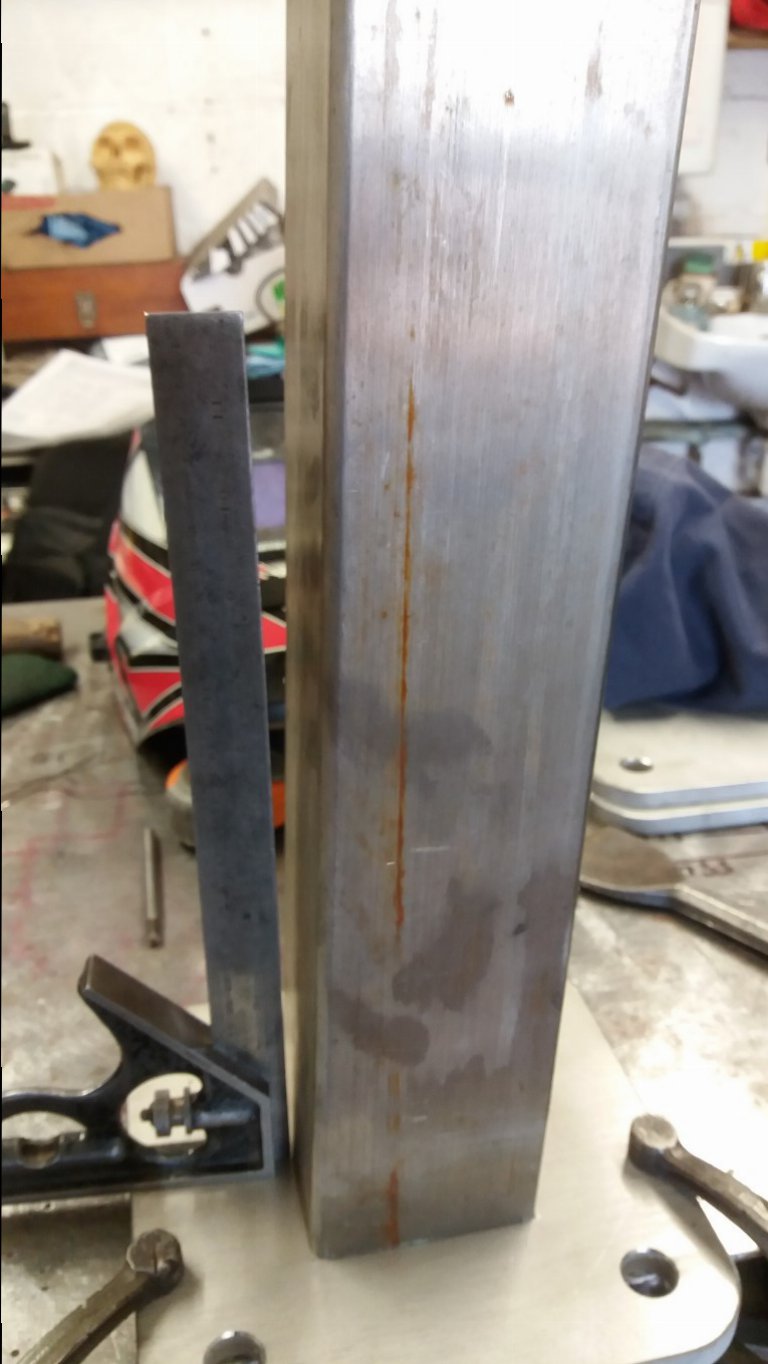

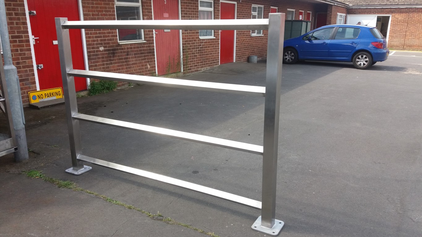

Then assemble a barrier also to protect a machine from pallet truck vandals, for a different customer the material was supplied all cut to size, I'll have to get one of those poundshop squares they must be using, also its a good example of why stainless should be stored separate to mild steel

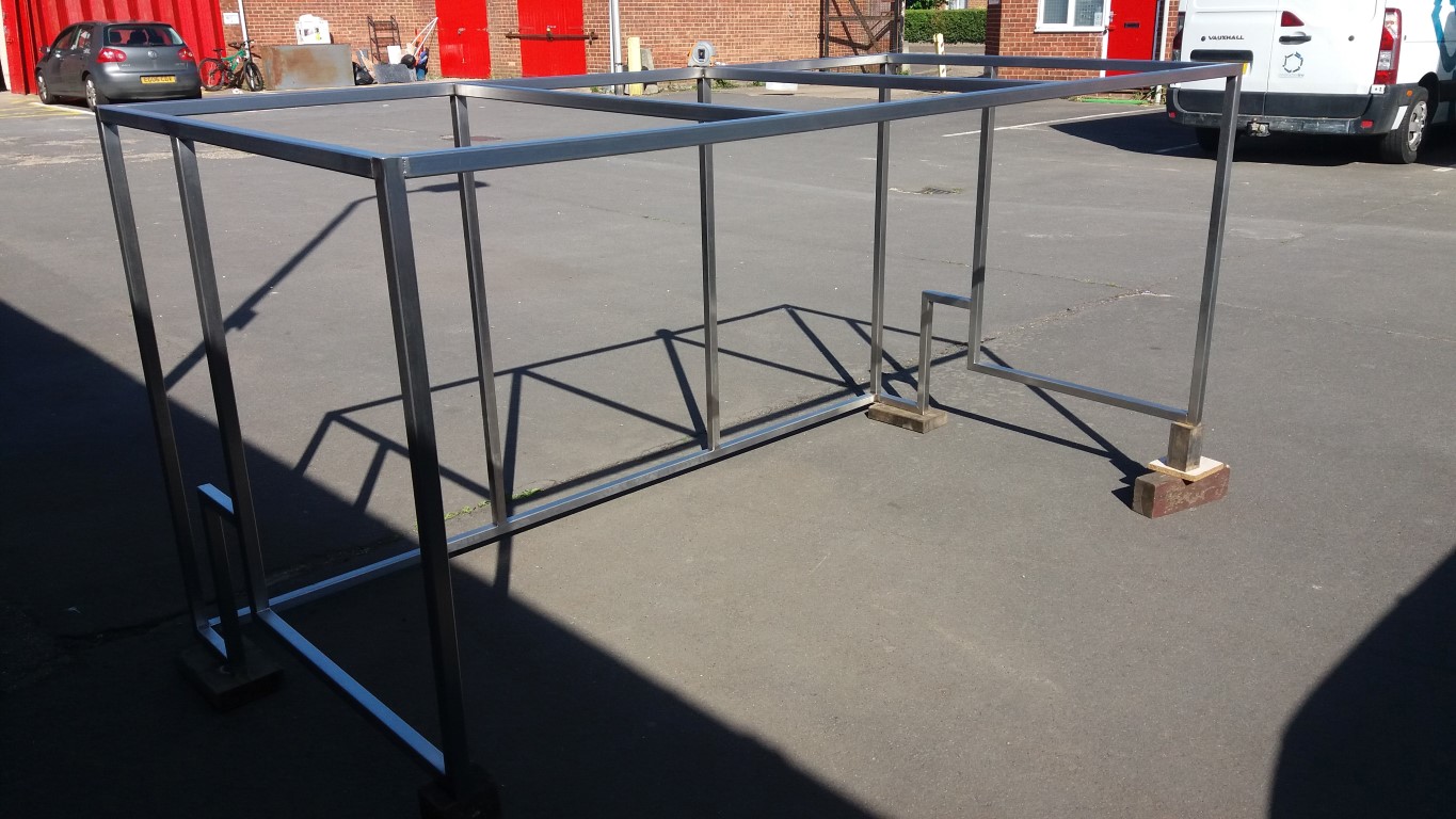

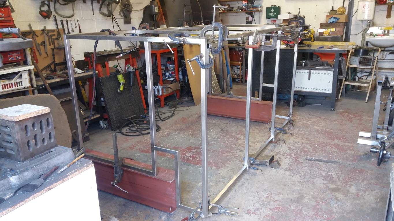

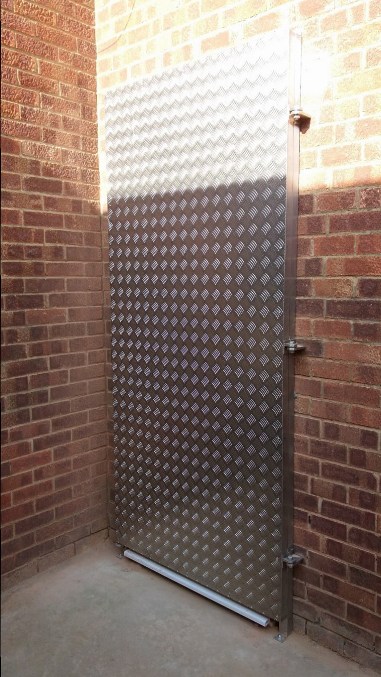

Worked a bit of magic on it and it came out ok in the end, its over two metres long, and one and a half metres high
View attachment 88009 View attachment 88008

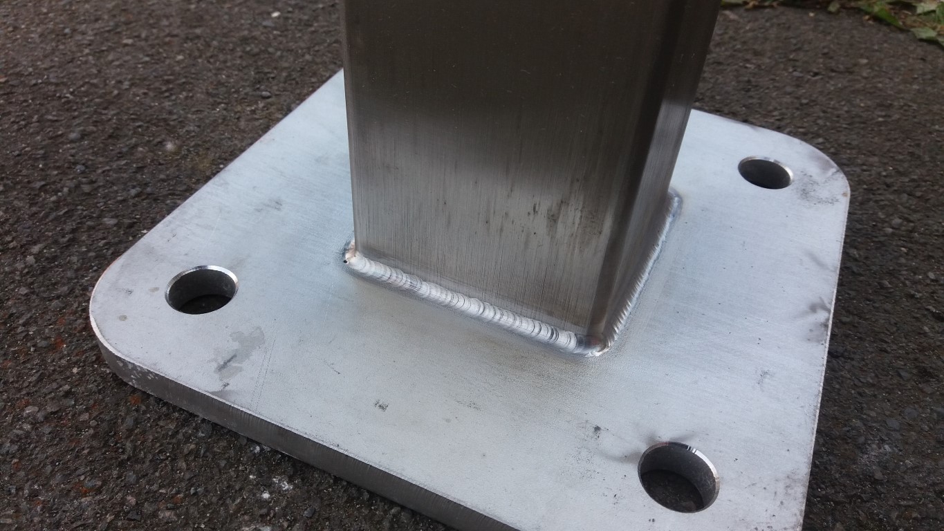

Just done with a flap wheel, I keep the old ones for corners cos it puts a groove in them if you have a lot to do,Hi Paul,
How do you radius the edge of the plate so nicely. That's a really nice touch.

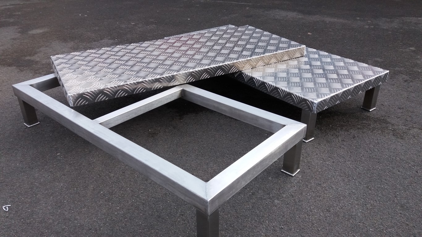

......with an aluminium front panel bonded and riveted on
3m panelbond, they use it for sticking cars together, it had a line of 3m round it and a parallel line of sticks like alongside it and round the rivets to keep the water out,Just for future reference, what did you use for the bonding?
This is for one of my regular customers, it will be used as a product display stand in their reception area after the show.What happens to it after the exhibition?, most stands are skipped when the doors close
Looks good, Do you ever have problems with contamination when working mild steel in a mainly stainless environment. Or is it just a case of keeping disks separate and watching for sparks and grinding dust.
