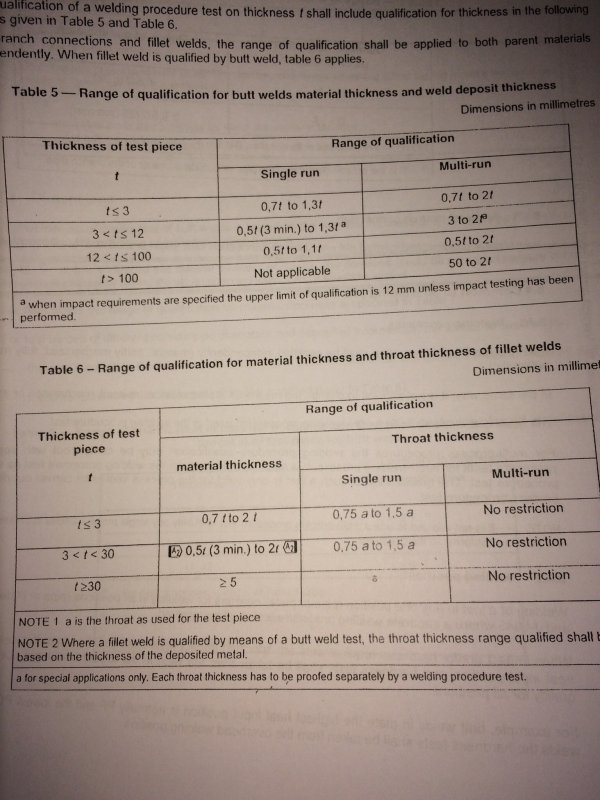

1) So my question about material selection is, going from table 6 in the pic would I be right in thinking if a fillet weld is done on 30mm then that would qualify all fillets 5mm and above?
2) So I would basically right a pWPS, weld a test piece in accordance to that and if everything looks right then write a WQPR for the NoBo to test?
1) yes, a multi layer fillet weld on two pieces of steel each >= 30mm will qualify all multi layer fillet welds on steel >= 5mm thick
2) you write a pWPS for that, weld a piece for a NoBo, they make the PQR and you can write WPS'ses based on that PQR.
There's a change though on your document: Table 6, second row (3 < t < 30) qualifies 0.5 t (3 min) to 2 t (not 1.2 t), see ISO 15614-1:2004/Amd.2:2012
