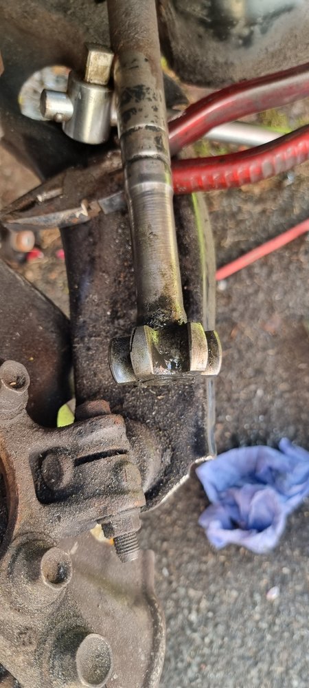

Well, I would be splitting the "new" joint - in the vice not under the car - shaft off in other words. You might find the shaft is ok, and all you need is a CV?Morning campers ..after a restless sleep I'm back on the case. I've done CV's in the past without a problem. In theory the old joint should have come off with a few taps ...as it was, not only did I have to slice the thing almost in half but the 'spider' (see pic) was so tight on the splines that I had to cut it in half and use a hammer and chisel to get it off ... this is unusual!! The the new CV (I've checked and it is the correct item for 2015 mazda 2 automatic) should have gone on with a good 'tap' to get over the circlip and then slide on up ...no way I have even tried the puller as a 'pusher' and now it's jammed on solid

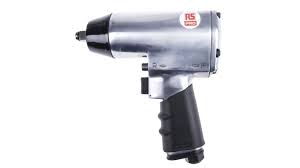

My little Makita DTW190 impact wrench can't get off ...so my only chance is a complete driveshaft. I will check tomorrow with Mazda how much a new one will be and also ring a couple of the places you guys have kindly searched and posted on here. I'll get back tomorrow with my findings ...........
Yep. Last clutch kit I bought, the internal splines were quite badly burred, I went over them with a needle file before it would fit. That was a LUK not a cheapy, never seen that before but it clearly does happen.The last one I did on the Isuzu Trooper I had to spend a bit of time with needle files going over the splines on the shaft, I think it was just the poor tolerances on the aftermarket CV joint being too tight on the shaft
