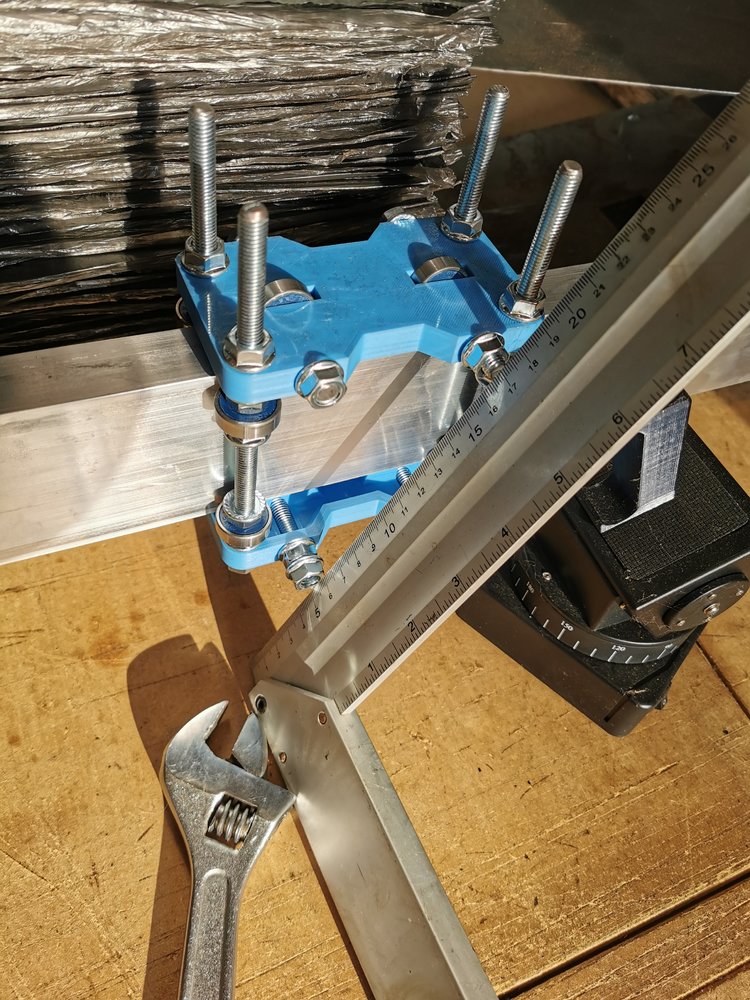

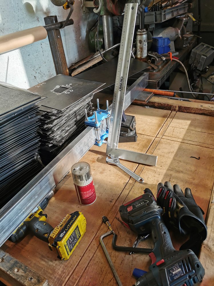

Cheers mate. I will get it printing shortly.Blade holder and clamp.
<edit> added the sketchup file. I made the minimum distance between centres 113mm (just in case) and thickened up the body.

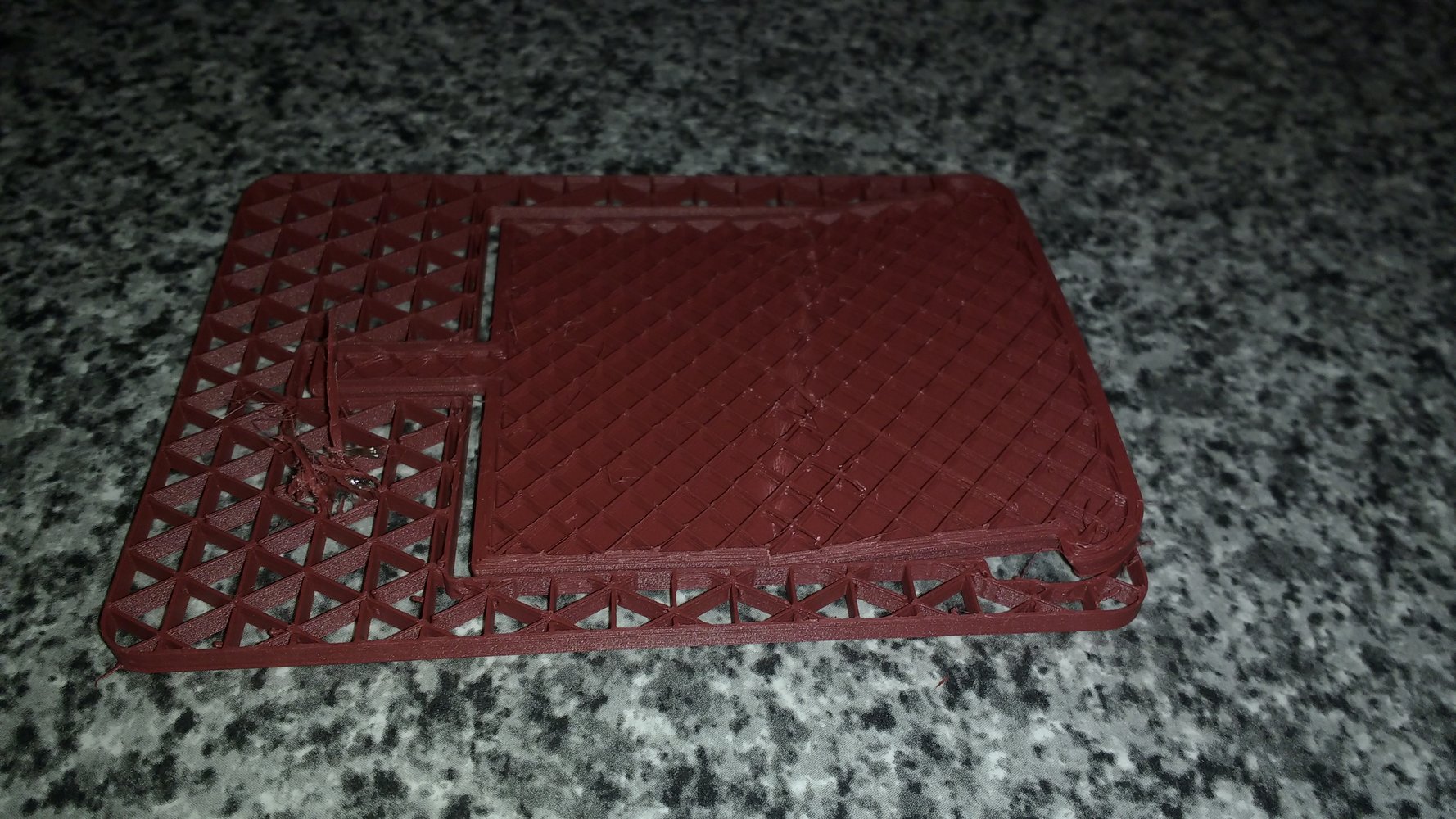

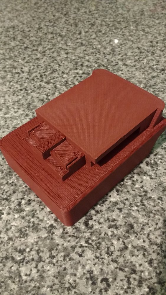

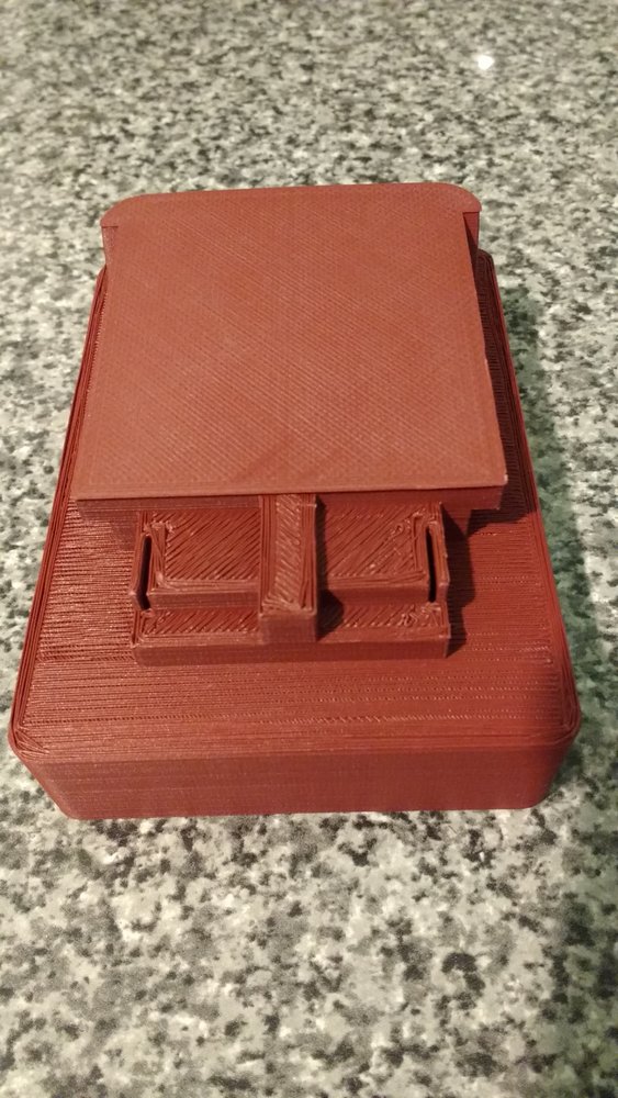

If you wanted it to be stronger you can add more perimeters rather than infill. Supported areas look OK to me, I've seen (and printed) worse). After all, it's functional rather than a contender for most beautiful print.

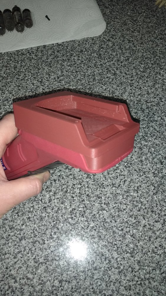

As others have said infil seems fine. It's functional as opposed to strong part.Finished, it'll do. Only 10% infill which is down to my boy not me. Seems very lightweight. Took about 6 hours. @ukracer, what would you do this at infill wise, how long would you reckon it'd take (1.75mm filament)?
These "ragged" areas were supported. The quality is to my mind a bit carp. Be interested to see other people's "supported" faces.
I'll make the copper strip inserts tomorrow hopefully.
Printed the STL mate. Just been busy over the last few days. It printed mint.Blade holder and clamp.
