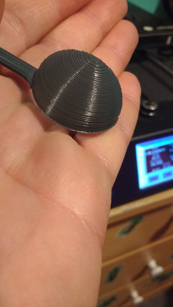

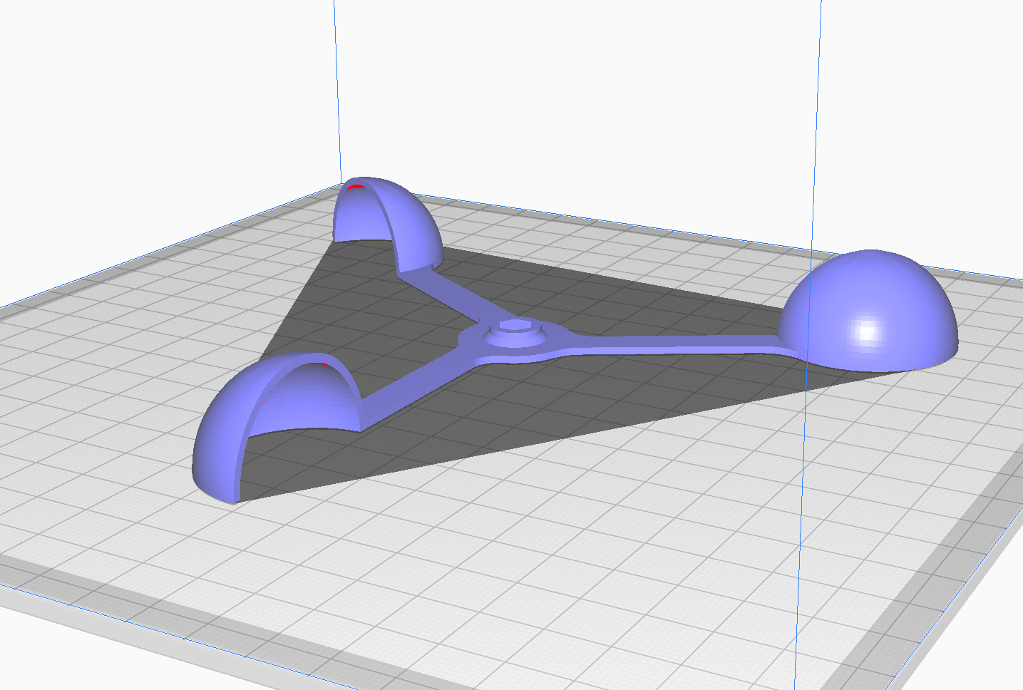

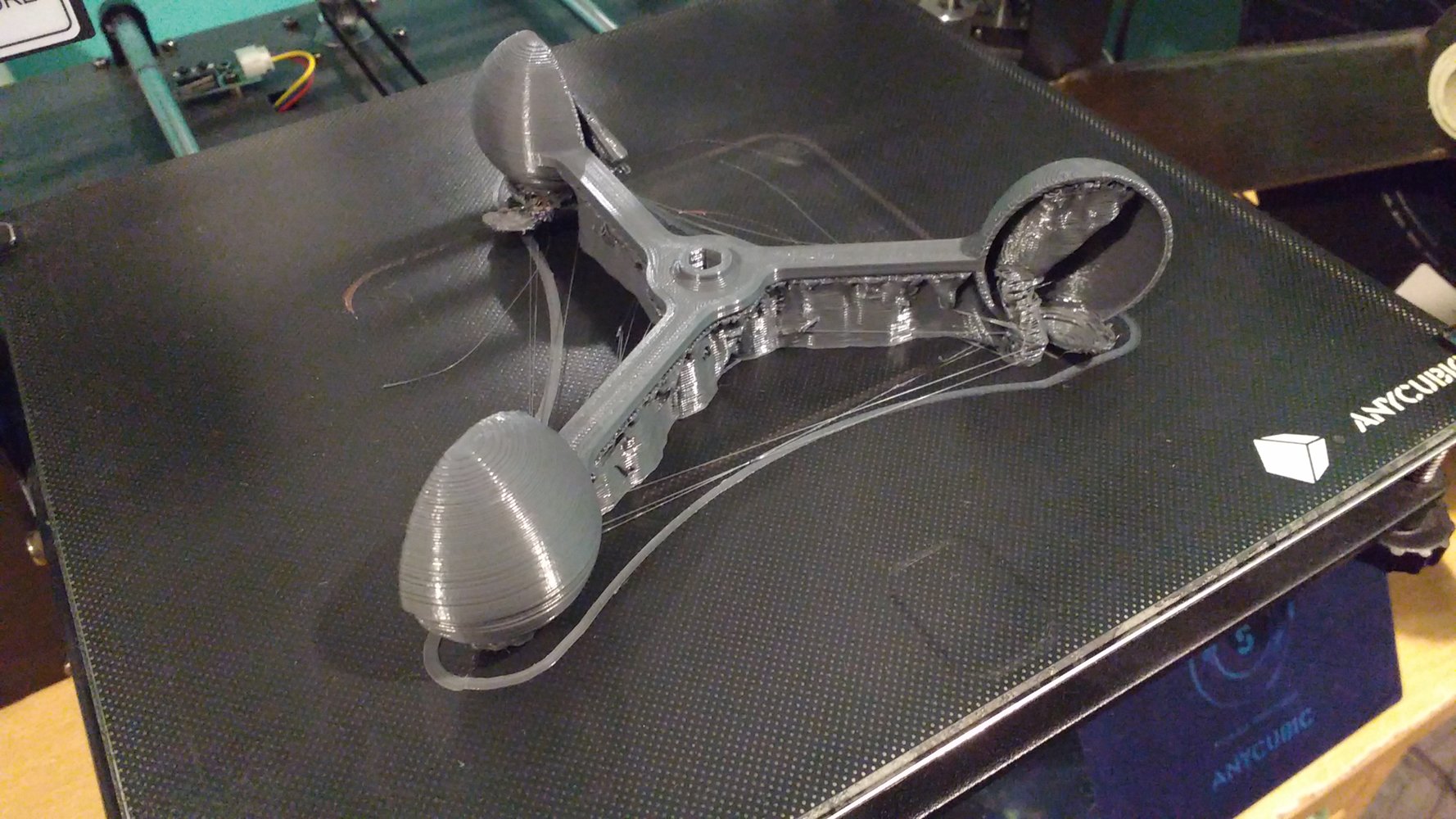

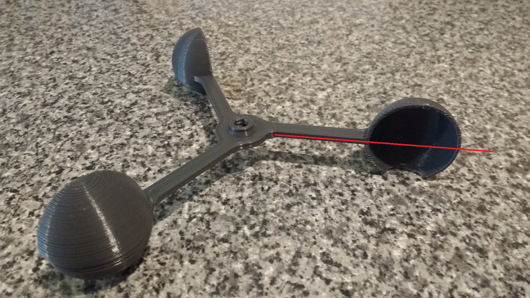

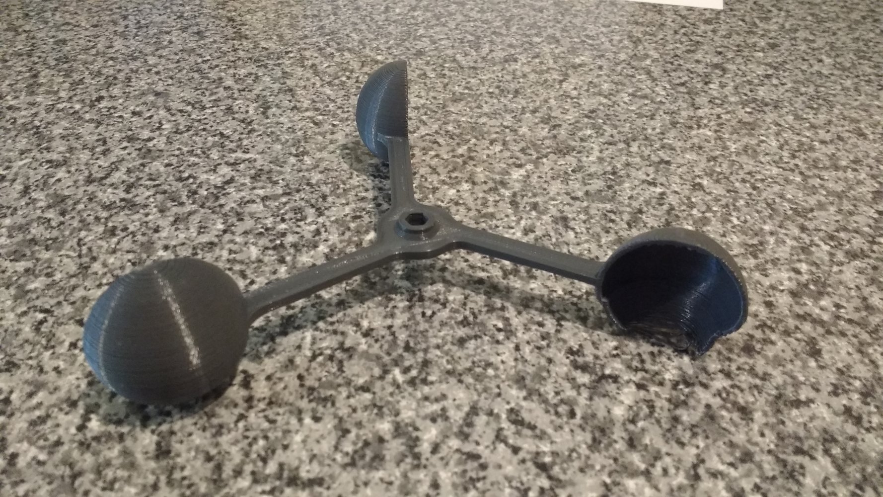

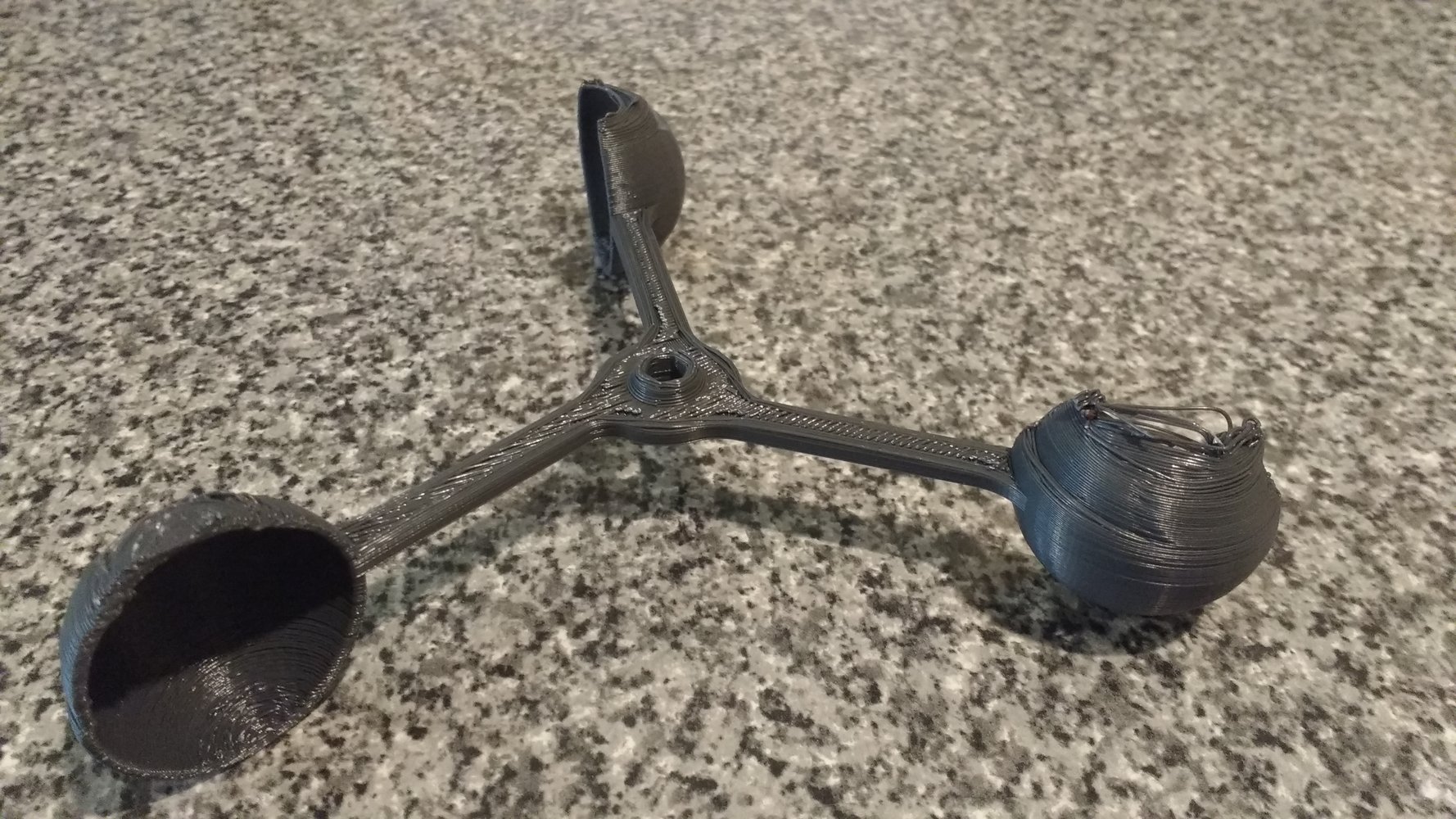

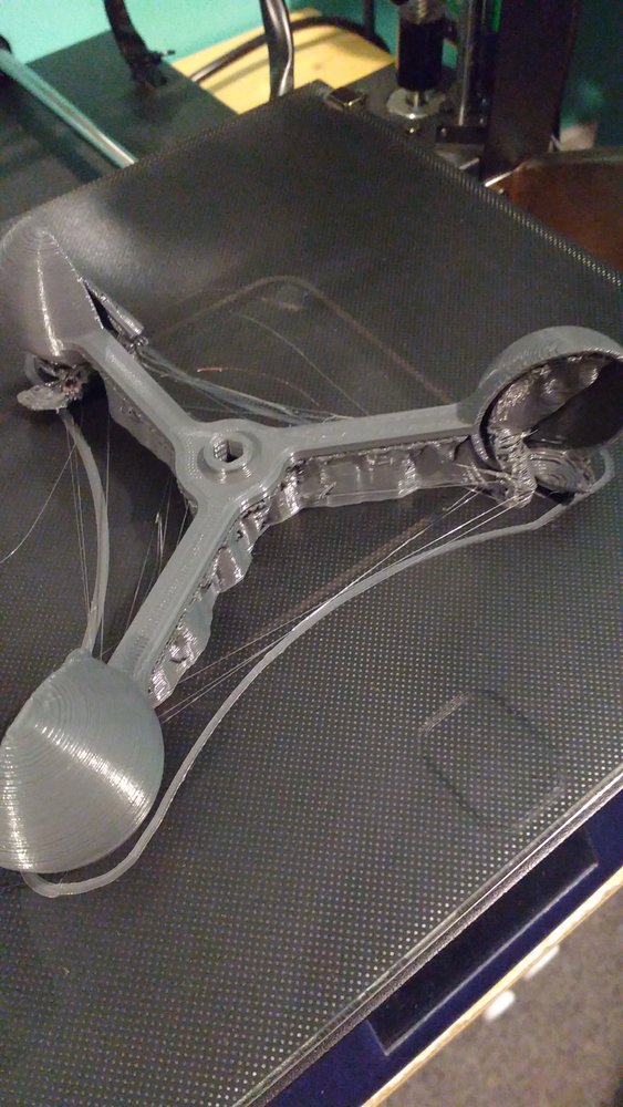

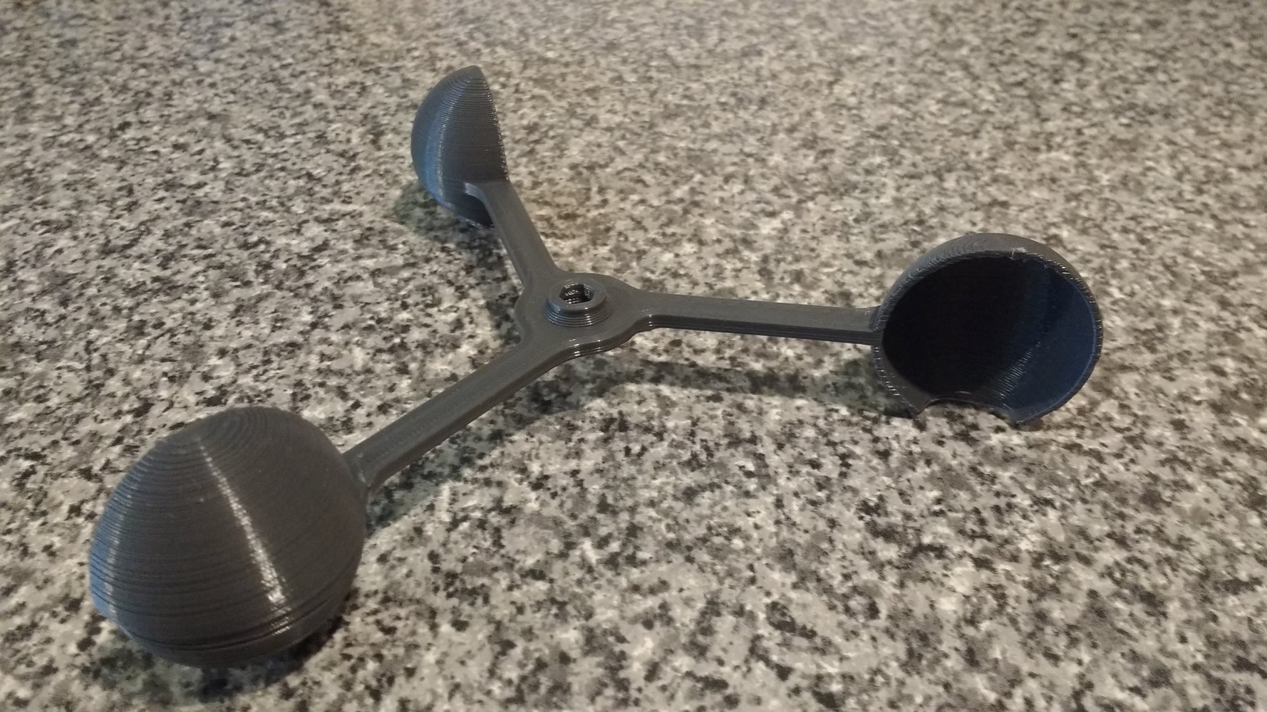

With a dual head printer you could use water dissolvable support material.

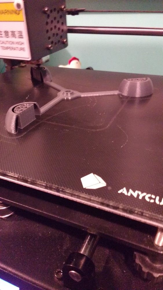

Slowing the print speed down and reducing the layer height may help, or split the print in half and either bond the two halves together or incorporate some mechanical fixing points in the arms.
Split parallel to the surface, then the support inside the cups should work as it starts large then reduces in size
This. It's the overhang that's the problem. Set it to automatic supports and you're good to go. They're easy to remove by hand.What Slicer are you using? In Prusa Slicer there is an option to paint on supports as well as automatic selection. Looks like a judicious use of the former might help you. I've printed quite a lot with both options and they are dead easy to remove after printing.

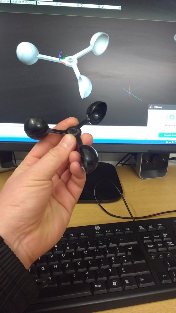

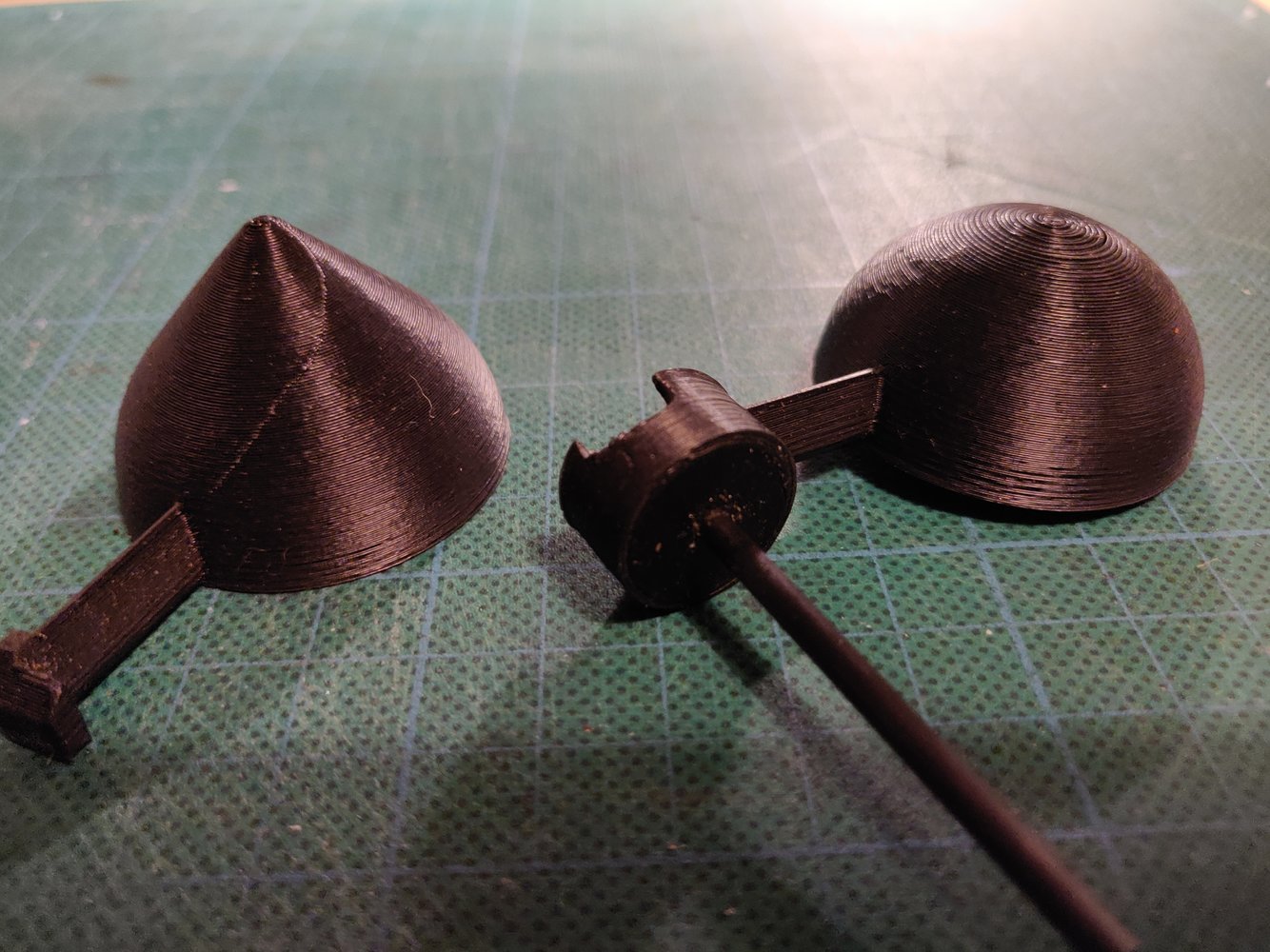

I hate supports - personally I'd rethink construction, I've made a few anemometers and always printed them with separate arms...
What layer height are you using?

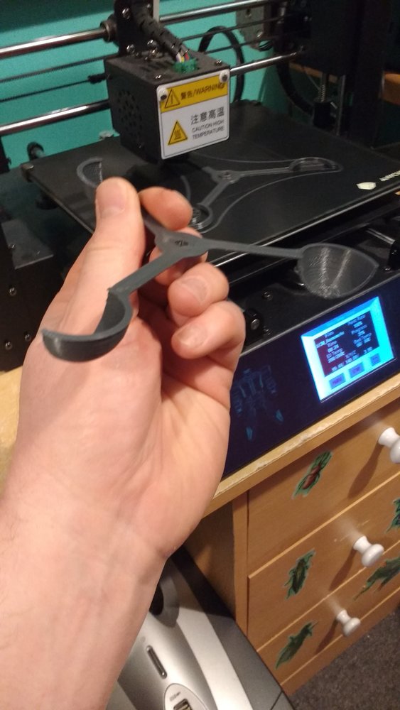

|Send me the STL mate. I will run it through my printers and see what it prints like!Yep, discussed that with No.1 son earlier.
Just done that, better but not perfect. Plan to use mitre bond then slide the two bits together on a 6mm hex shaft to align:
