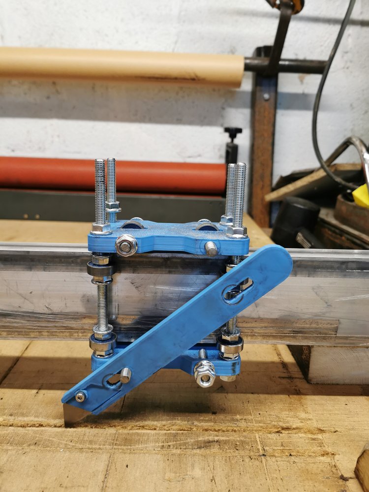

Obviously just a hack to show the principle. Green bit is spring and presses on the table. It is fixed to the arbor arm and holds down the material, then the springs compress and the punch engages etc.
On some of mine I have a large urethane ring inside a telescopic body which fits around the punch.
