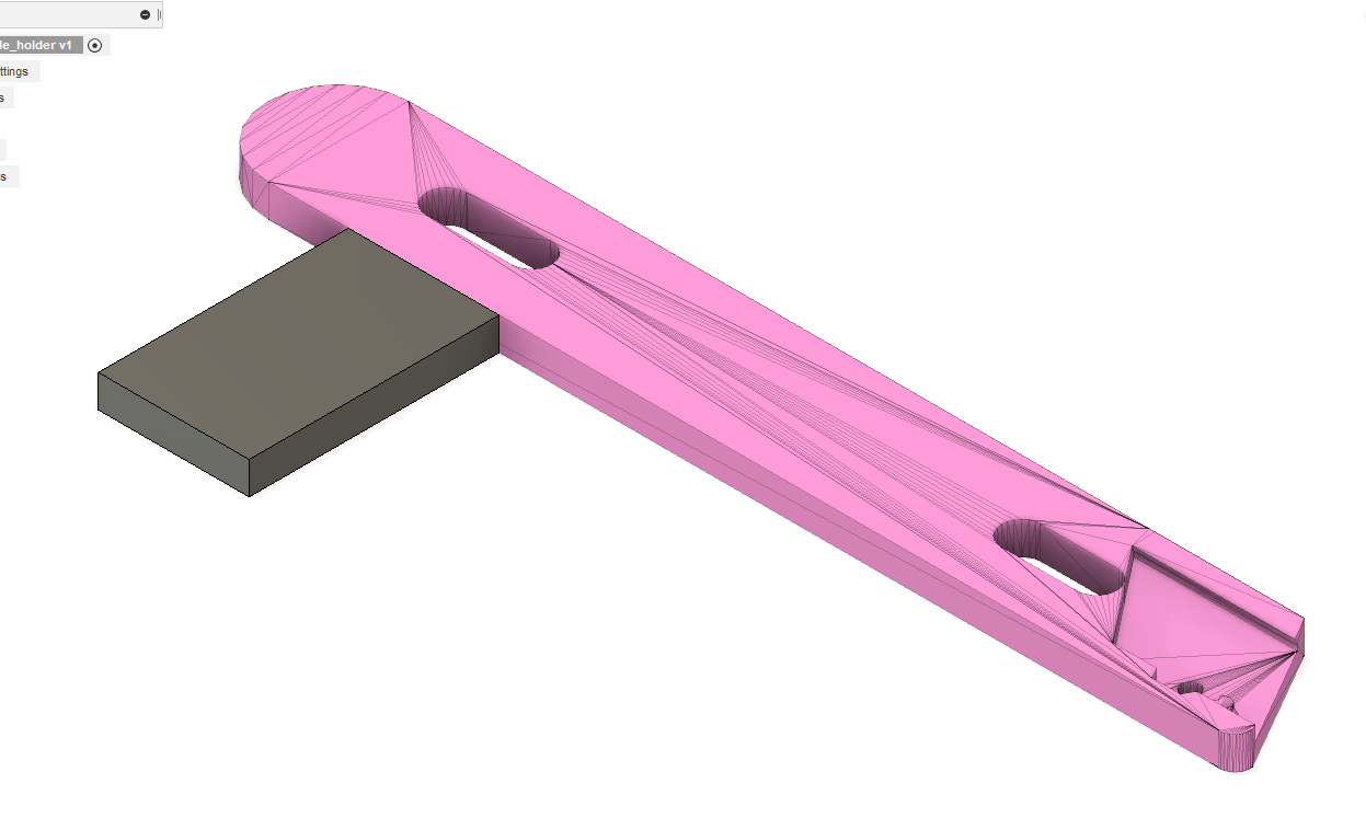

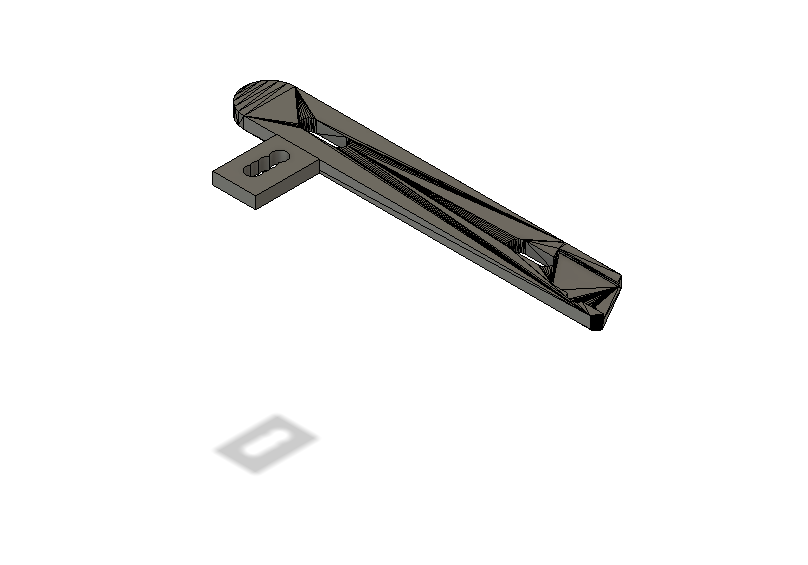

The file is on this page .. https://www.mig-welding.co.uk/forum/threads/handy-3d-prints-for-the-workshop.97647/page-18I'll admit, that despite having done quite a bit of mesh manipulation in Fusion this year, I've not had any reason to do it since the big update for mesh.
If you can send me a link to the stl, I'll have a play tomorrow.
