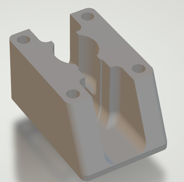

Guy on the Fusion forum kindly converted it and added what I think is a parametric adjustment so I can print and try and adjust as needed.Mesh menu. Modify -> Convert Mesh.
This should then convert the model, with the model shown in black.
To create a solid surface for then sketching on, switch to Surface.
Then Modify -> Merge. With the merge window open, select the two triangles that now make up the side of the holder.
After that, stay in surface, and sketch/extrude your extra bit there.
