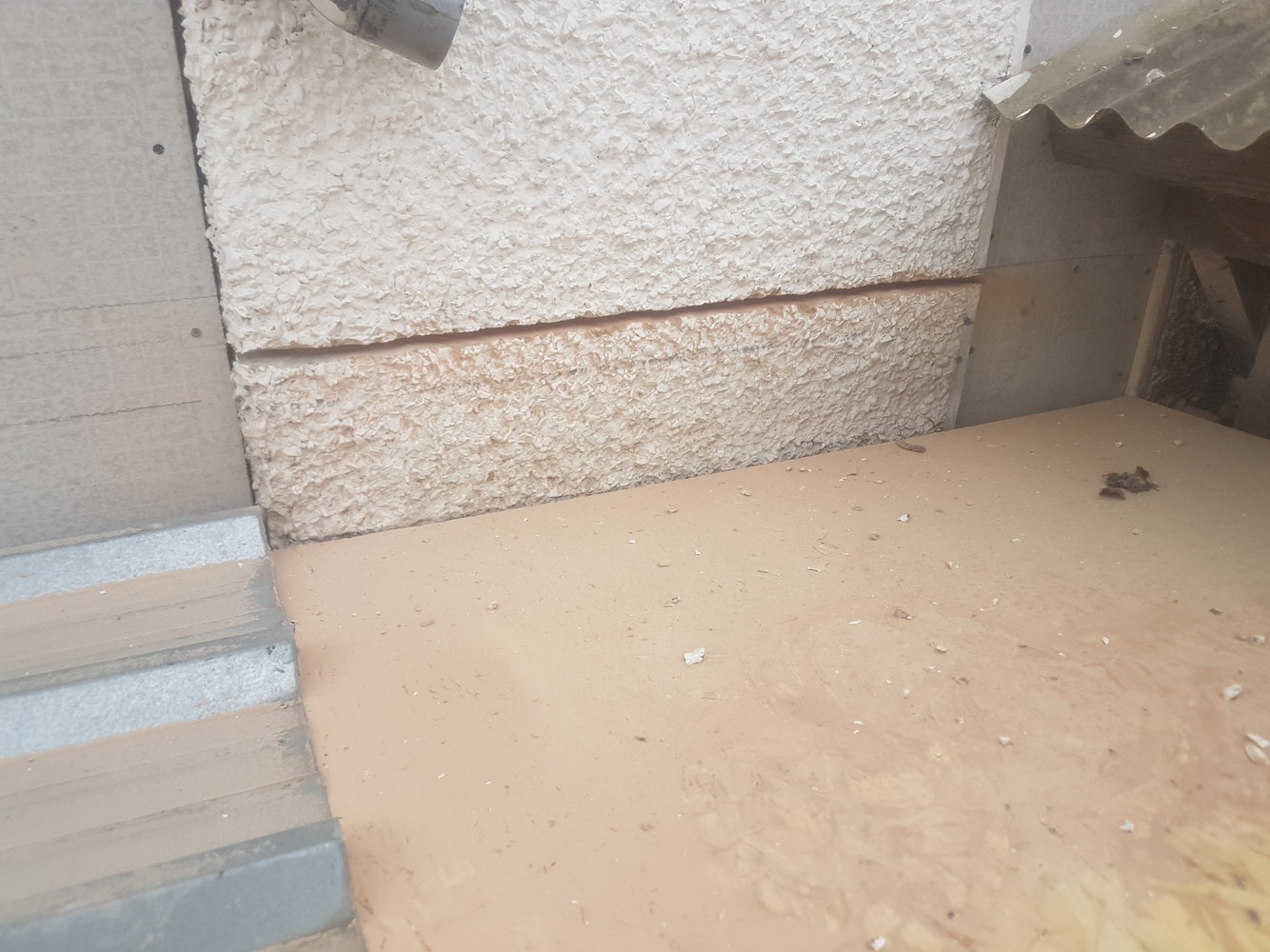

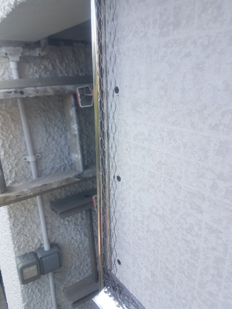

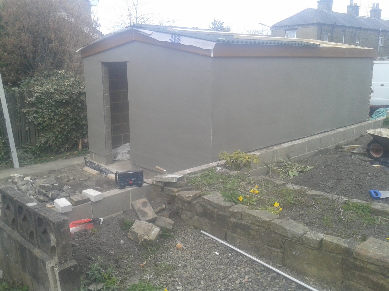

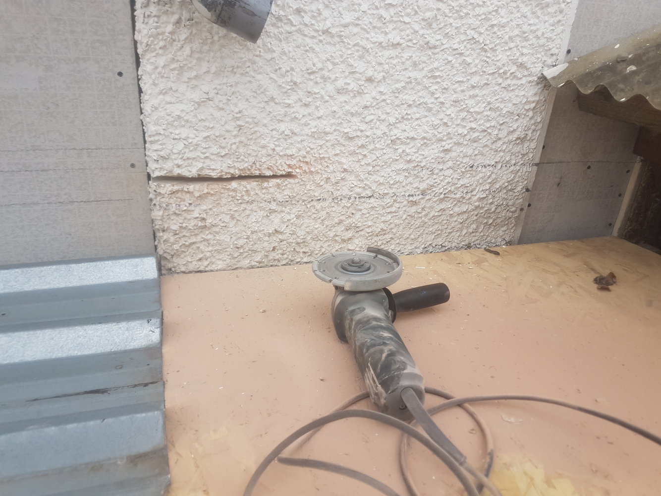

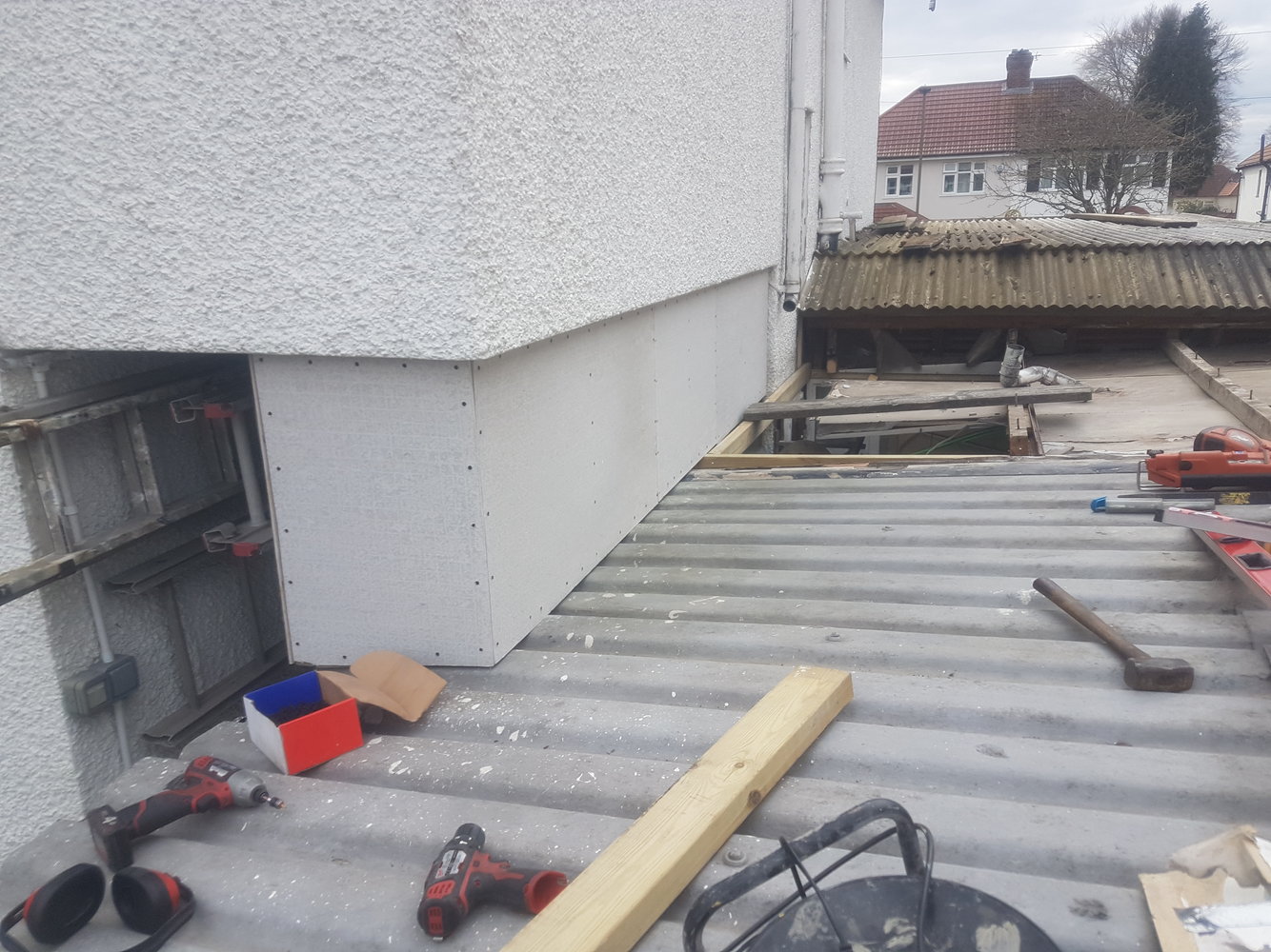

it sure does thanks for the advice took some getting out I tell yalooks better allready so far without that stupid wall being there

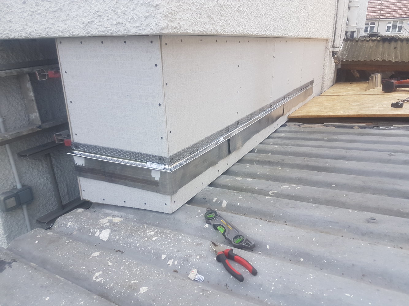

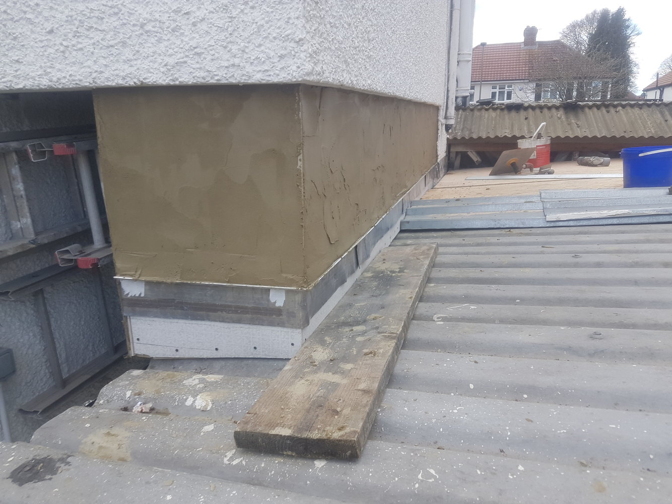

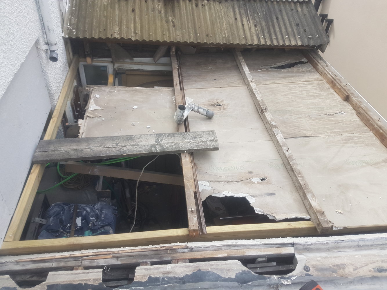

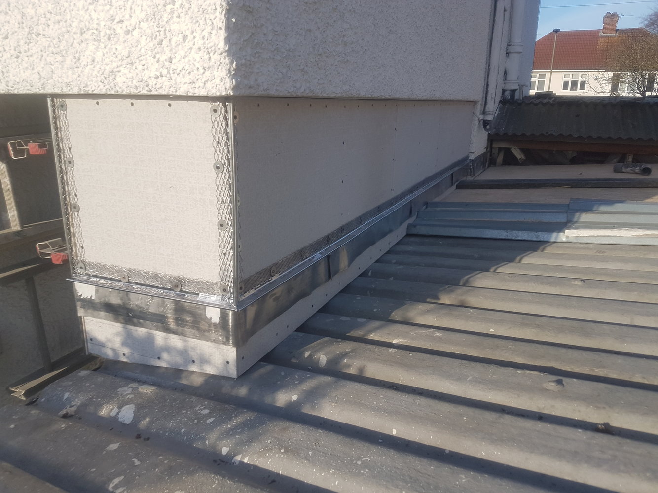

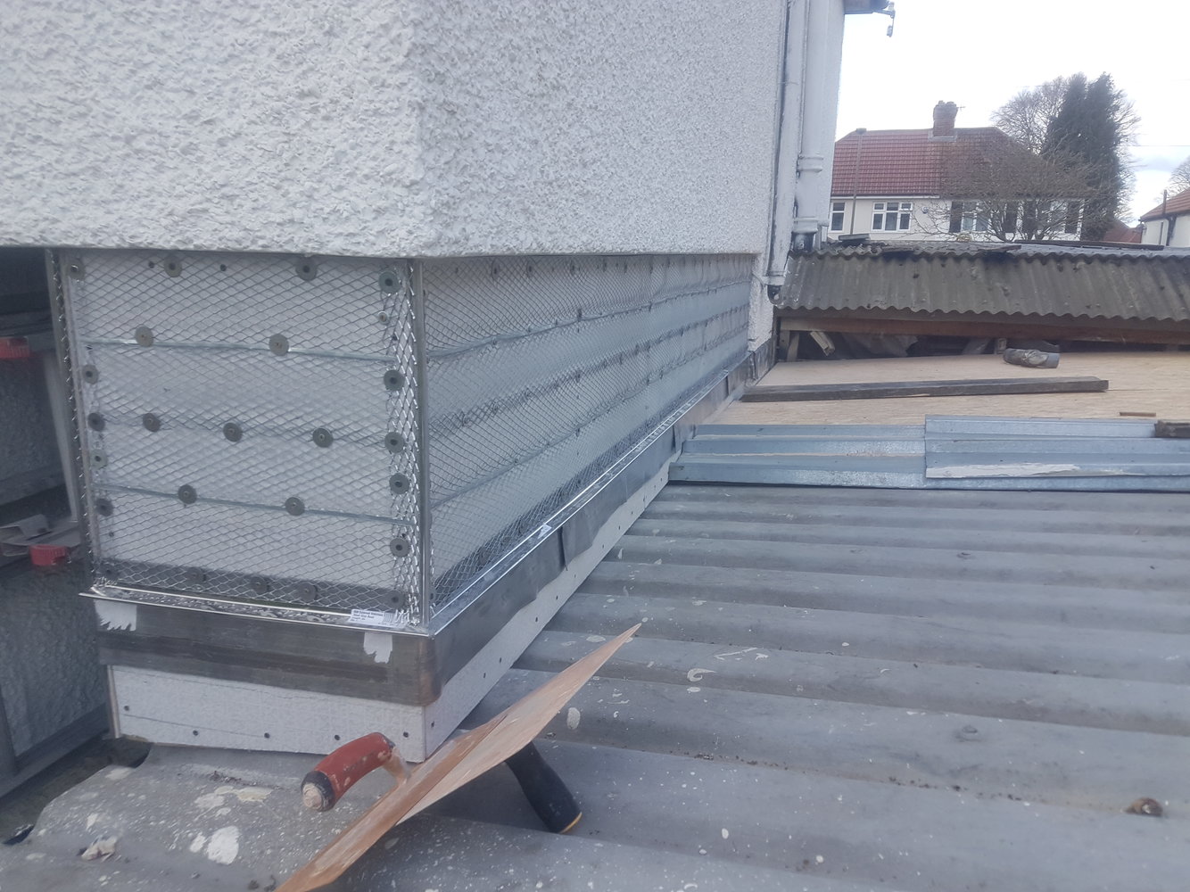

sourthern sheeting have let me down on the box gutter! not happy, but gotta crack on thay said wednesday at the latestwhy ?
id have been getting your roof water tight first main thing to do
cementing up is the second thing to do the finishing off work same with the leading over the uprights there all last jobs to do
the main thing fit your roof sheets and valley is the most important thing to be fitting and getting it finished here

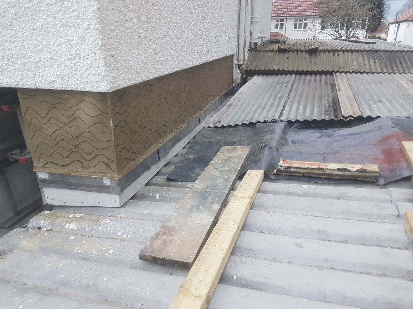

That's a great idea I have nail on and torch on felt in the workshopif your doing it temporary buy some felt and just felt it along where the box gutter is going
then just put the box gutter straight over it
even shed felt will be enough to do the job your wanting it for

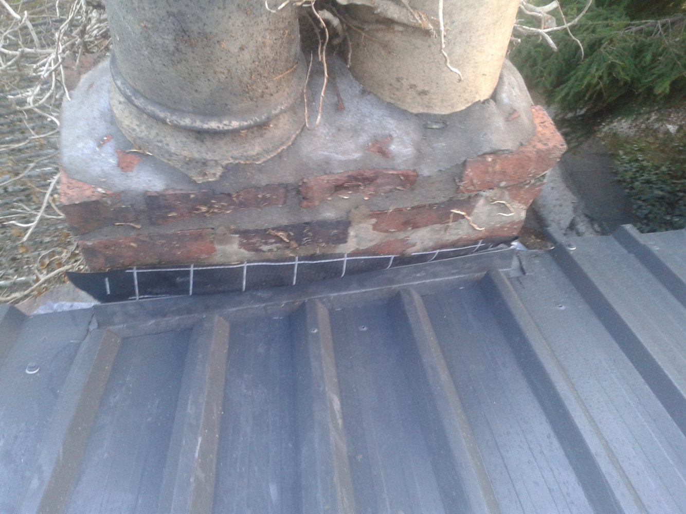

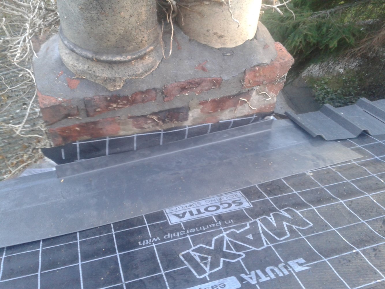

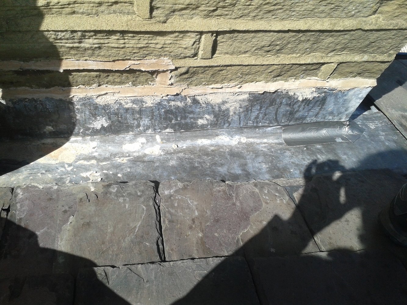

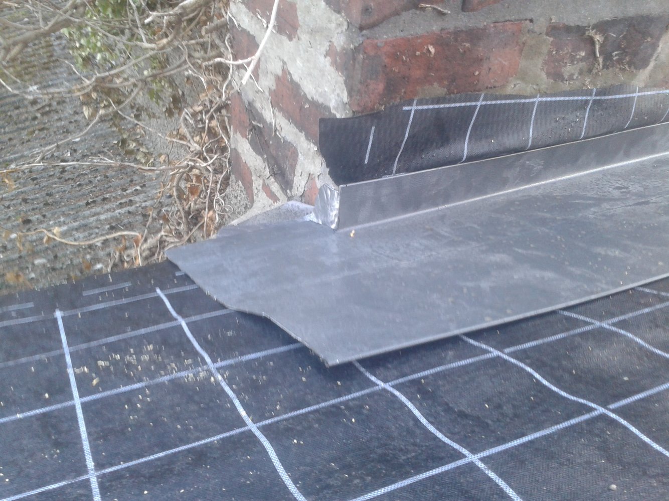

The wrap around will be the box gutter I will have to do as I said then cut and weld a 90 degree corner on itits the same as a lead valley behind a chimney

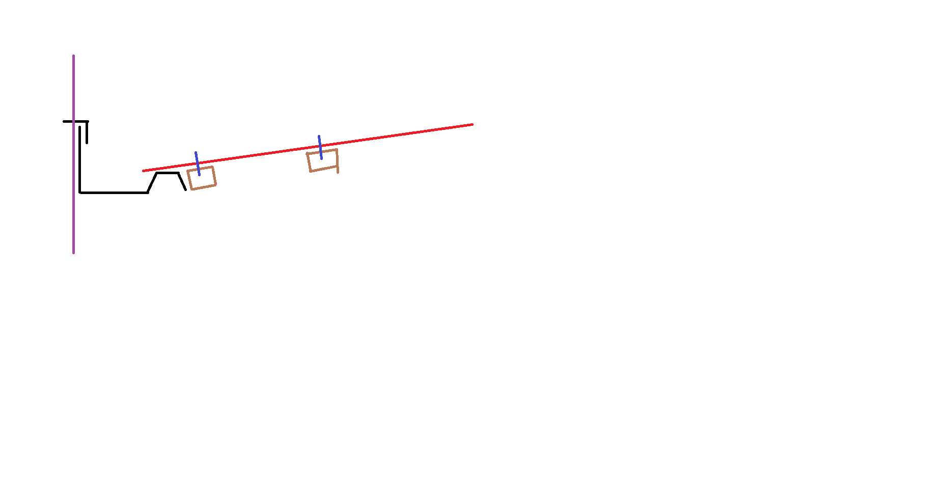

View attachment 283781View attachment 283782

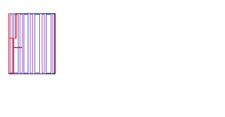

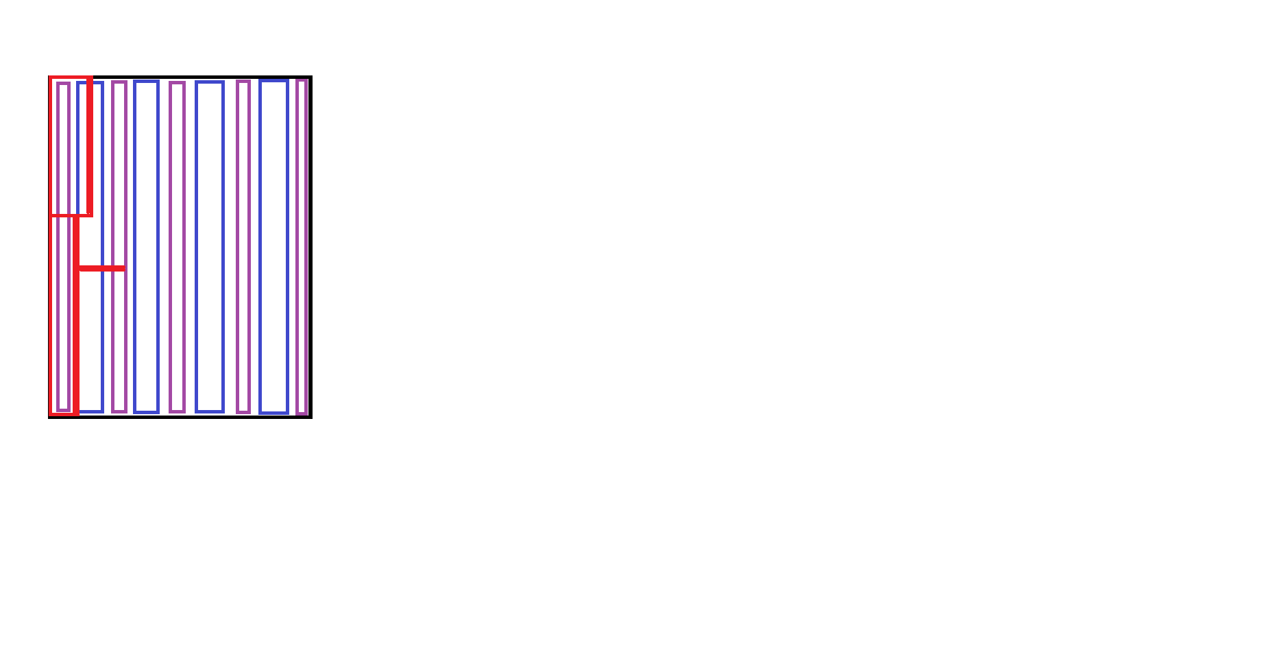

the roof sheet valley looks like this the red being th top of the roof sheet and lowest point of it
the grey is the lead or tin sheet underneath to create the wrap around seal you need for the corner
the valley sits on top of the roof box profile high point at one end drawn in black you will have to pack the wall side up to level that side
the valley is then bent over at the end so you can seal it over the high point of the box profile roofing sheet
the higher red is your box profile roofing sitting over the other roof profile so it seals over it at the corner

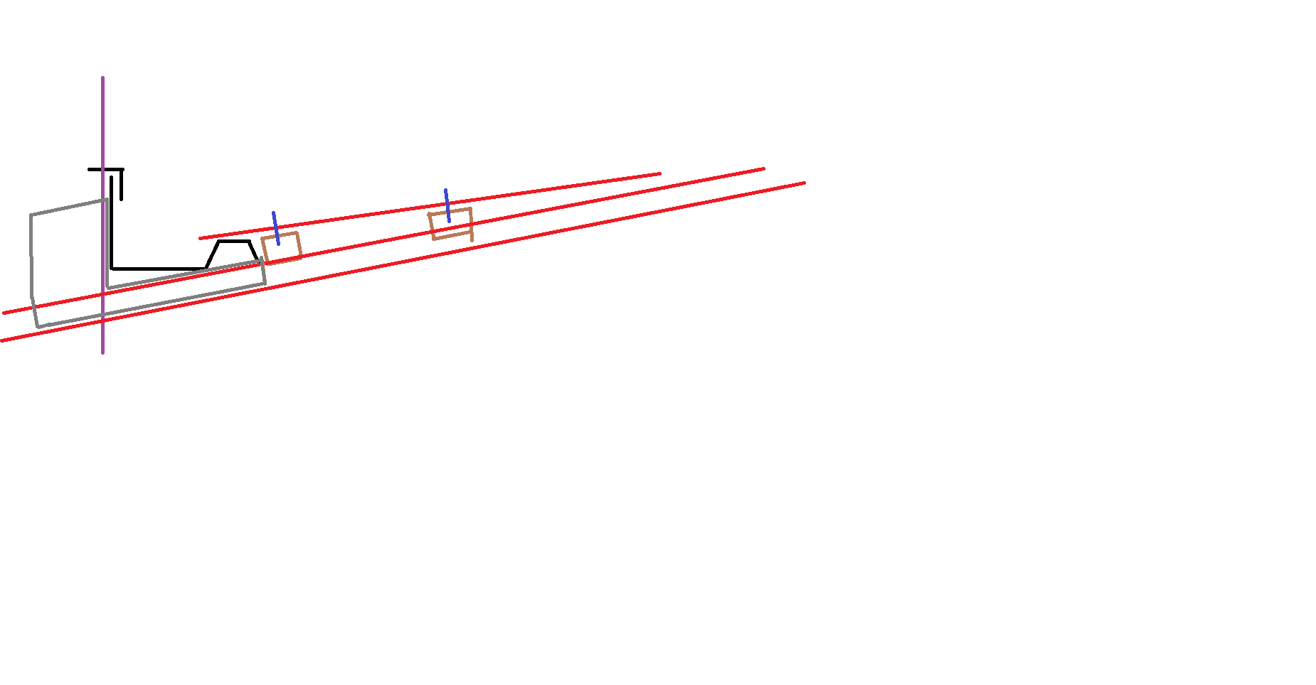

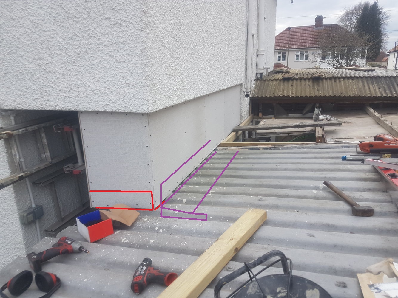

you actually have it predone in this pic
ive drawn where you would cut and fold it up against the wall in red
purple is your valley fold over the top part of the roofing profile one side will be higher nearest the wall
between the red and purple you need a wrap around so you can seal it on the corner
