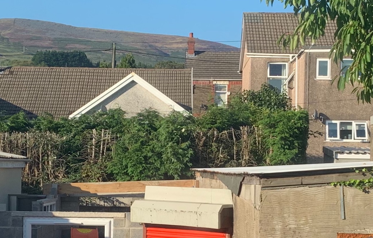

2% slope will do it s surely?
nice hills, nice view.

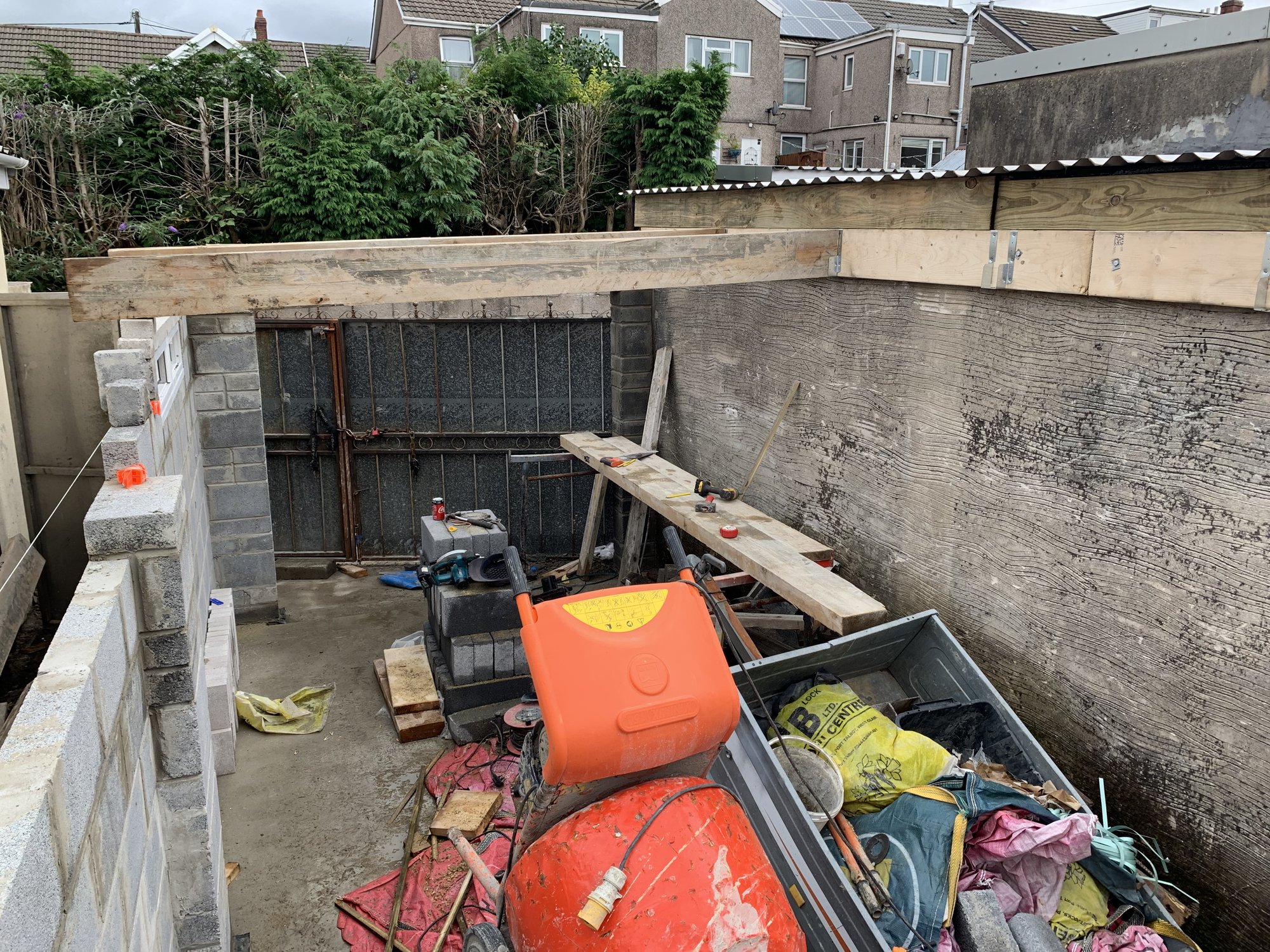

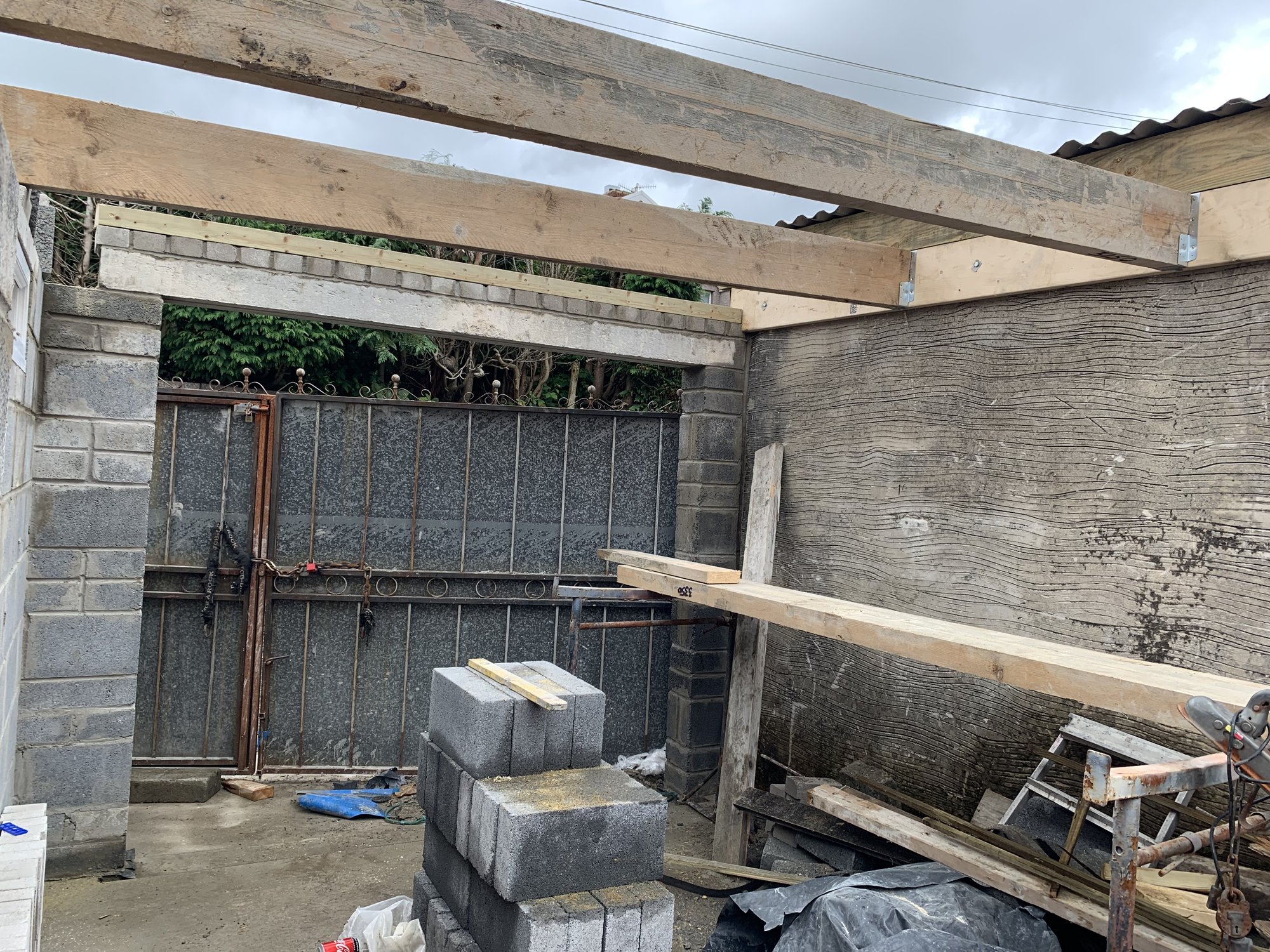

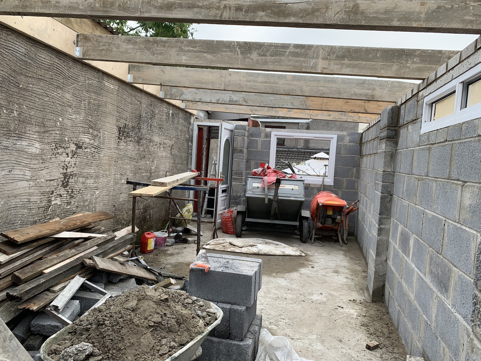

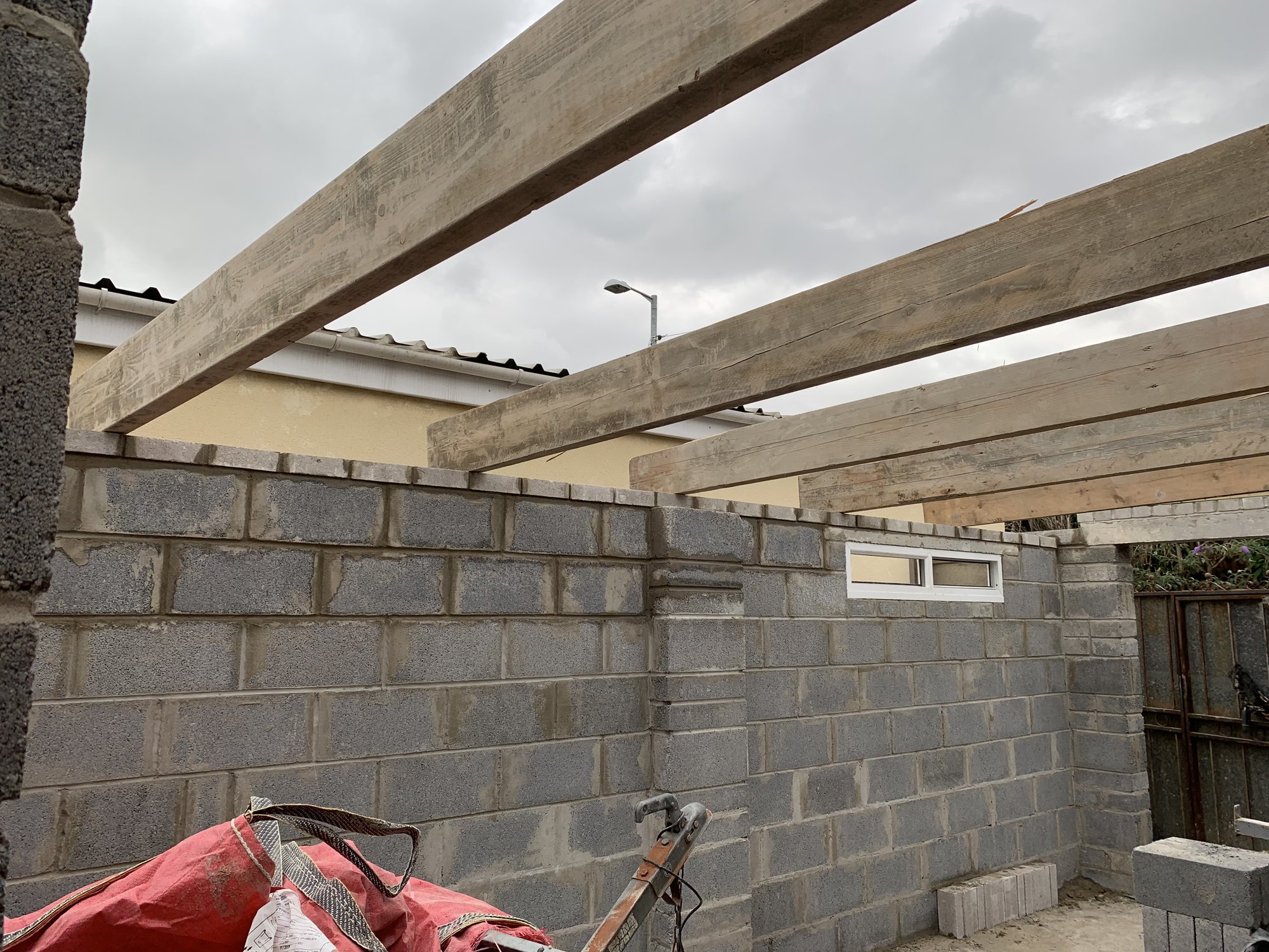

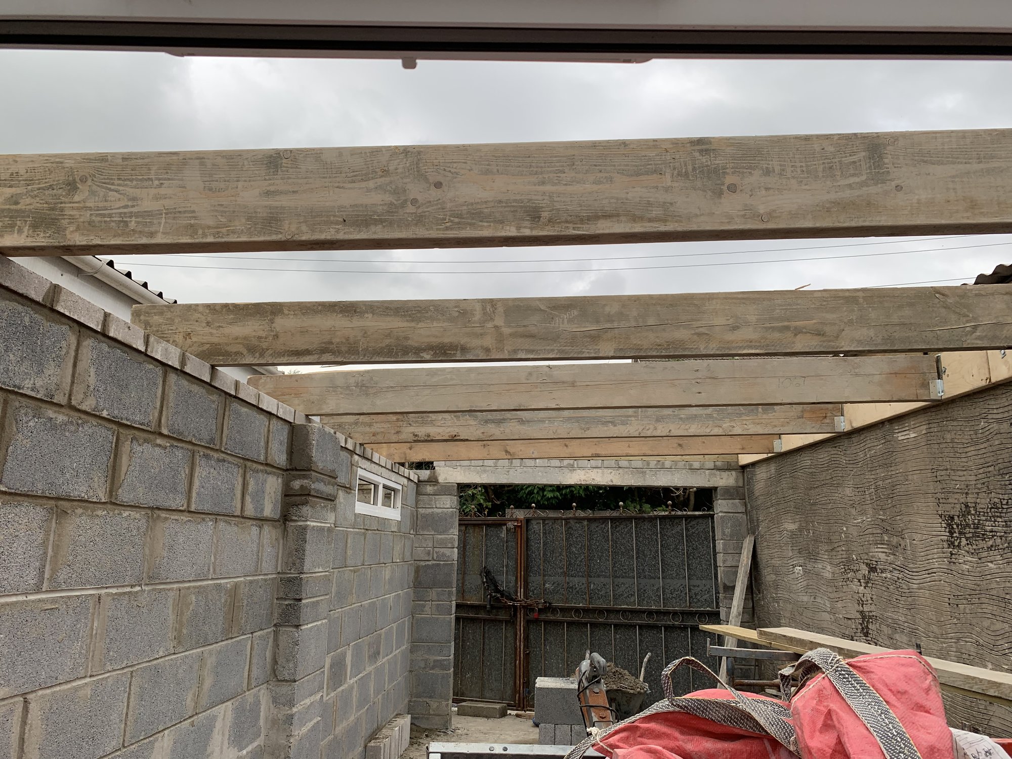

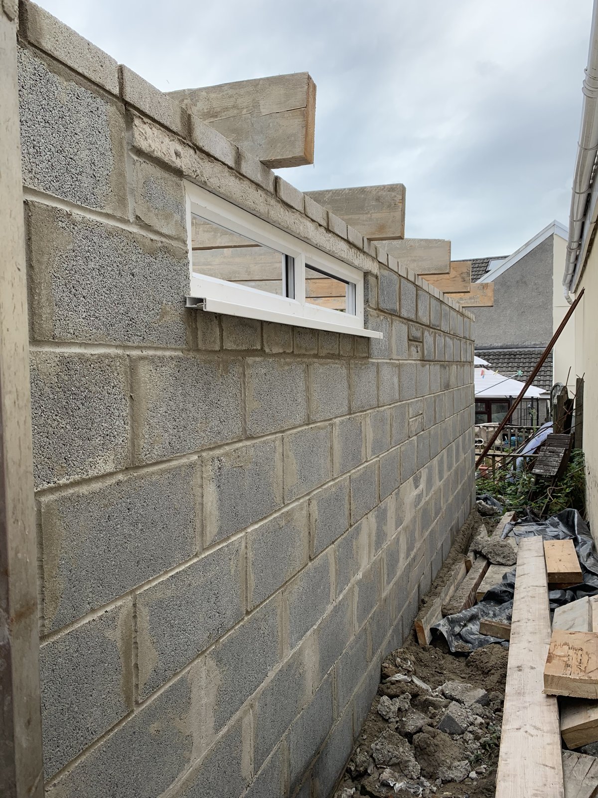

What on earth were they thinking when they cut those trees?Earlier this evening I took a photo out of the bedroom window and the fall of the roof is clear to see and is no worse than my old garage roof. Don’t know why I didn’t think of this earlier!
Quite happy with that so I now have a way forward once my wall plate timber bearers arrive. I already have the 9x3 joists so just waiting for them once I run a course of concrete commons along the long wall.

just drop the left side down more as gives a better fall on the roof
no need to fit a small block on the top and if you are screw a piece of 3x2/4x2 as a top plate for the beam to fasten onto
