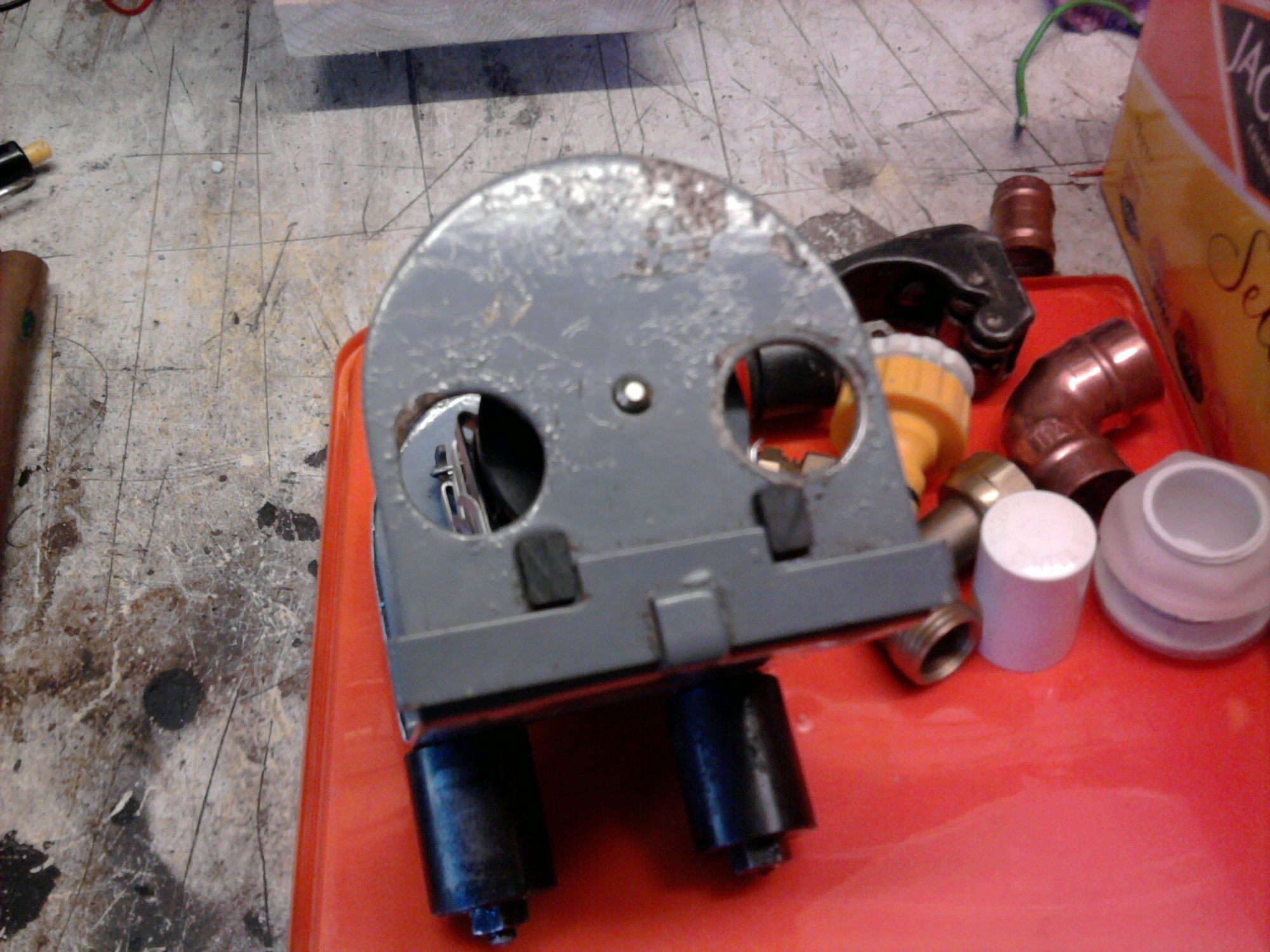

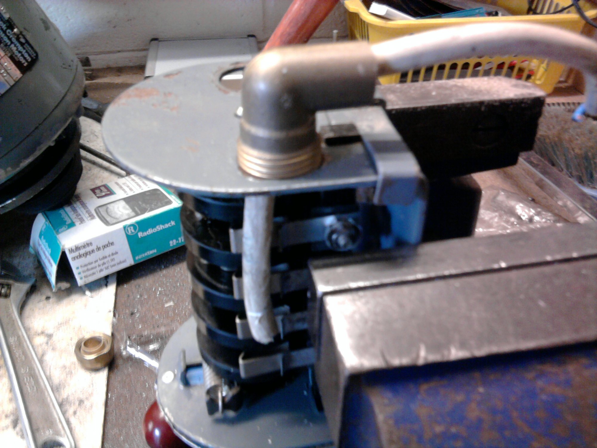

The switch has been cleaned, surprising the amount of debris that had collected inside it, I now have the problem of two 20mm cable access points and nothing to put into them.
Ideally I need to reduce the size to suit the cable and at the same time direct the cable to the rear of the machine instead of hanging down under the switch, a small lathe would have been handy to make something but....
So a rummage in junk box number 21,431 and lo and behold a pair of 90 degree tap fittings, which luckily with a small bit of Dremmel work will screw nicely into the holes, test fitting a bit of old cable proves it's a nice fit without a severe bending and a double check for any sharp internal surfaces will be made, the cables will be pointing in the right direction and grommets will be squeezed in at both ends once fitted.
I won't do a final fit until the new cable arrives and I know for certain it is all a good fit with no chance of damage introducing a danger.
