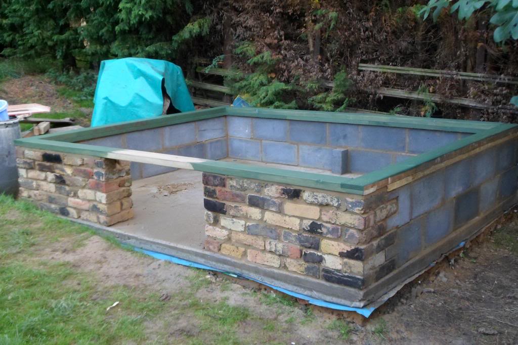

I wish I had laid 2 layer of brickwork on the reinforced slab that I constructed our log cabin office on & used a DPC on top of the bricks . 11 years on the super treated guaranteed 10 anti rot treatment has died the bearers have started to show sign of wet rot on the outer bearers .You can use DPM between slab and timber . You do what you thinks best I opted for timber raised of the deck for less contact with water.
did u use a DPM ontop of the slab before the bearersI wish I had laid 2 layer of brickwork on the reinforced slab that I constructed our log cabin office on & used a DPC on top of the bricks . 11 years on the super treated guaranteed 10 anti rot treatment has died the bearers have started to show sign of wet rot on the outer bearers .
As a temp solution I've given the timbers five anti rot treatments last year I'm not looking forward to jacking each side up in turn and angle grinding the bearers off then replacing them with some engineered plastic spars .
oh man i feel your pain! even roofing felt on the slab works I have been toldNo, I used the plastic sticky lead flashing on the top of the bearers instead .. didn't dream that there would be standing water on the edge of the floor slab .
