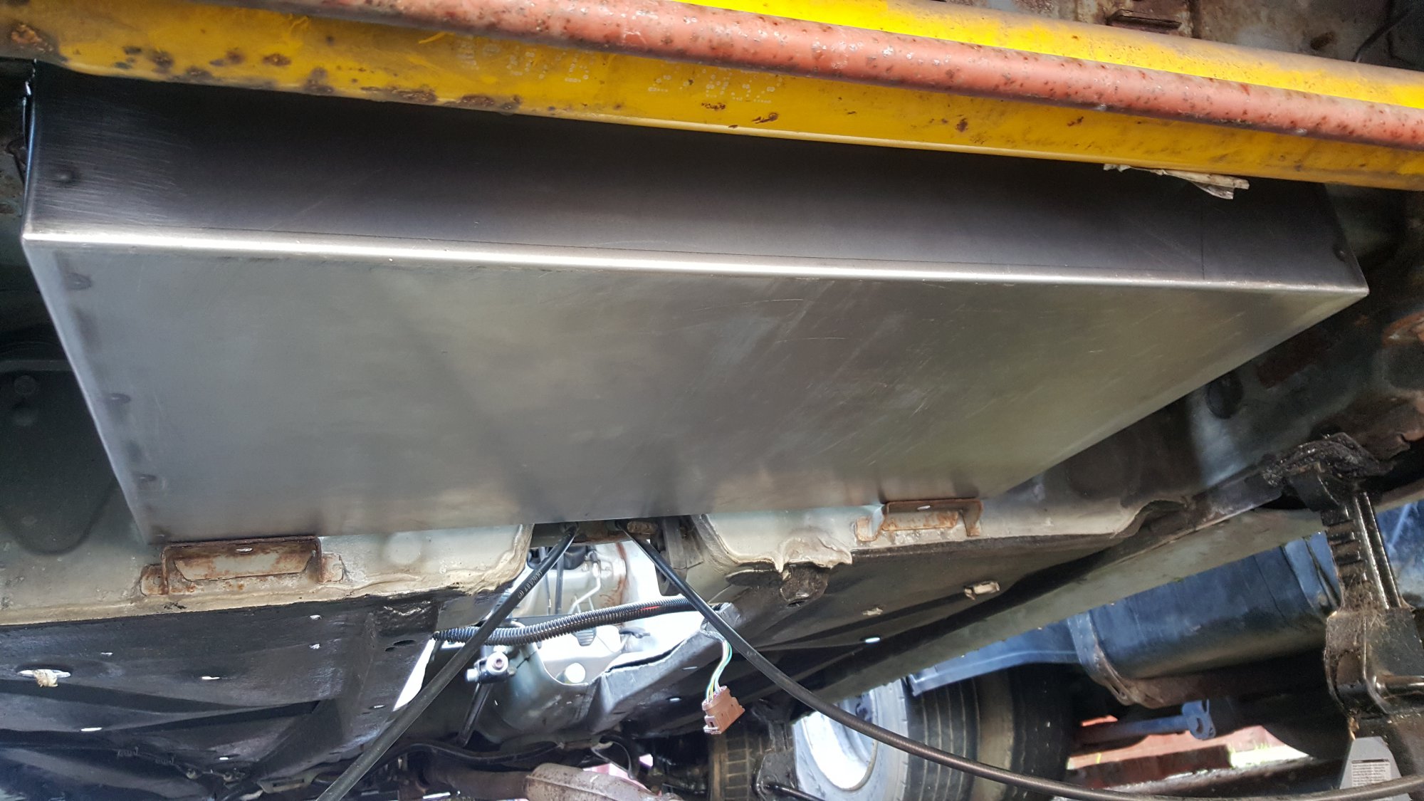

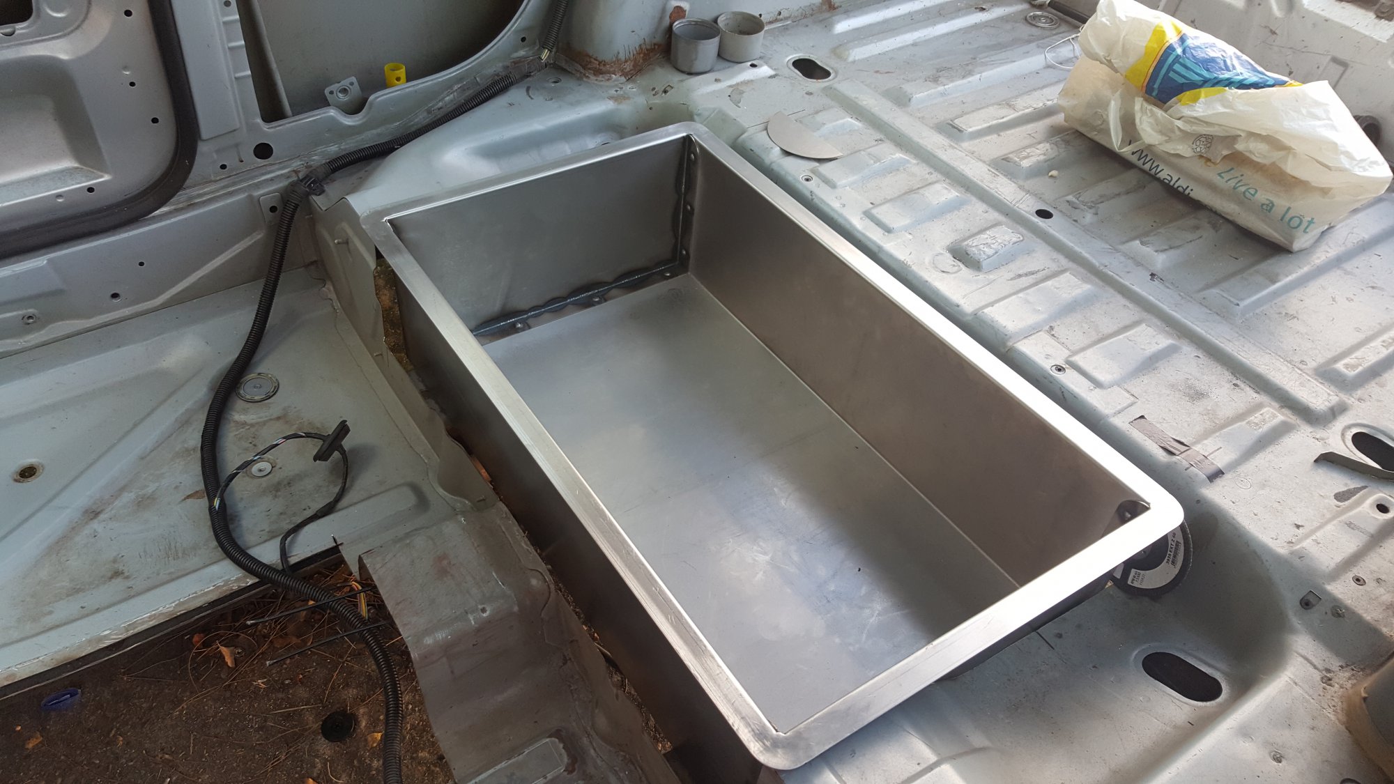

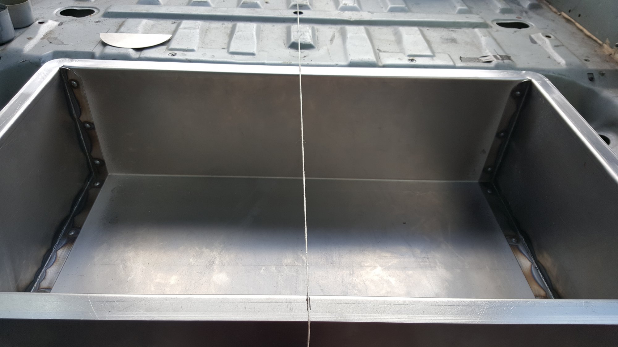

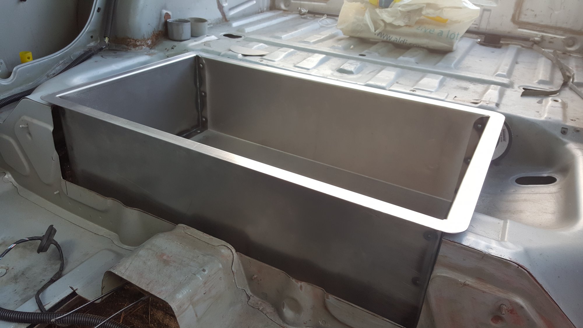

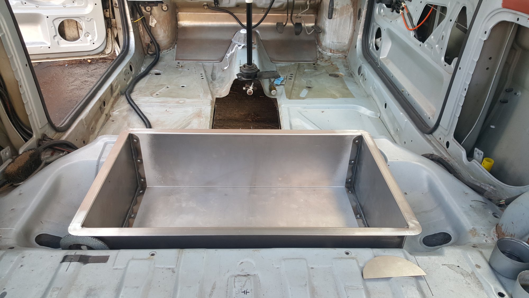

not over happy with finish ??????? can I ask why?I managed to get it sorted of finished and trial fitted.not over happy with the finish.View attachment 104628 View attachment 104629 View attachment 104630 View attachment 104631 View attachment 104632
I had a bit of trouble getting the corners to meet up as there was a 1.5 mm difference due to myself not taking in to consideration of material thickness...if you zoom in to the picture of one of the corners you can see a slightly rough finish...it anoying. ...not over happy with finish ??????? can I ask why?
It's just that I know it's not right...it will eat away at me....but I will try clean it up a bit more with some emery cloth .if thats the worst that happens..understand your frustration though
No fish in there ...just a large aluminium fuel cell.Nice to see a van with a proper wet fish well....nice job.

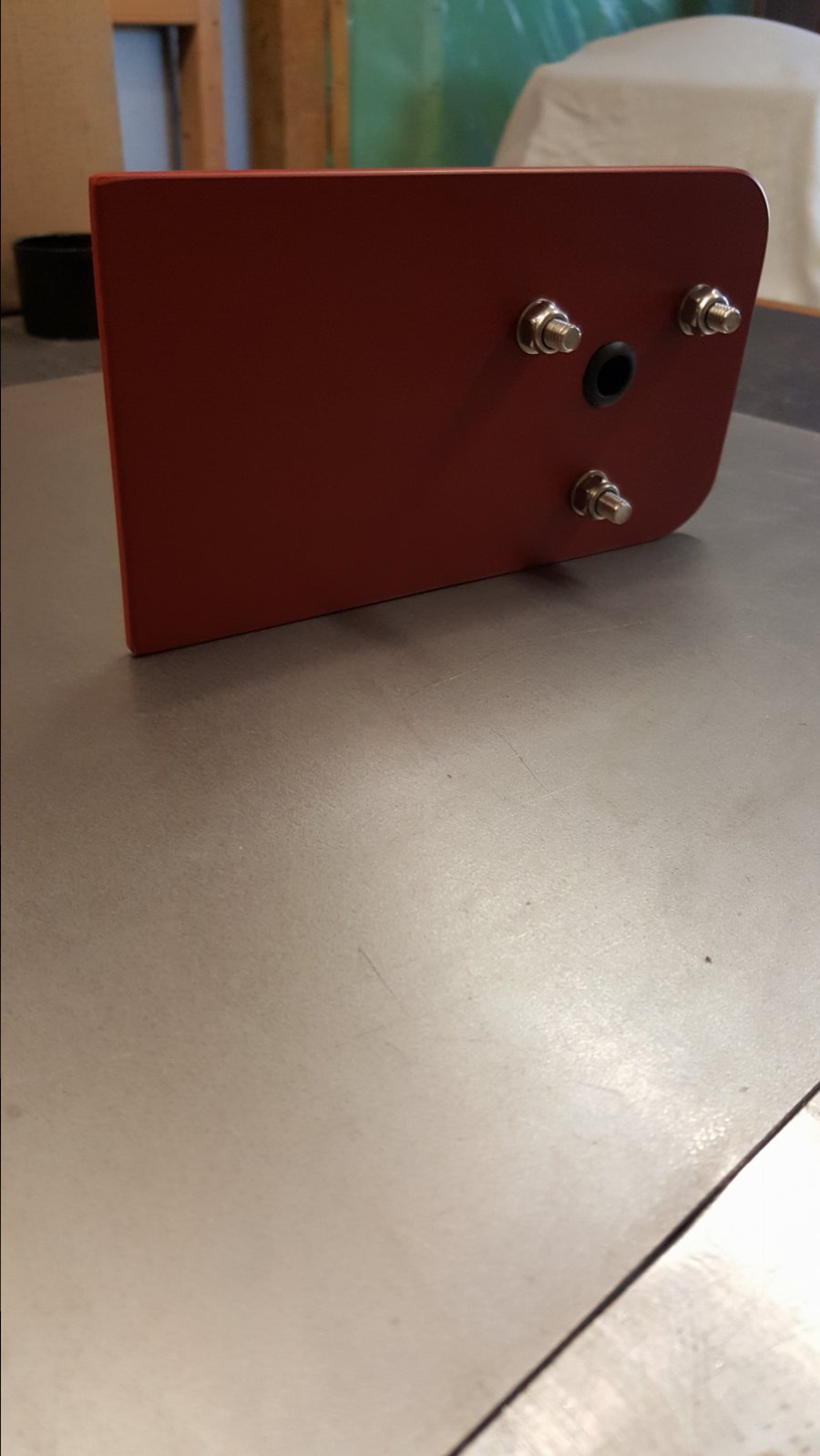

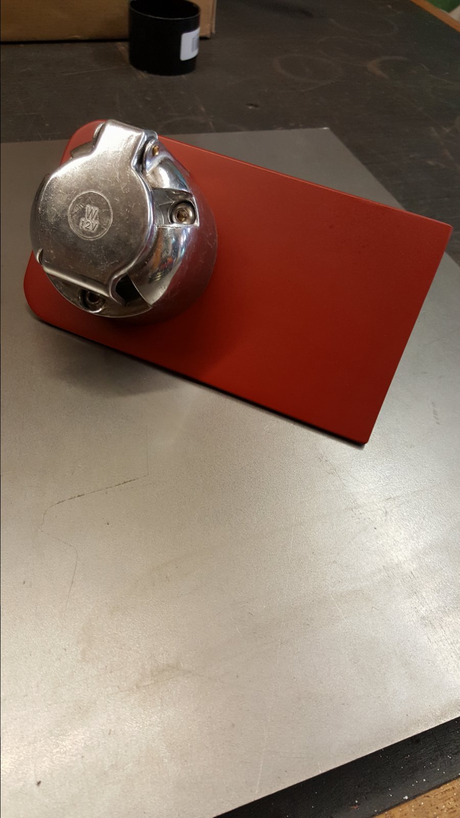

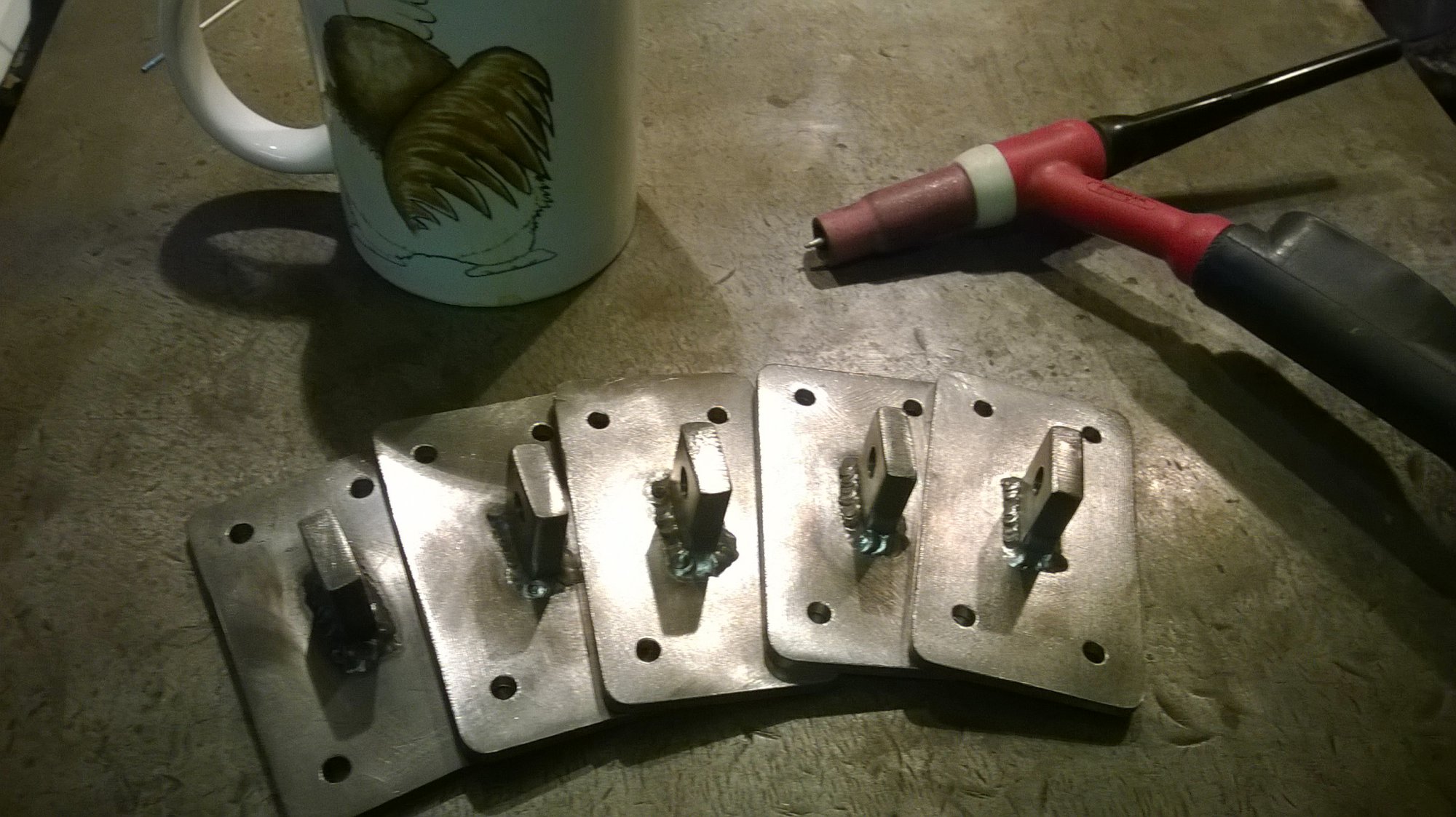

Other than for painting tomorrow, what are the brackets for?Some brackets. Ready for paint tomorrow.
Holding up some 25mm conduit and SWA back to back. I'll try to remember to grab a shot tomorrow.Other than for painting tomorrow, what are the brackets for?

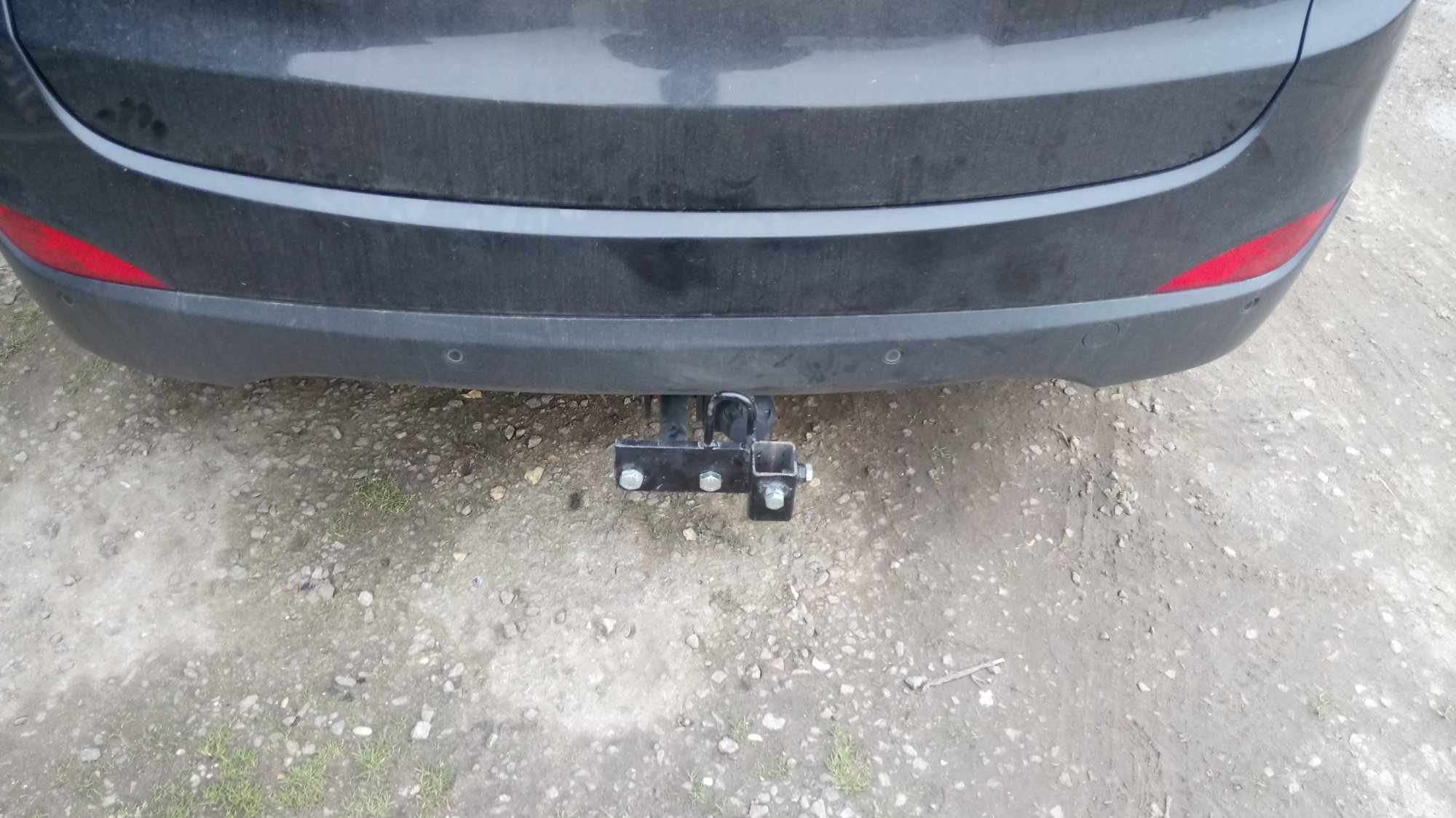

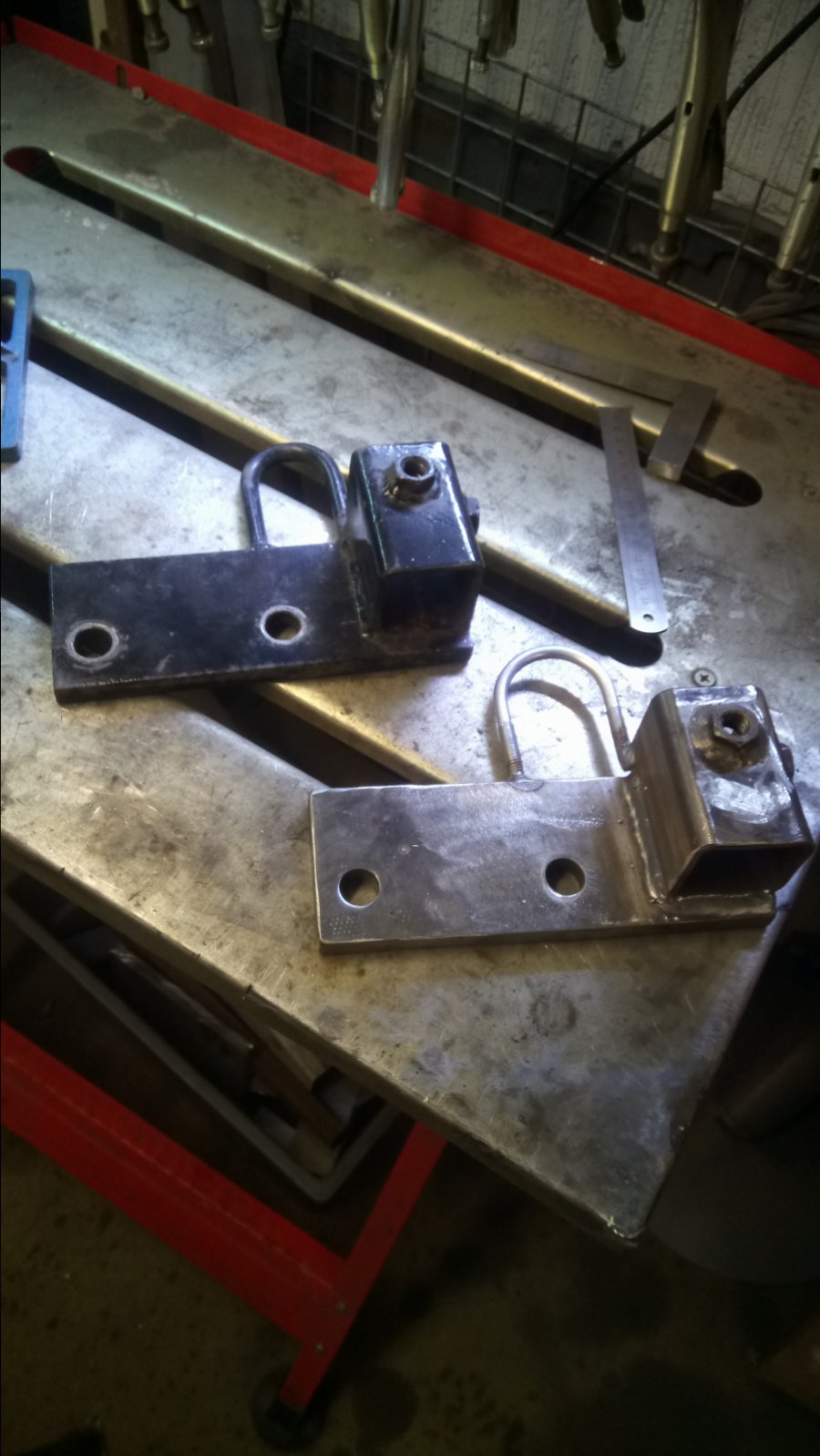

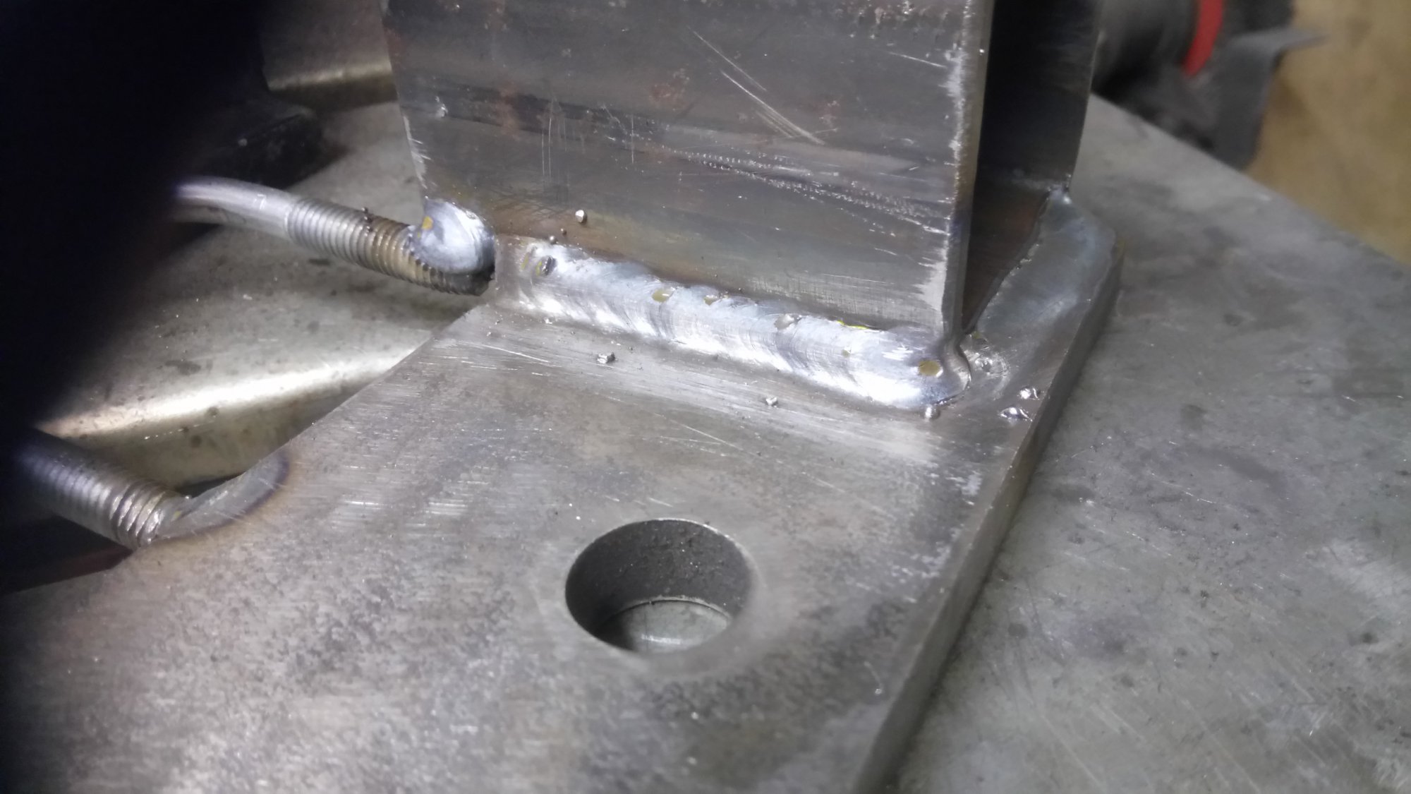

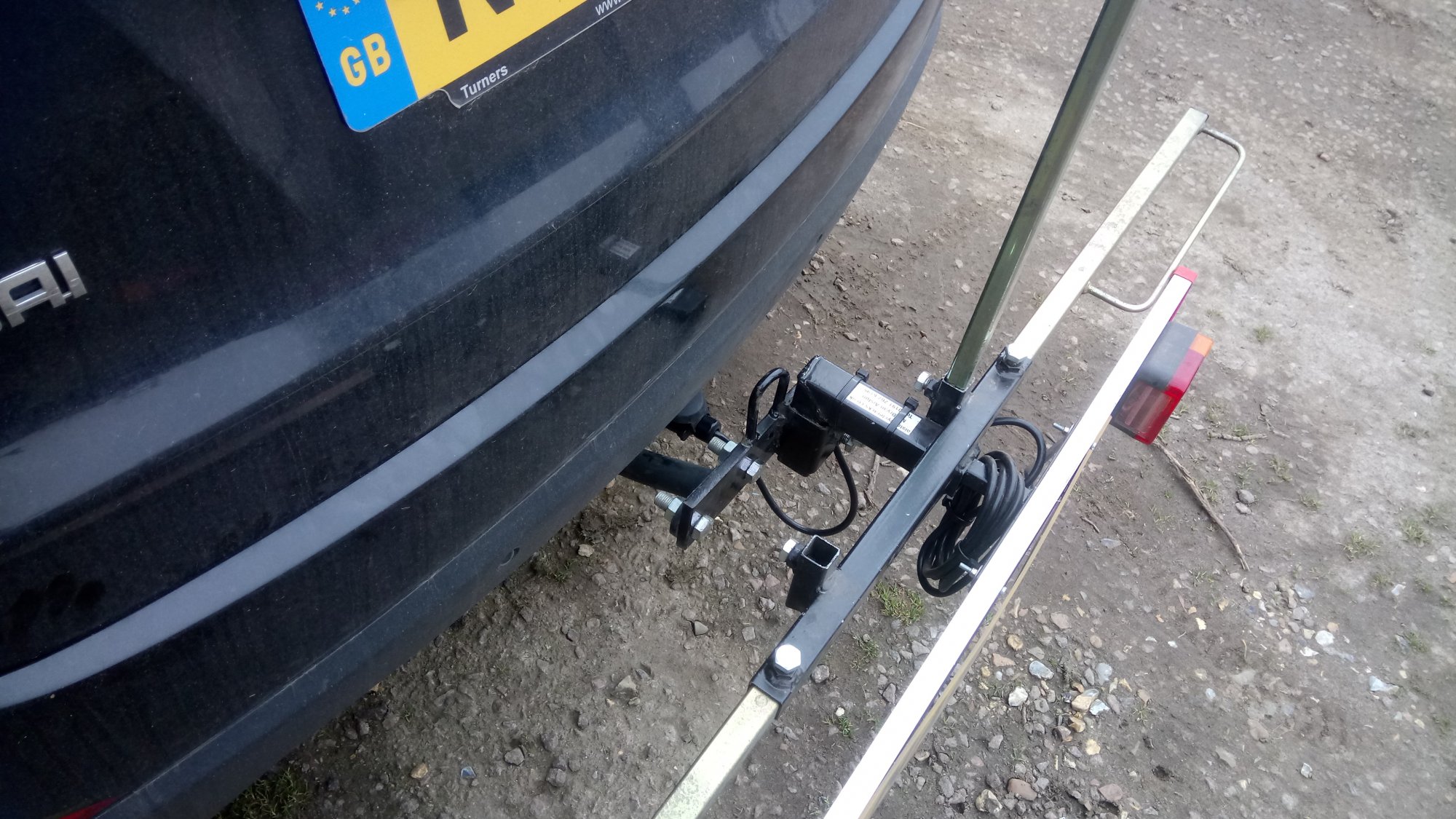

.View attachment 104637 View attachment 104635 made another bicycle rack towbar mount, would like to fit my bike rack on my other car but don't want to keep swapping this mount over, plate is 12mm with 4mm wall box, welds not as nice is i wished
