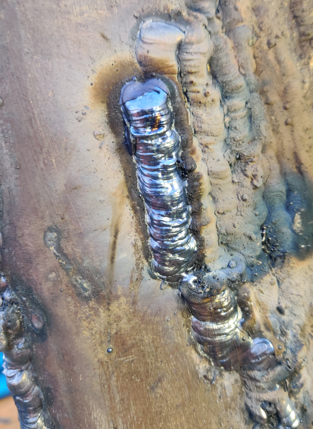

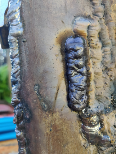

Starting to get a better hang of uphill vertical stick welding , 2.5mm 6013 rods running about 80A I think just on my rather thick test box section I practise on.
I realised as I take on bigger projects I cant easily move the work around to make a easy flat weld so teaching myself more positions
Slag was very easy to remove , just a swipe with glove and comes off all in one
Compared to the pro's on here might be a bit low quality but I'm really pleased with it compared to the porosity ridden bird dirt I first did vertical
