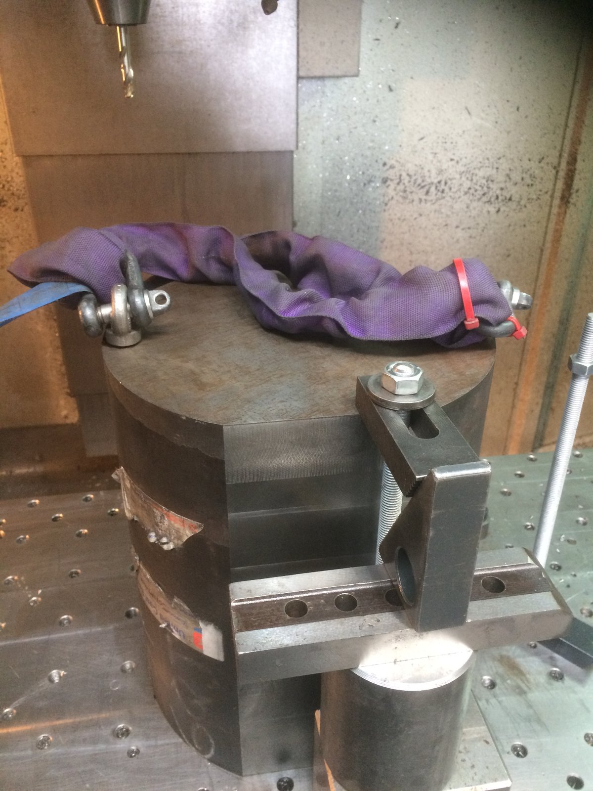

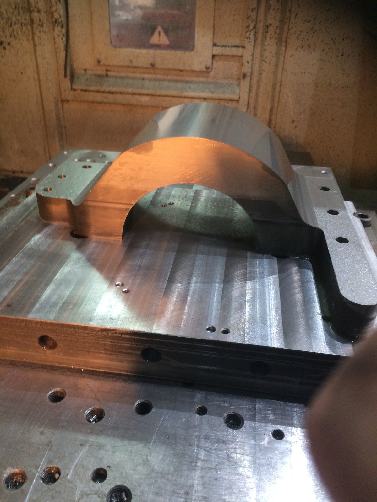

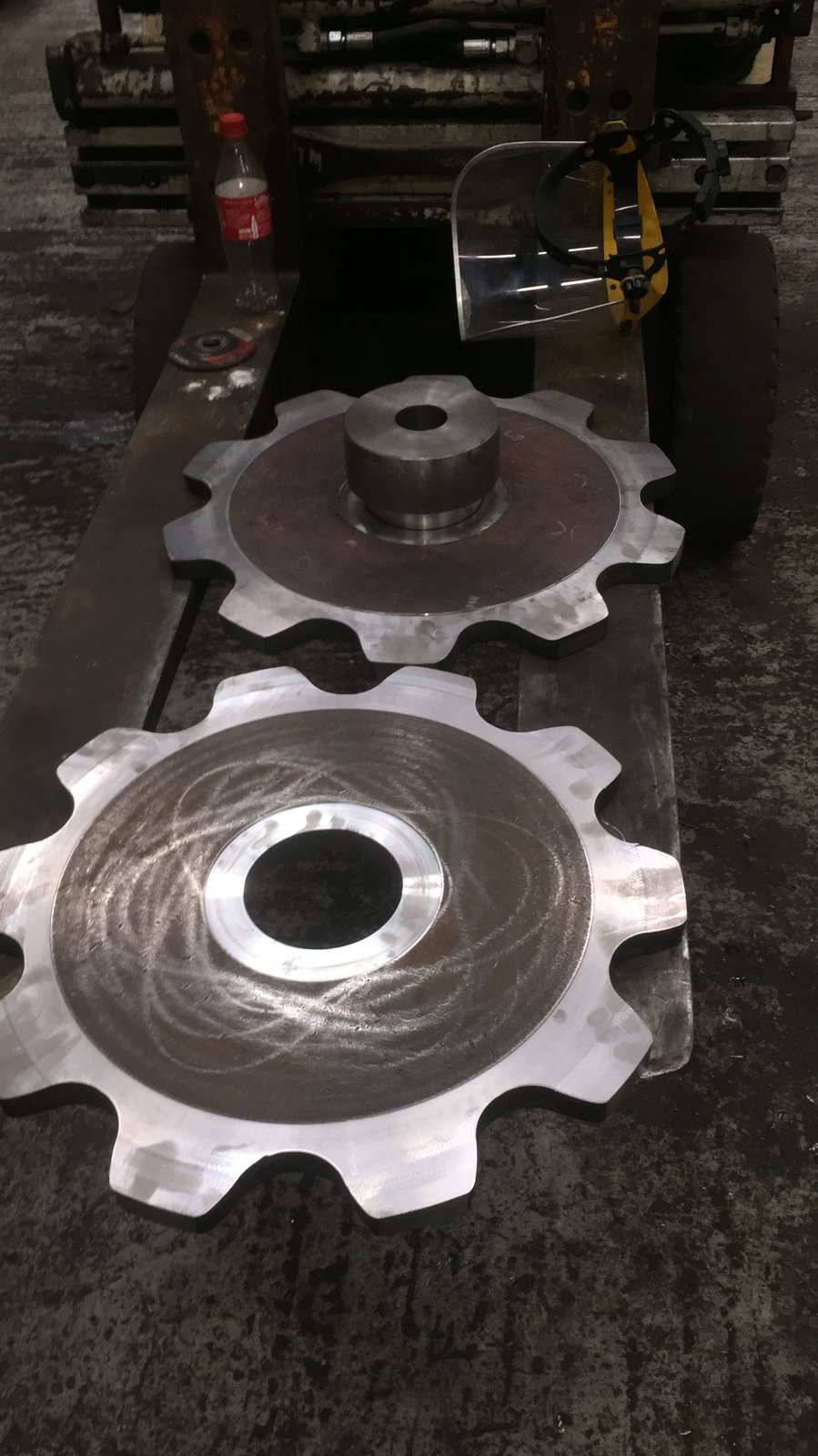

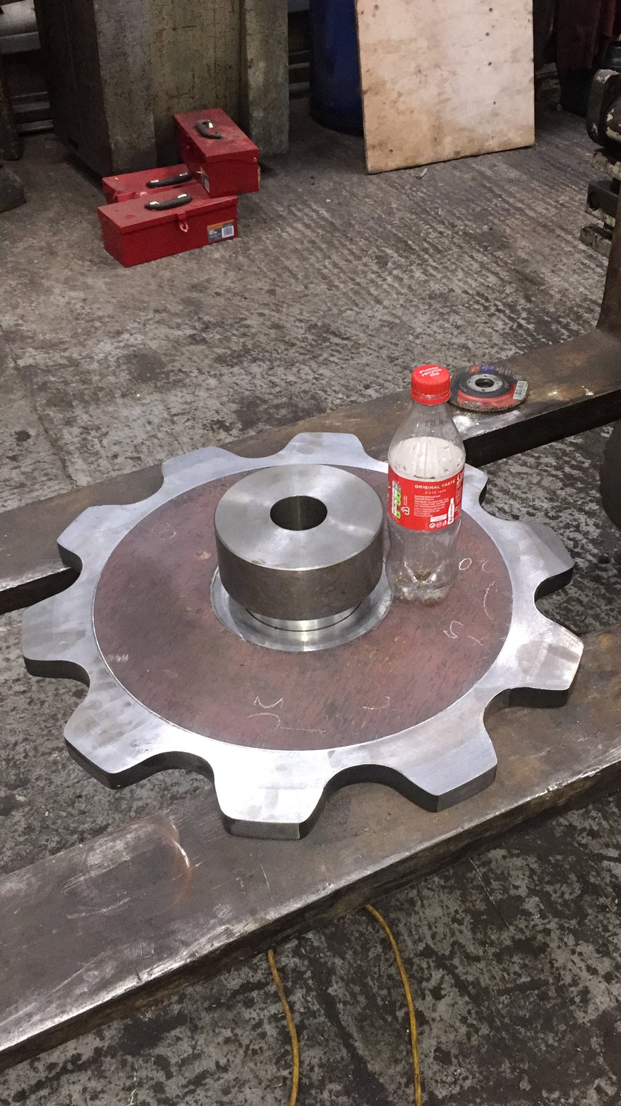

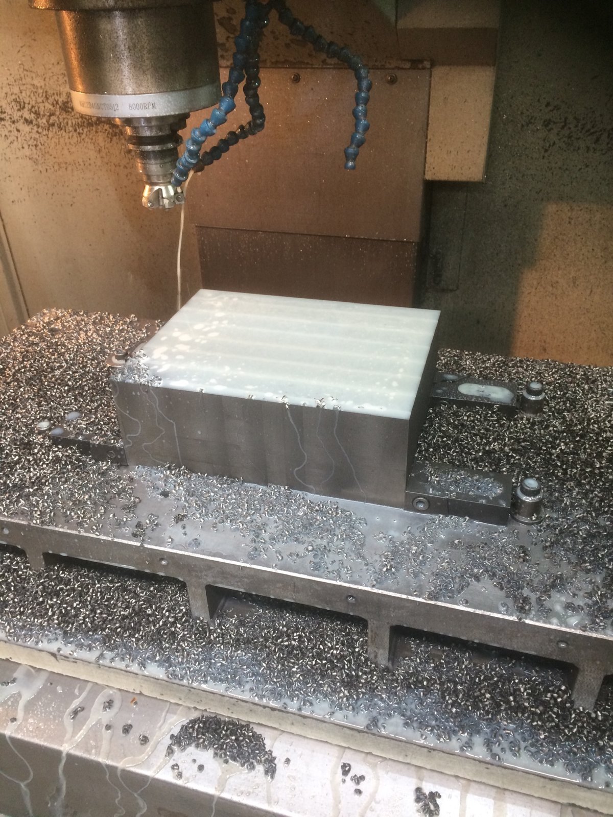

130kg round billet was the starting point. Bizarre to think I will be able to pick up the finished part with two fingers....That round billet was the smallest billet it would come out of

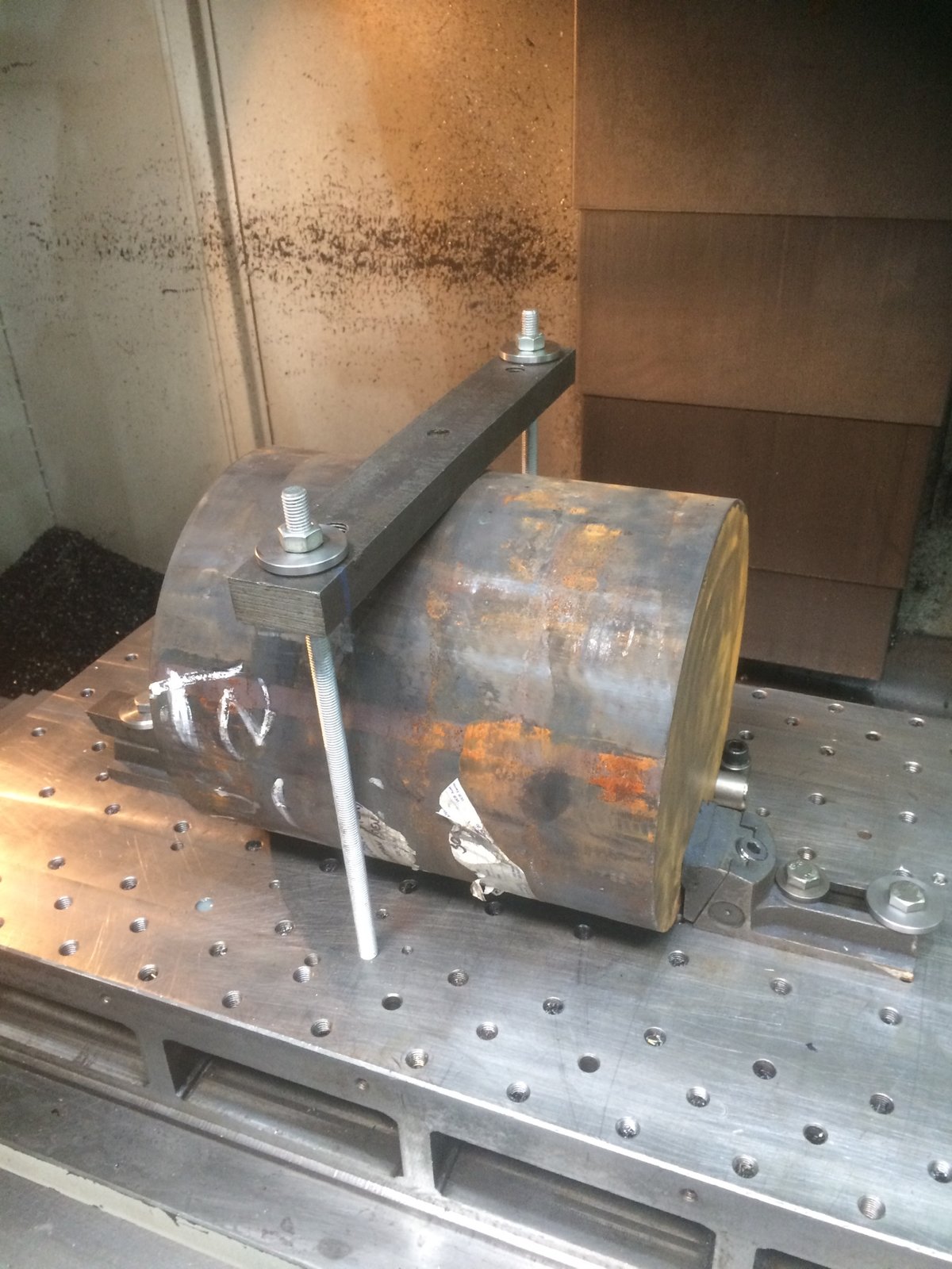

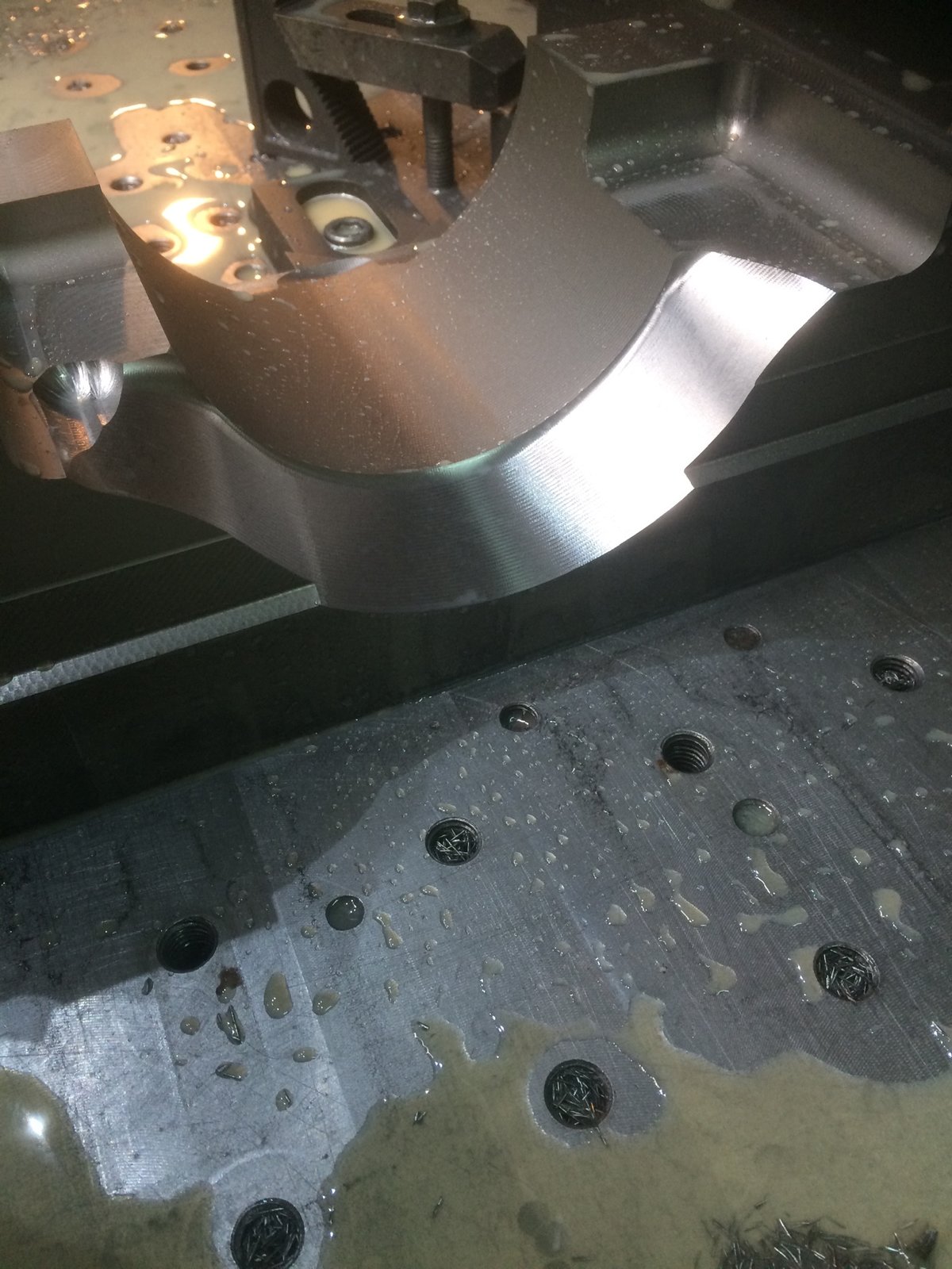

View attachment 190243 View attachment 190244 View attachment 190245 View attachment 190246 Got a big lump of spuncast to whittle down...
Unfortunately photos don’t appear in order. 130kg round billet was the starting point. Bizarre to think I will be able to pick up the finished part with two fingers....That round billet was the smallest billet it would come out of

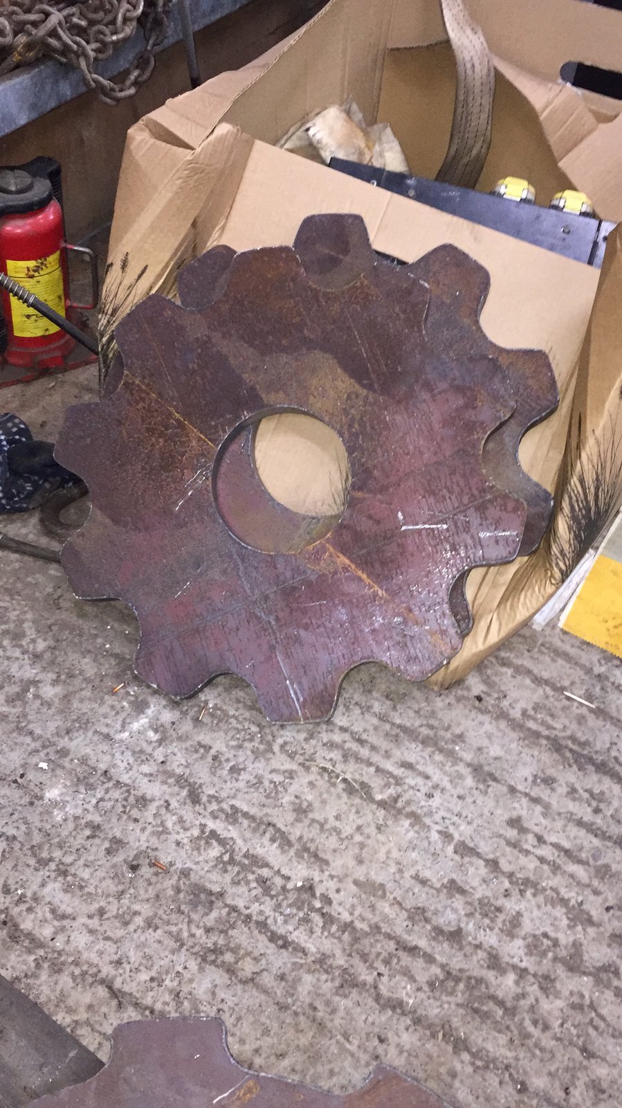

It’s spuncast cast iron. Bought from United Cast Bar. Big lumps of steel I normally buy from Parkside steel.
Machines nice. Wouldn’t say easy. Quite abrasive to tooling, but that’s probably more to do with the rate I am removing it. Haven’t got time to go slowIs it nice and easy to machine?
I hope so too....I hope we're going to see the end product.
Continuous Cast if it’s from United castingNope. It’s spuncast. So it’s round to start off with. That’s the smallest lump it would come out of.

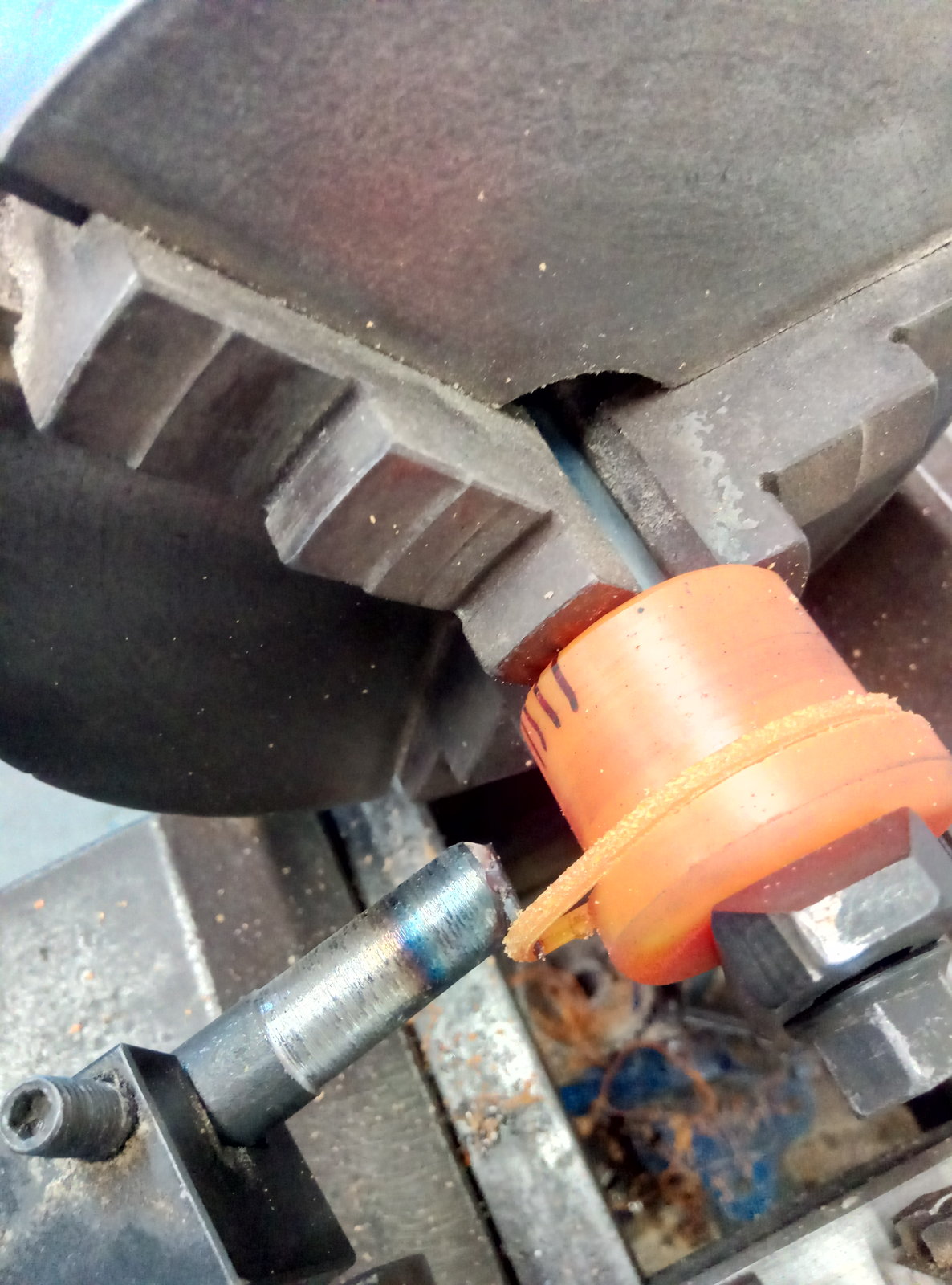

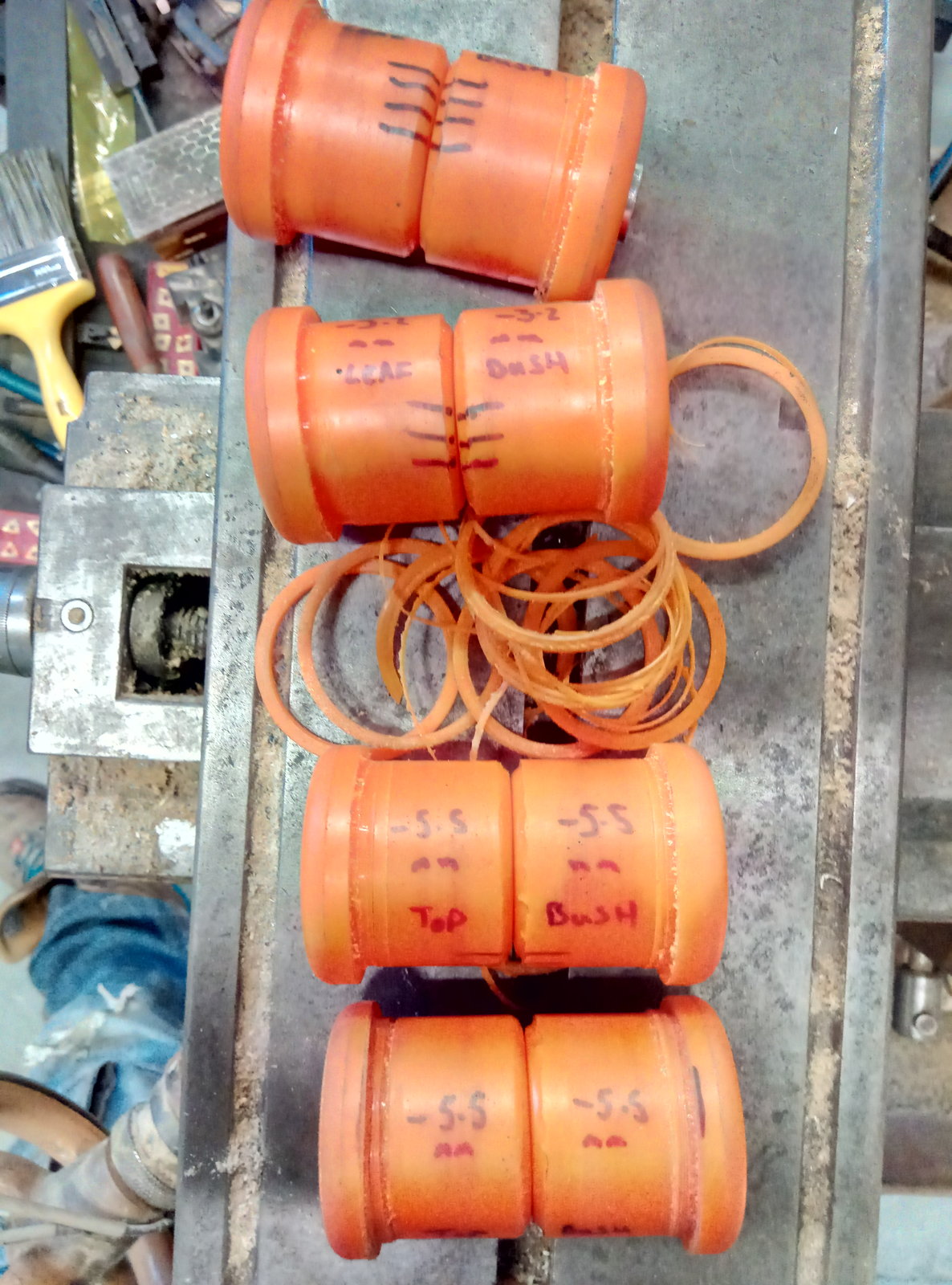

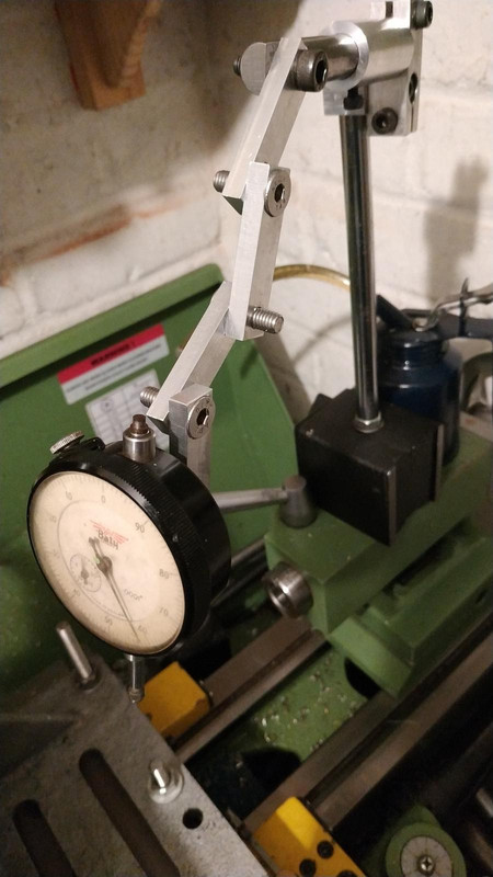

4 adjustable links for the dial guage. I did radius the ends after I got the pic and it took bloody ages!

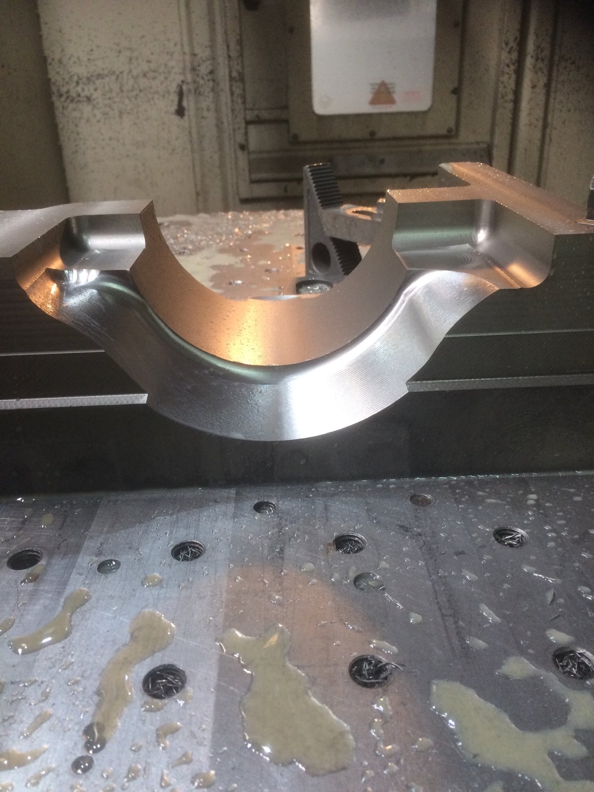

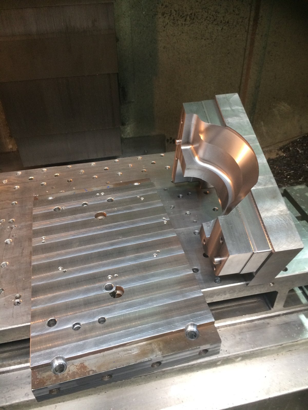

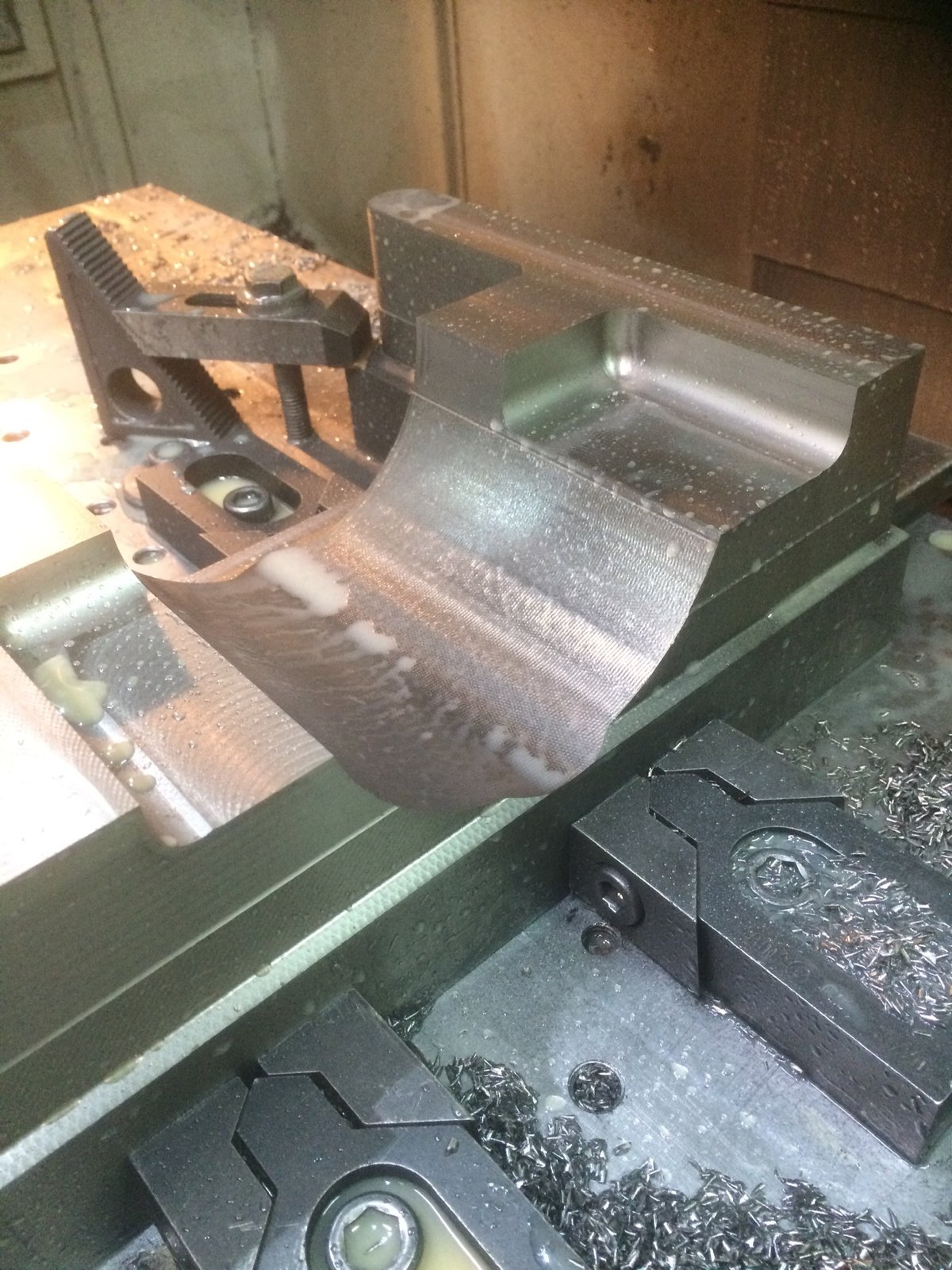

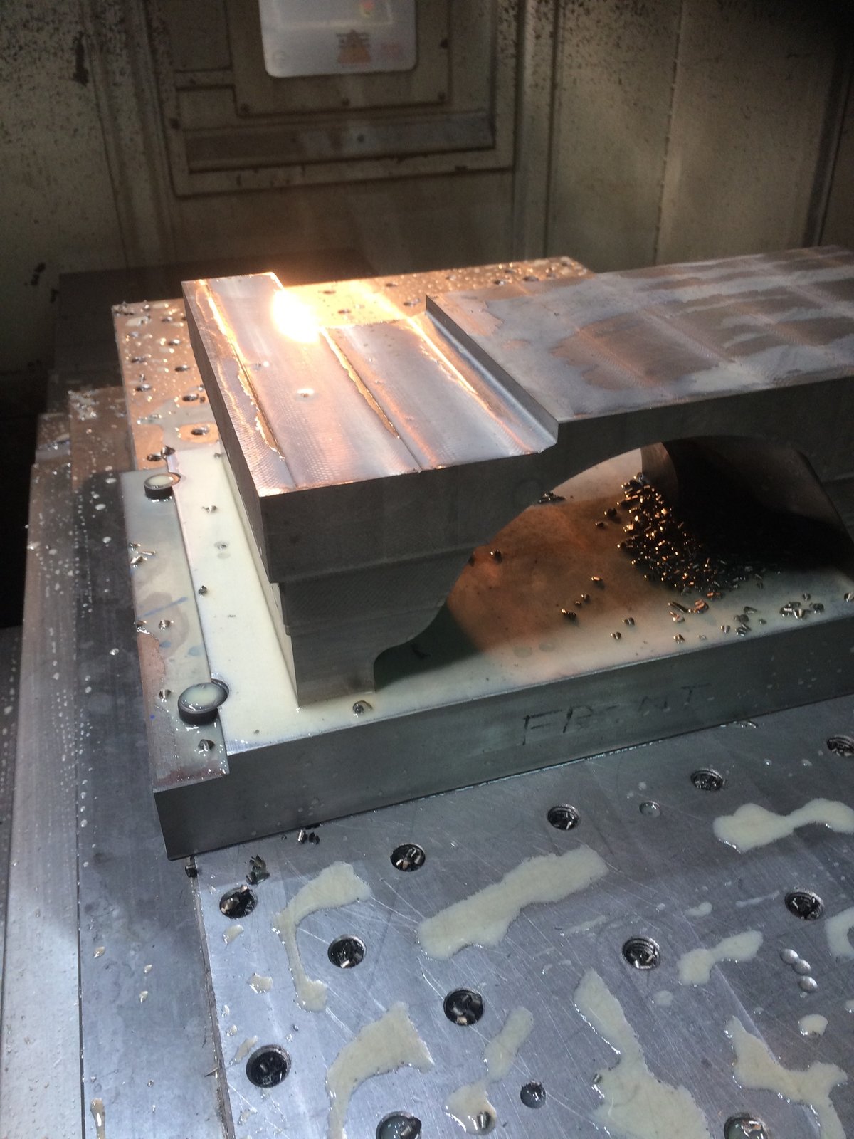

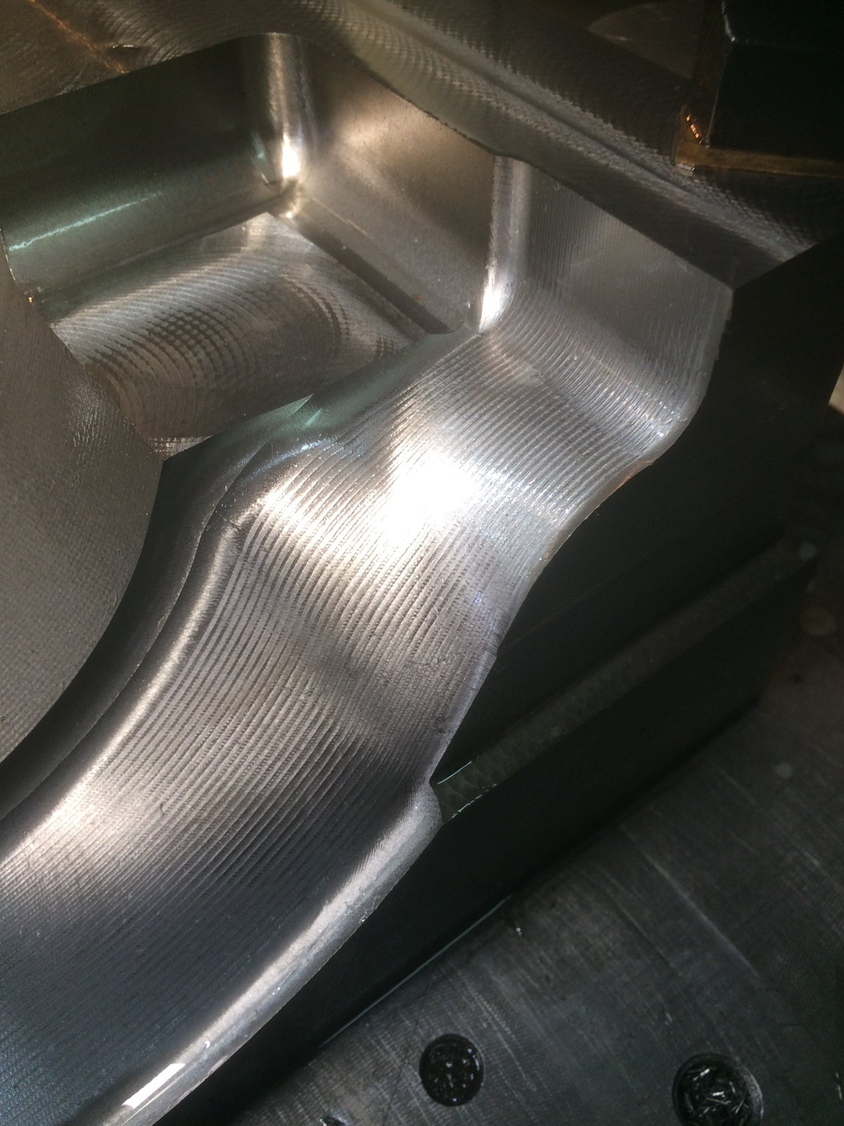

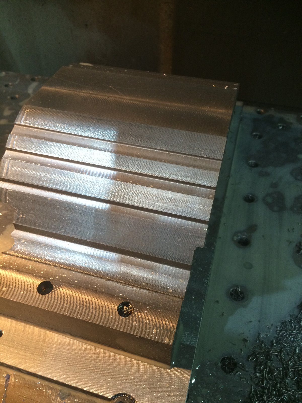

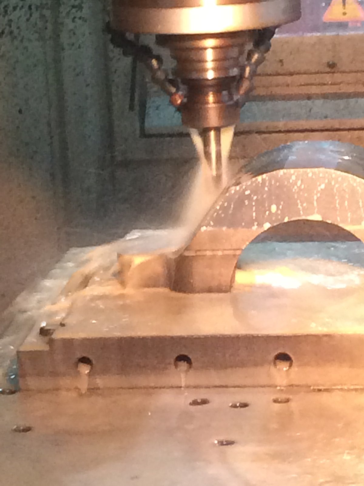

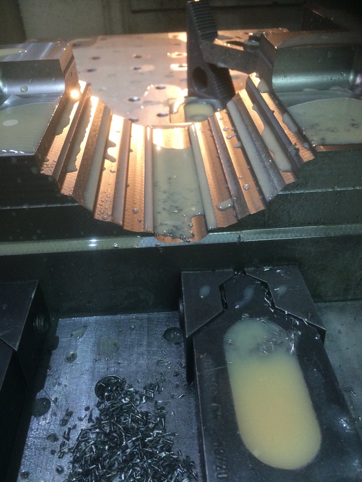

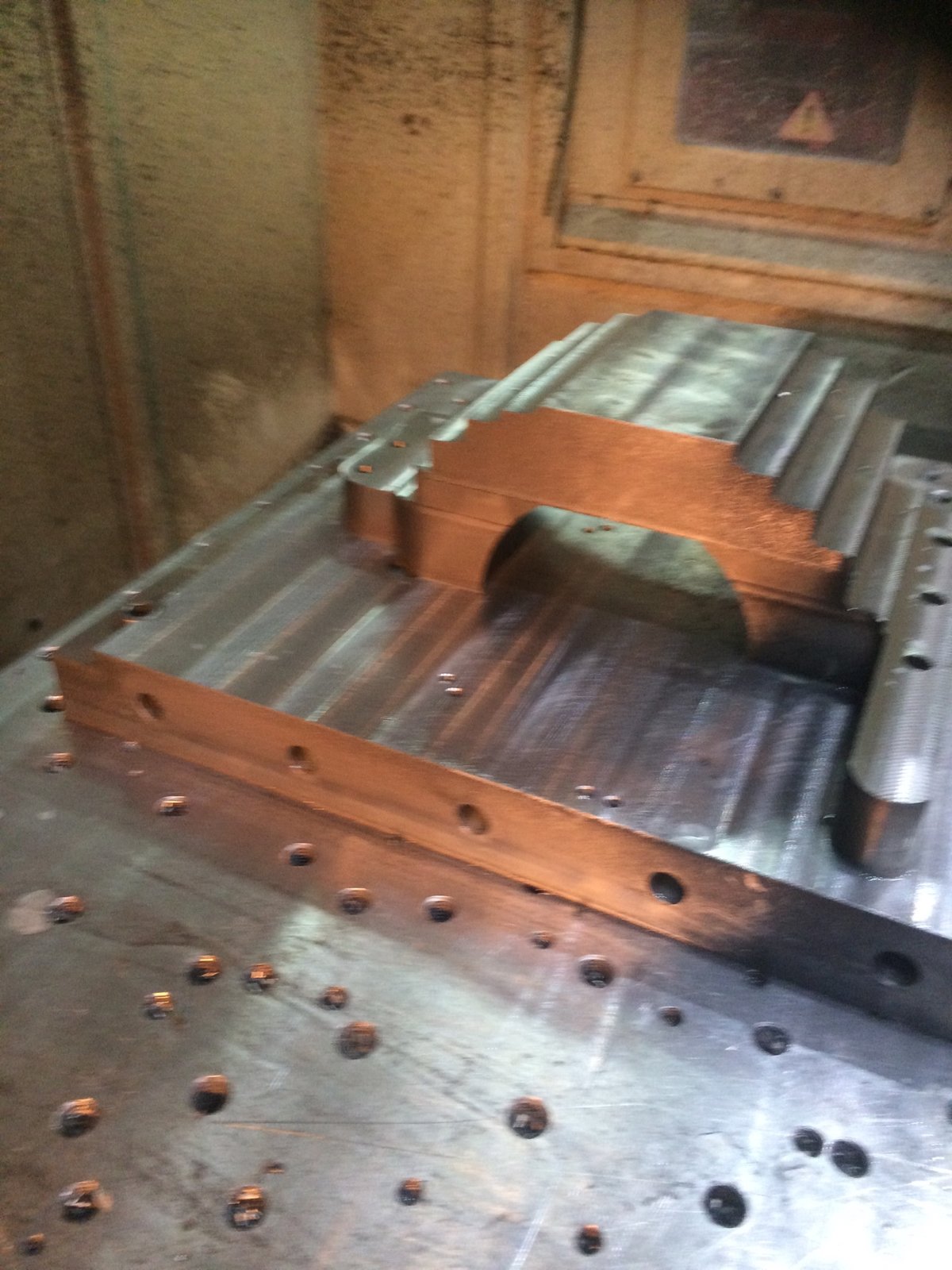

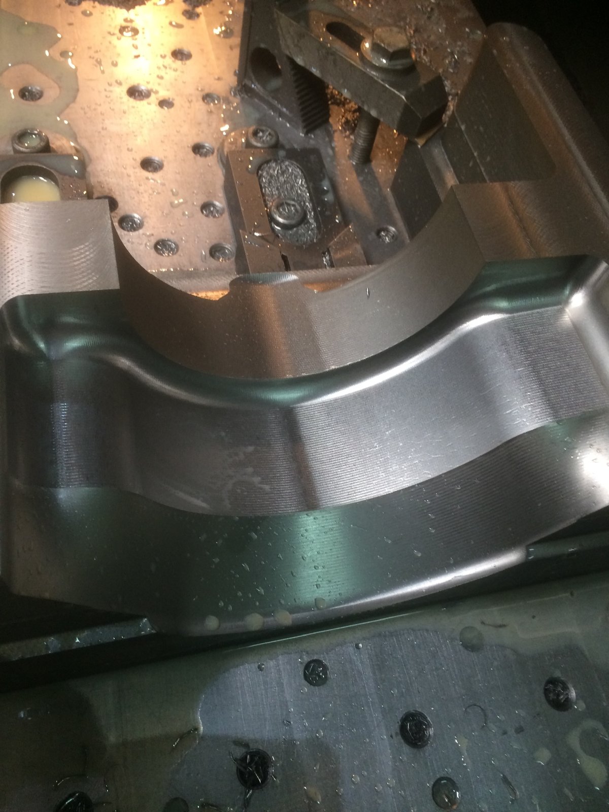

Still going at 2 in the morning?View attachment 191755 View attachment 191756 View attachment 191757 View attachment 191758 View attachment 191759 View attachment 191760 On the lower side now. Getting there slowly...
Yep. Just going home now...Program should run through until about 6am. Got deadlines to meet...Still going at 2 in the morning?
